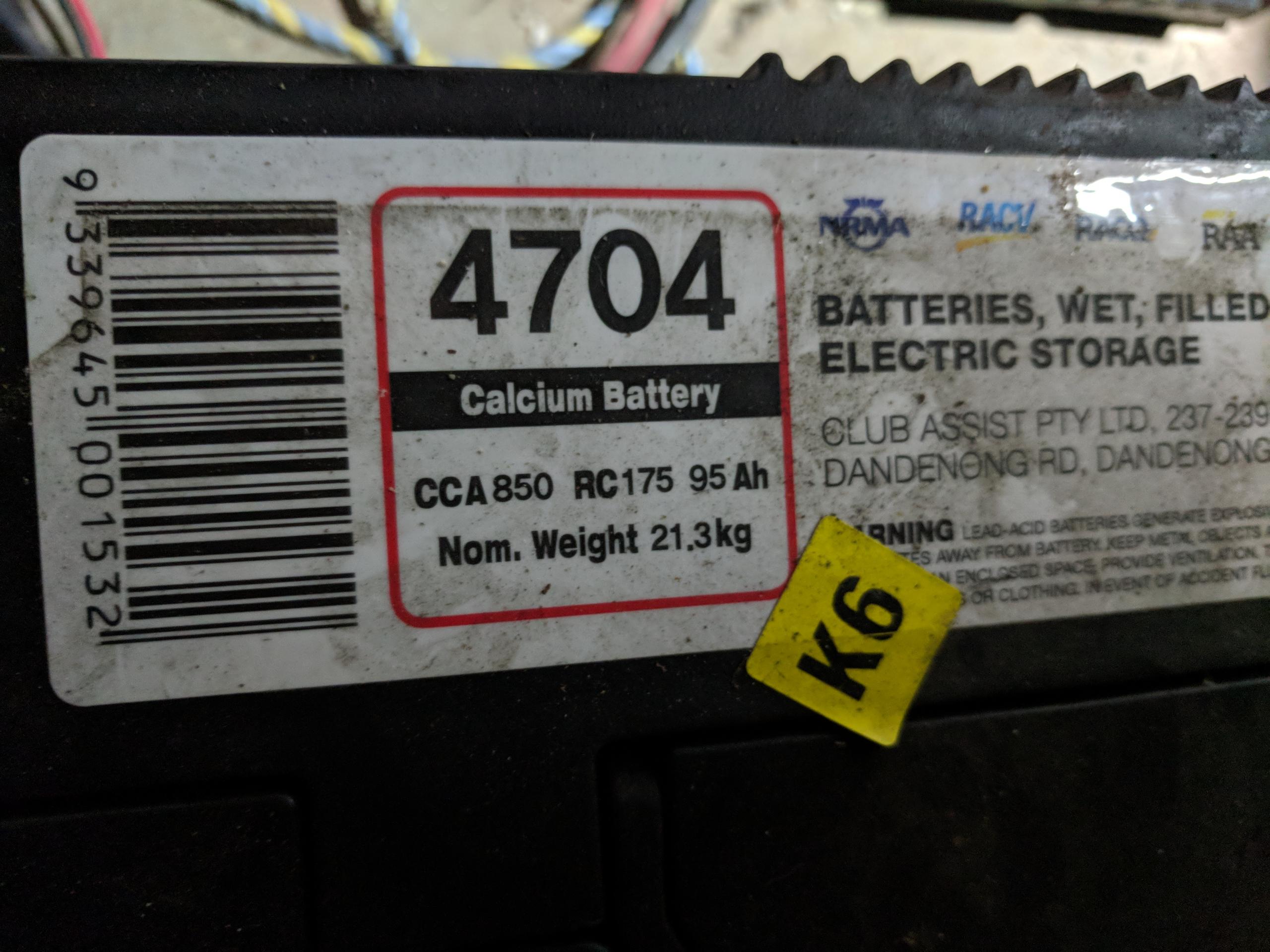

I knew the battery wasn't too old, and I wasn't willing to accept it was stuffed. It was a Calcium battery, so I did a little googling and found that Calcium batteries can sulphate a little as they discharge and when they go completely flat they can be difficult to bring back to life.

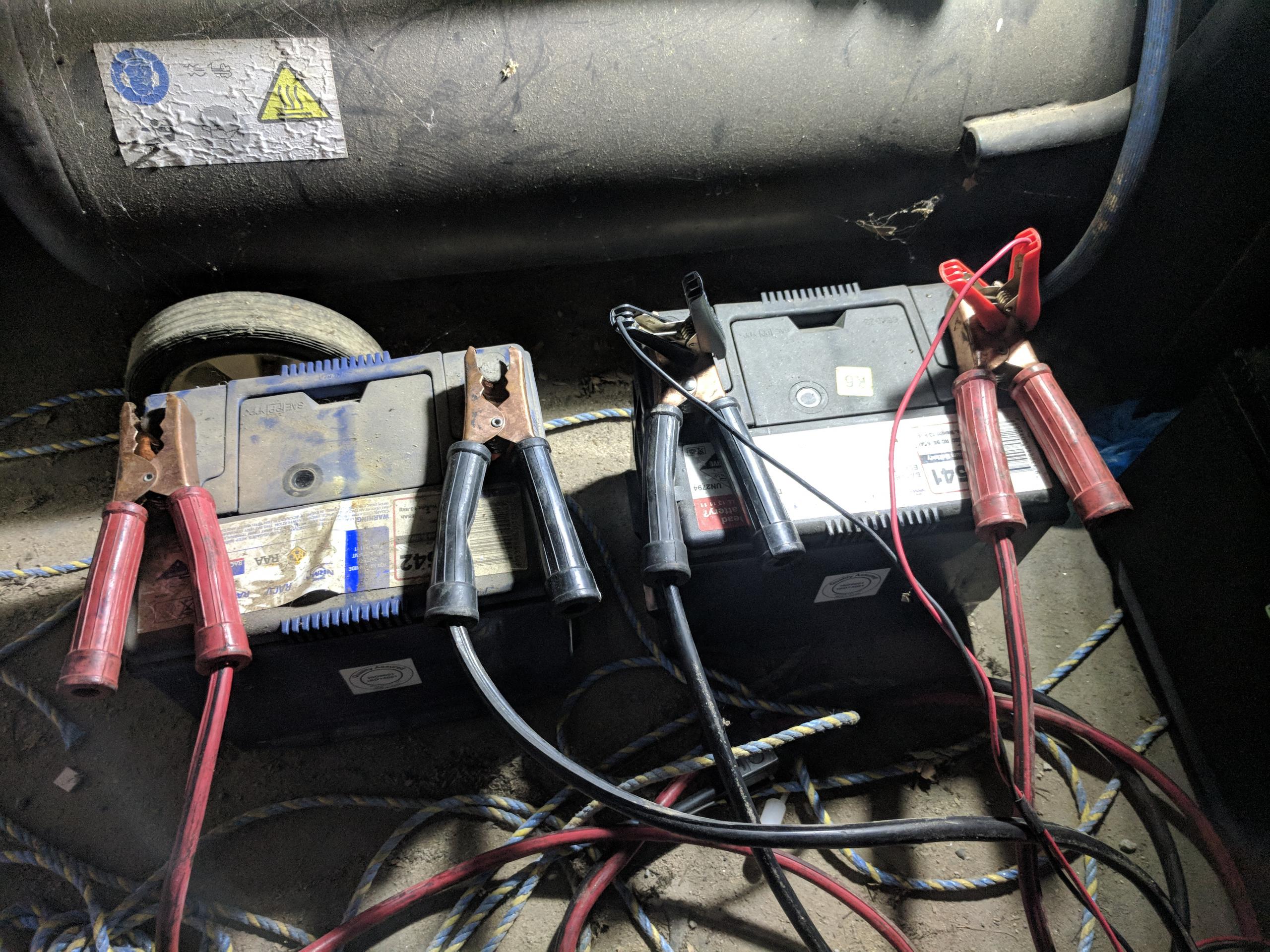

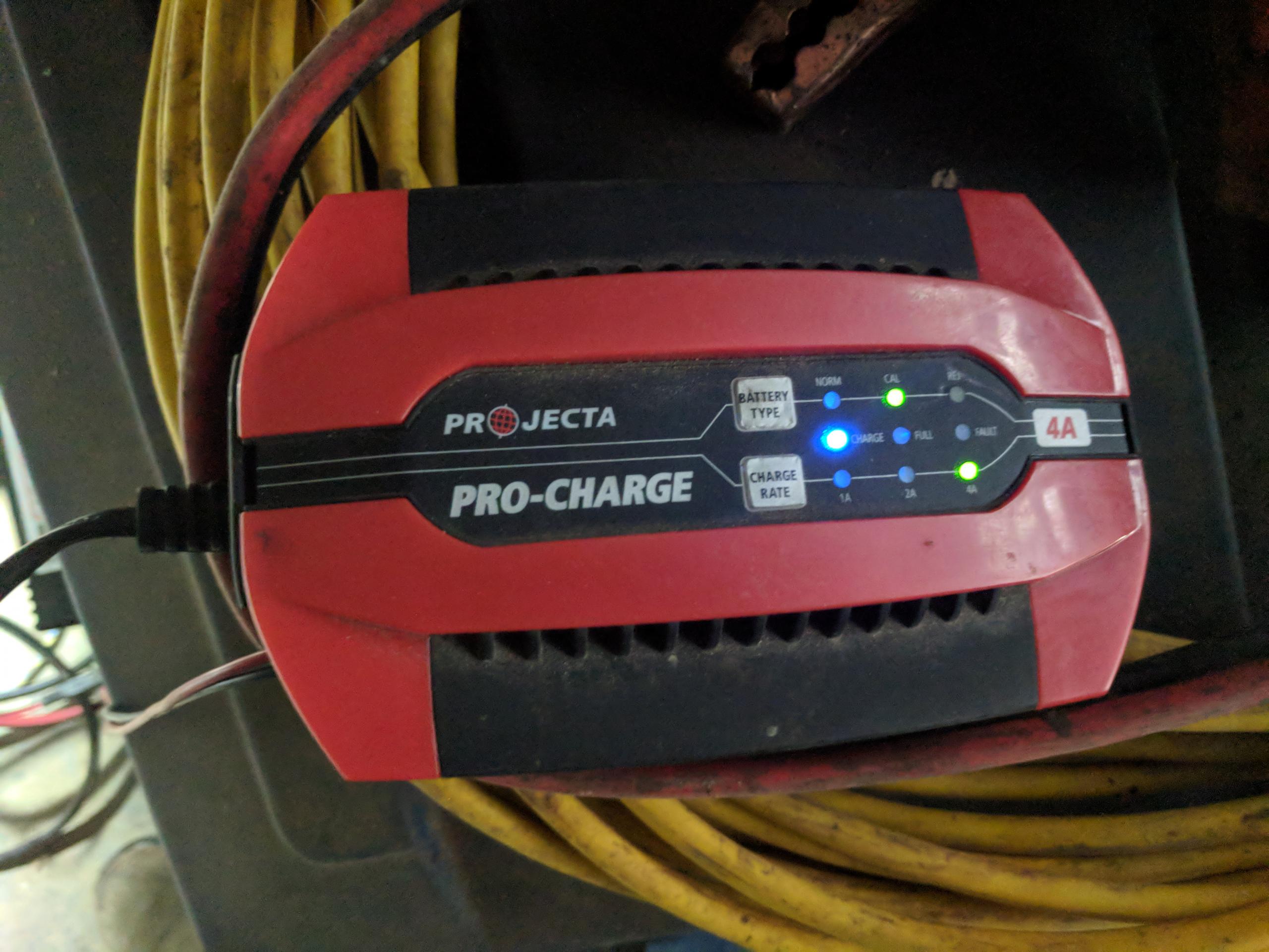

So connect it up to my half dead old S8 battery with jumper leads to provide a 12V constant feed, then chuck the smart charger on top of that and it begins the charge cycle. I leave it there for two hours, then disconnect the jumper leads from the base load battery. The charger continues on charge, so I immediately put it on to a rejuvenation charge to aid the desulphation and leave it for about a day and a half (rejuvenation cycle takes 24 hours, then automatically goes through the charge cycle).
When I come back at the end, all the lights were green and the charger says it's fully charged.
The batteries in the other two cars are much the same, and also Calcium batteries, so I do a little test on the recharged one by making it the base load of the jumper cable part of charging the other two.
