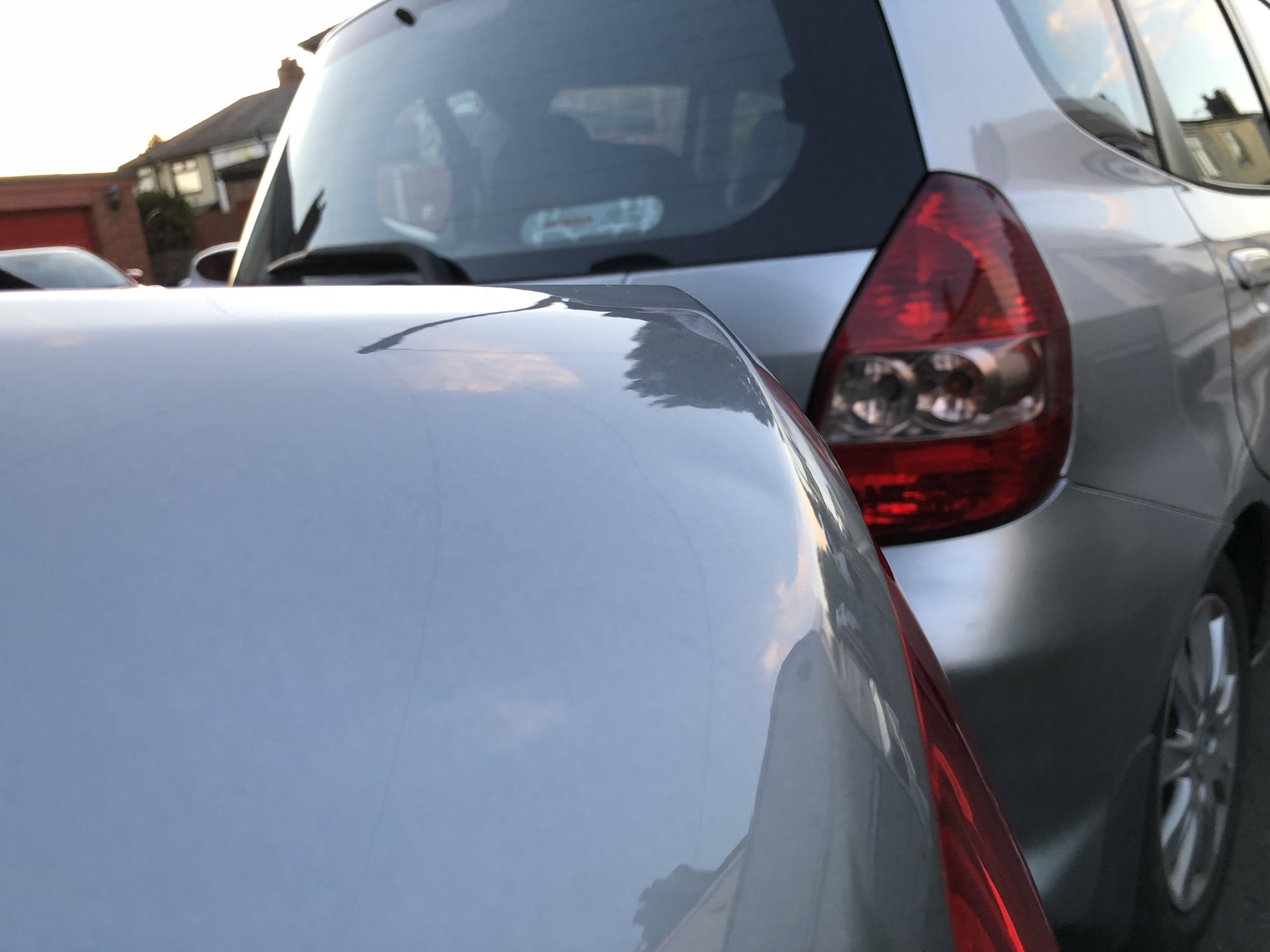

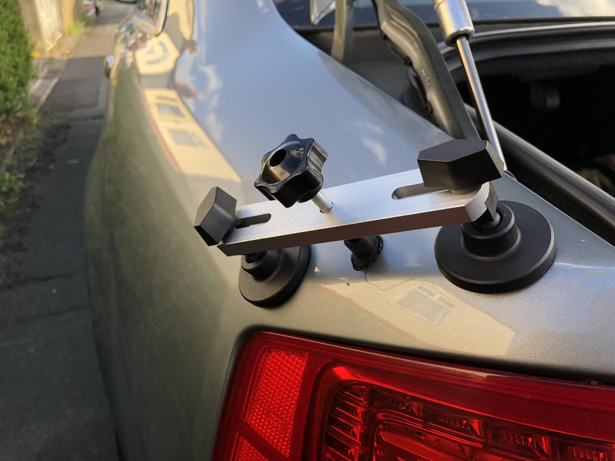

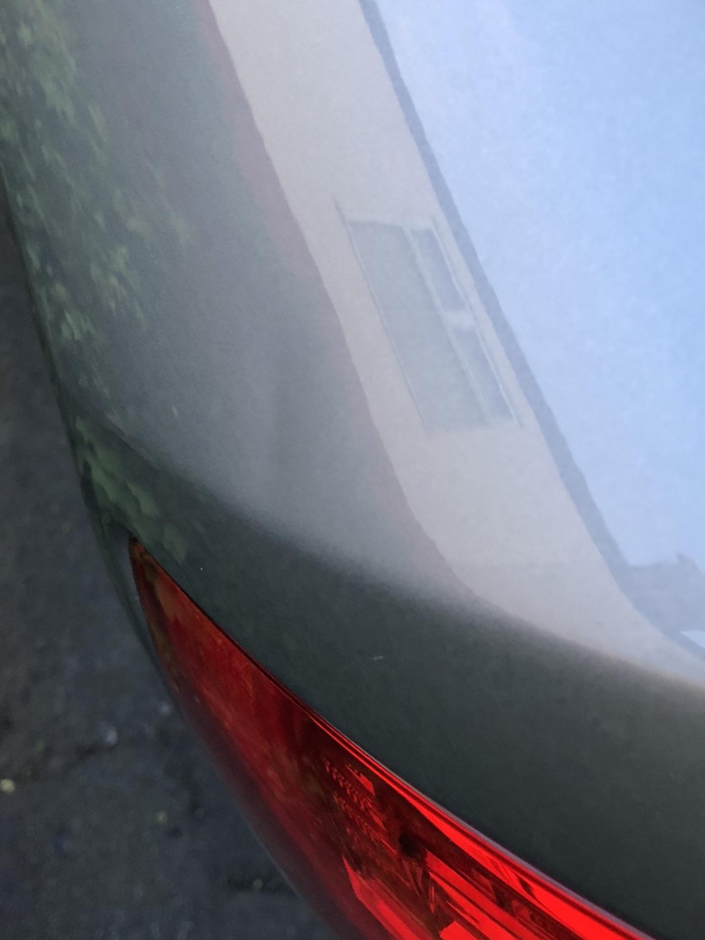

Anyone had the misfortune, sorry, patience to give it a go? I tried for the first time with a hot glue gun based kit. I knew it would be tricky, the body being aluminium and the dent (that’s been annoying me since I bought the car) being near the crease.
Anyway, 2 hours of my life kissed goodbye to and I’ve improved the dent, but it’s still there.
Does anyone have any tips? I haven’t used my pull hammer, having read it doesn’t work so well with aluminium.
Here’s some before, during and after shots.

I had a go at removing one or two small dents myself once with a similar tool. I don't think it's possible with aluminium because, unlike steel, it tends to stretch. So you can't just 'pop it back'.
You need to find a dent removal specialist, in particular one who is skilled and confident in removing dents from aluminium. When I phoned around I found that most either wouldn't touch aluminium or would "have a go". Eventually I found one guy who specialised in aluminium dent removal. He worked behind the panels and managed to completely remove a couple small dents I had. I think he only charged something like £50-£100 per dent.
Old 1st May 2018, 05:55 AM
Posts: 3,668
I agree with Mark's comments - Aluminium is harder to treat for dents than steel, and needs a specialist, so I wouldn't try DIY on my aluminium-bodied cars.
