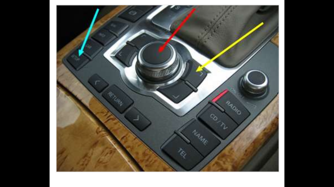

Try rebooting the MMI, Press SETUP, Main Controller and top right button together as per the photo.
Make sure you press them simultaneously. The MMI screen will go black/blank, then show the MMI four rings logo and return to the menu.
