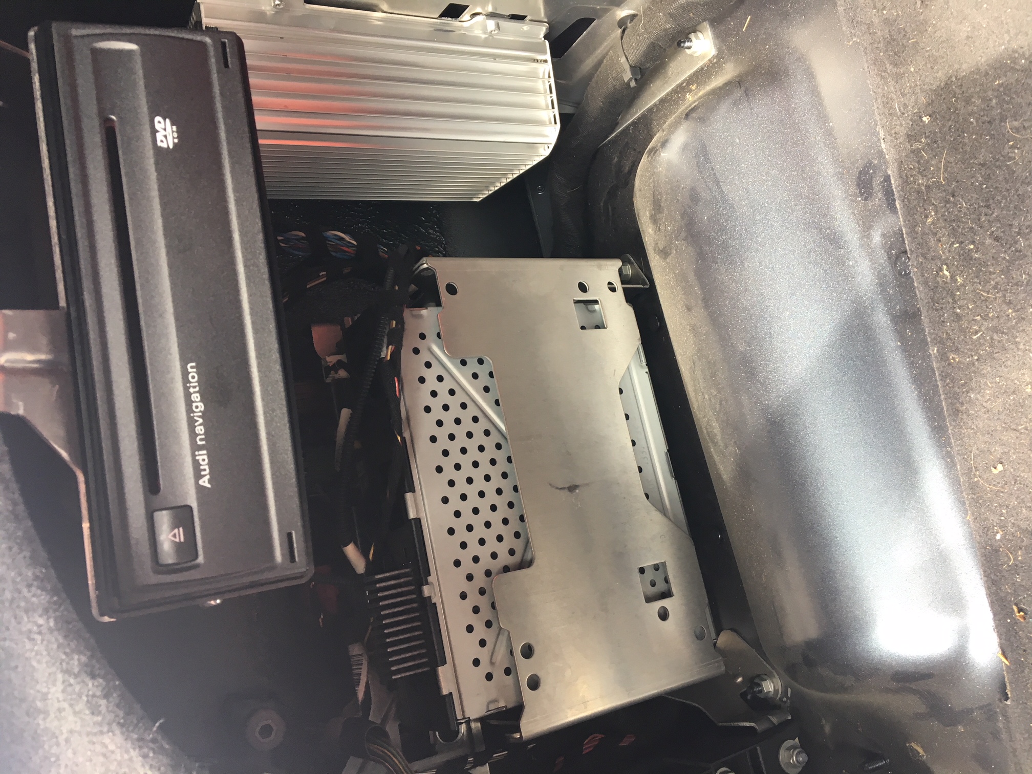

Reading with great interest the threads here. Unfort. I don't have a USB port in my glovebox and on reading here about analogue to digital TV upgrades, i had a snoop around the boot. Here's what i have but tbh, i dont have the foggiest what it is.....
If i'd one wish list, is to have a bluetooth connection in the car, so i can stream likes of Spotify etc to the car...

Kufatec Fiscon Pro might be an option particularly if you need a Bluetooth phone setup anyway. I had one fitted to a 2004 D3 and if was a great piece of kit. Streaming is via A2DP and displays as a 2nd CD changer on the mmi.
If you already have a factory Bluetooth phone module, you might be better off with fitting AMI and some form of adapter to get spotify to stream on it.
Somebody that has AMI might be able to advise better on this.
Either option could be in the region of €400+

That picture isn’t too useful, all I can see is the FM tuner and the DVD Navi.
If you have TV it will be behind that upright silver box (FM).
I added a bluetooth HiFi DAC to my Digital Tuner On Aux 1 and it only cost around £200 including the Digital tuner
