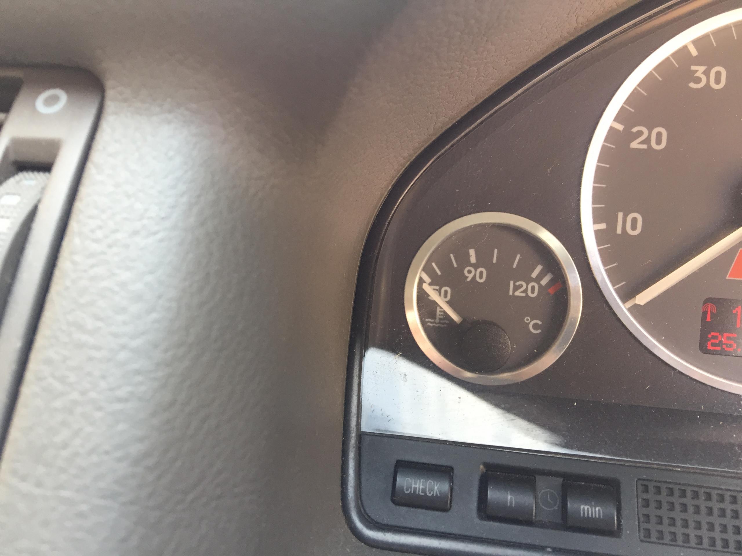

As a slight aside (I'm going to check the viscous fan today after a run), how do you tell so accurately what the coolant temperature is? The 90 degree marker is clear, but which one is 120 and what are the ones in between (and before 90 for that matter) as there seems to be no obvious scale as far as I can see.

105 is within acceptable range, and these engines do often run quite hot. The gauge on the cluster is conditioned to read 90 between 85 and 105 actual iirc. The only way to know for sure is with VCDS from the ECU which measures it directly.
Bizarrely, the cluster passes a guesstimated temperature reading to the climate control based on how long the engine has been running and the operating conditions, despite the fact that it knows the temperature from an actual sensor
  #44
Old 25th July 2018, 08:13 AM
But my question is, for example, which division on the gauge is 105, which is 120 and, for that matter, what does each division right up the scale represent? Only the division for 90 seems obvious to me.
I've heard that before, so in summary the display is really only an "indication" at best.
So, to answer Jim, the scale is pretty meaningless. You need VCDS to get the actual readings direct from the sensor.

As to the gauge itself, it seems someone was having a laugh with it! It doesn't give you the coolant temperature, even though it could, and the divisions marked on the gauge are what exactly? There are 2 between 50 and 90, I don't know which one is supposed to be 120 and I assume that the red line just means 'oh s**t!' Someone went to the trouble of laying the gauge out with non linear divisions that mean sweet FA, it seems; er, 50,60,70..90? 100,110,120 (maybe),130,140? See photo below:

Hi Jim, I was reading the temp on the climate control display. As Mikki says its not accurate, I compared it to VCDS Engine advanced measuring blocks which gives a different reading.
I was hoping the climate control readout is only a little bit off but if it giesstimates it then its no good.
The dial on the cluster only registered the change when the climate control display went to 99. After that they seem to track in line but I still wouldnt trust them for an accurate reading.
