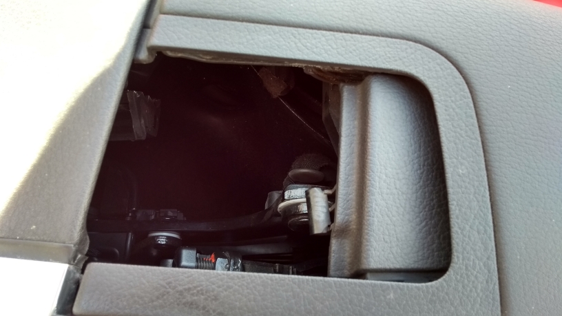

I am pretty sure there was nothing wrong with the motor, I did not test it before taking off so cannot say for 100%. It had hardly any wear on the brushes and I would not be surprised if it has been replaced in the past. The brushes were moving freely and there was hardly any wear dust that could have reduced brush movement.
The sliding cover on the same right side where it was showing implausible switch error is broken and not closing so I think something may have been caught in mechanism on that side and disturbed switch/wiring.

Check the big box of invoices - no mention of a roof motor that I could see.
That cover does clip back in, not sure how or when (possibly before my time) but think one of the tabs is missing meaning it shifts out of it's runner sometimes.

There are several reason I think motor or in fact the whole pump has been replaced some time in the past. I already mentioned that motor looks very fresh inside but it could be due to roof being used very little not because it was replaced. Other clues are oil under pump and it's old dried up sticky oil not fresh leaks so I think it's the oil that escaped from hoses when replacing pump and not cleaned up. The last one is 'Approved' sticker on the pump which I think might mean approved warranty claim replacement.
The sliding flap does have at least one tab/pin broken, I can get it partially closed but not fully. It's best just to replace it. New one from dealer £86 but I have sent messages for several sellers breaking A4 Cabriolets for parts on e-bay for a price quote.
