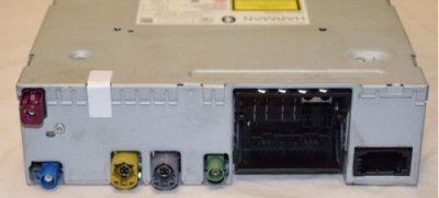

Thanks for your thoughts; for anyone who's interested, find attached an image of the back of the DVD / SD / SIM unit on eBay.
Edit: The attached unit is HW 4H0 035 670P - H47 - 0798
Connectors:
Mauve - GSM
Blue - GPS
Yellow - Audio
Grey - screen/controls
Green - Video from optional DVD stacker
There IS an aerial, presumably everyone gets that for the BT phone. It's anyone guess if the 'Audi Connect' functionality is in the unit so that it will work with a straight swap.
Julian

Looking at it more - i think there might not be a gsm aerial for non sim 5f units, as the bluetooth option relies on phones own gsm signal. This is back of non-sim 5f unit
Which means you'd probably need to add this amp in d pillar - https://www.ebay.co.uk/itm/112234783319
and run cable from roof antenna to this amp and then to 5f unit.
I think all roof antennas have the gsm connector

Ah; that makes sense seeing the other unit without the SIM slot and aerial connector. I thought the aerial might be shared but I didn't realise that BT in the 4H cars used the phone's aerial. A backward step from the early A8s that used a 'SIM in the arm' and an external GSM aerial.
So it looks like at least a 'control head' swap, an aerial run and an amplifier. And that's before discovering whether the MMI will recognise those changes.
