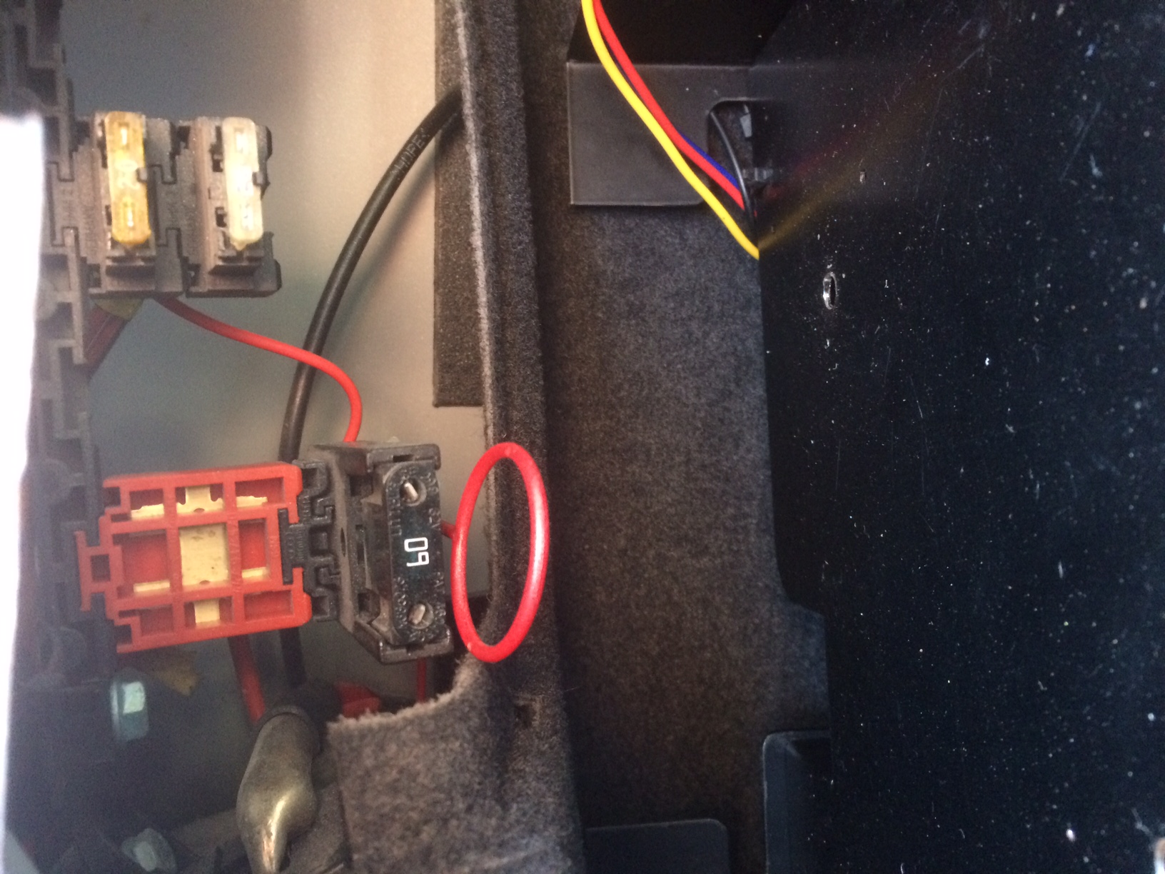

Can anyone help to identify these fuses and electrics which are located behind the right hand side panel in the boot on a 2002 d2 2.8 quattro, I cant find any information on these in manuals or on the internet, im am curious about what the red square part is, it looks to me like some sort of relay holder, there is also a 60 amp fuse located there, I have some issues with my rear screen heater not working and thought these maybe related to the problem.

They're normal and in the manual. Don't have mine to hand to check right now.
Old 24th October 2018, 11:41 AM
Top yellow one is Bose. Can't remember what the lower white one is. The 60A is ABS iirc. The red block is a junction box.
The heated rear screen fuse is up front somewhere.
