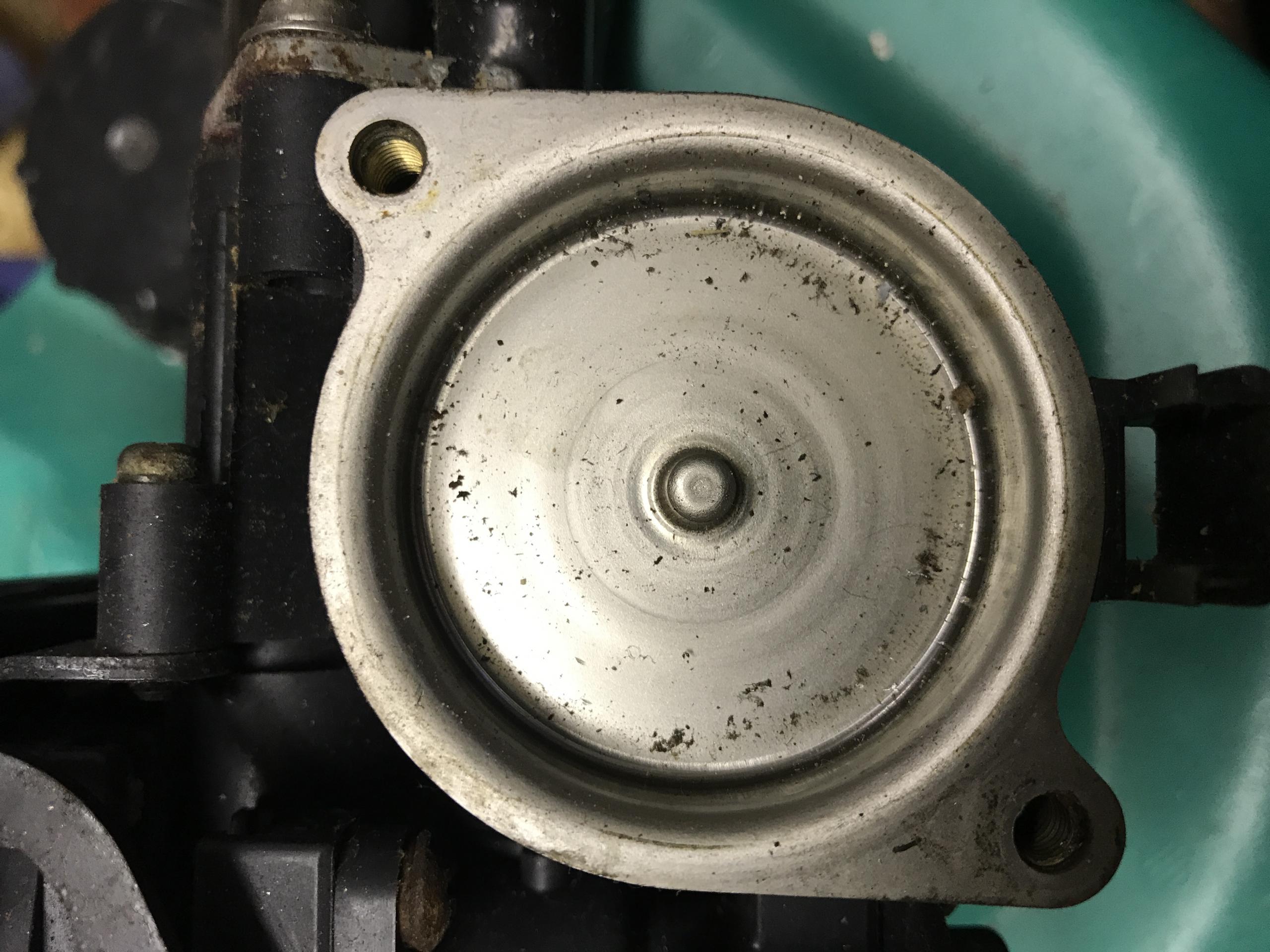

Hi Nognar it looks like from your picture that the valve block on your car simply has the motor missing, it is a magnetic drive to the impeller it's a pain to get off i removed the ecu box. many owners just disconnect this and are happy with the results.But i love this feature if parked waiting for someone or get out of the and i may be getting back in. it stays on for about 10min keeping the inside toasty and windows clear. so i'd fix that myself but its your choice.
But i suspect 40c to 50c upto the matrix isn't hot enough i would expect the temps to be upto 90c as the heater gets water that's split circulated near to the exhaust valves for faster warm up. I'll try and check mine so you can check. Dave
Ah, the demon Auxiliary Coolant Pump.
Yes, I'm one of those owners who just disconnected the wiring and am happy.
Didn't realise it was a magnetic drive though; I might investigate it further with a view to reinstating.
In this case, if the circulation is already compromised, lack of that pump could well be more of a problem. It does run all the time, not just when using the "Rest" function.

And without a powered auxiliary coolant pump there's probably not much, if any, hot water getting to the HVAC unit. It's probably all being recirculated to warm the engine up faster.
Of course, after a few minutes when the temperature gauge started to move, it all sprang into life.
So, my conclusions (at last!). It seems to me that MOST of the symptoms described here are down to normal/intelligent HVAC behaviour, probably exacerbated by inaccurate/faulty temperature sensors (but which ones) and the lack of an ACP motor.
Though low flow through the heater matrix if it's partially blocked won't help of course.
Incidentally my valve unit looks the same as the one you have installed (picture repeated), not like the one purchased. I can't actually see any motor or where it is.
Maybe under the air intake?
