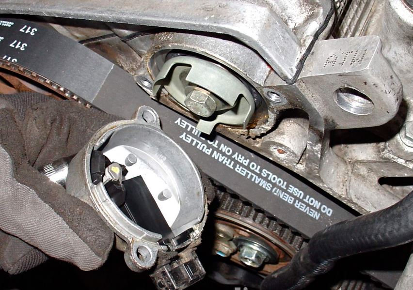

I'm not sure we are talking about the same thing here.
This is the G40 sensor removed with the trigger ring on the end of the cam. The pic is from a 1.8T, but its the same concept as the V8.
It should be simple to see the trigger ring turning, but your description of looking down a hole suggests its a completely different arrangement to this?
I'm inclined to agree it doesn't sound (literally) like a mechanical issue - if the cams on one side were stationary the engine likely wouldn't even turn over. There's no wiggle room in a diesel engine.

We're not talking about the same thing.... Well, we sort of are. The G40 on the 4.2tdi looks much the same as a crank sensor. There is a hole in the bottom rear of the left bank rocker cover that the sensor fits into. Although fairly accessible for an A8, it's still really awkward to get to and all the action is happening 3/4" down a hole that you can't see down.
Putting the endoscope down makes me fairly certain that the left bank camshafts aren't turning.

Ah that makes more sense now. Interesting that its a hall effect sensor in that configuration. Usually those are inductive pickups, but the wiring diagram is definitely a hall sensor.
