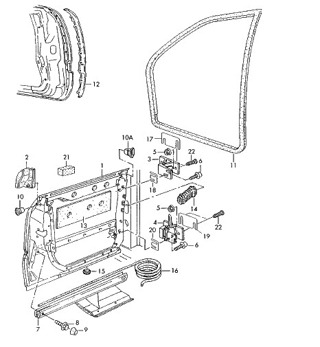

Posts: 3,878
Which one do you mean, 11 or 12?

Not 11 and not 12. I meant seals that you can see from the outside of car.
On the picture below the place where this rubber seal starts is highlighted with red (this is not A8, this is just picture from internet :^) These seals go around window frame.

Ok. Those just pull out and push into a sort of double self locking slot. I can't find them in ETKA either!
Try A8 parts.
