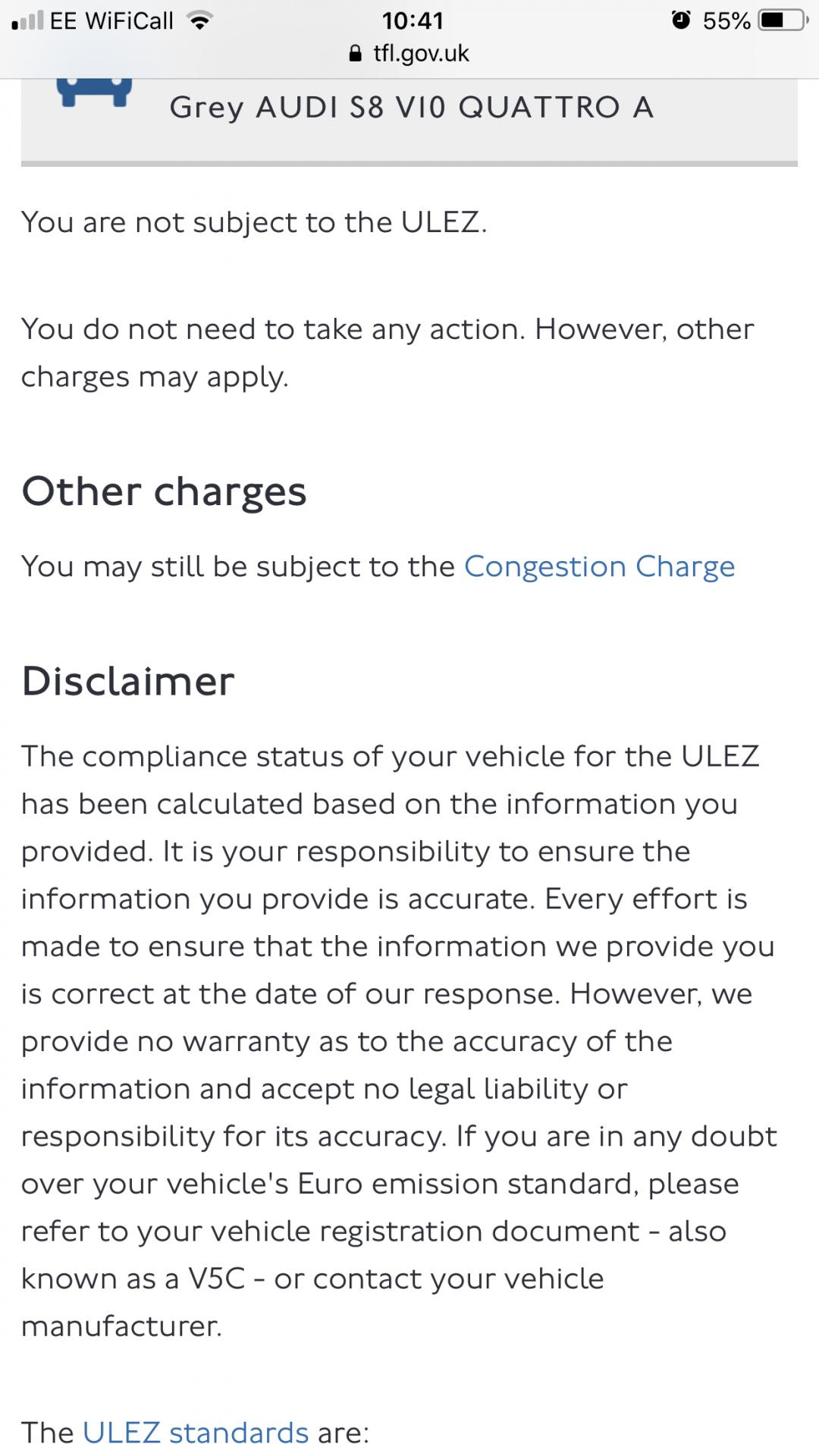

After reading your post I checked my car against the ULEZ on the TFL site as I am in Putney all week and apparently i’m Ok, so get an S8!!

I know this is a D3 thread, but a D2 S8 (mine) also passes.
It's a very late FL model and was unusually first registered in 2003 which may confuse the system.
Just wondering if other D2 S8s (including PF) are OK for the ULEZ?

Early FLs have Bosch Motronic 7.1 engine management which is Euro 3 compliant. 2001 onwards use Motronic 7.1.1 which is Euro 4 compliant hence also compliant with the ULEZ. The only change in that 0.0.1 version is independent control of the cam timing solenoids and a warning light if the SAI system is broken. Apparently that made all the difference
PF are pre Euro3. No pointlessly complicated emissions gear, just simple catalytic converters Unfortunately also no tick in the ULEZ box either.

Just curious (as I'm unlikely to be driving in London), so I tried my 3.7 D2 and it passes, as does my D3 S8. What confuses me though is how we get charged £555 road tax a year on the S8 because of it's emissions, yet it is clean enough to use in the London ULEZ zone.

It's mainly about pollution, i.e. secondary pollutants/particulates such as NOx/CO/HC/PM, not CO2 and Global warming.
So you can burn (currently) lots of fuel as long as you do it cleanly!
Interestingly, a decode of my build sticker shows a code for Euro III but not one for Euro IV, though I'm not sure when exactly that was defined/ratified (Wikipedia suggests not until 2005/6!).
