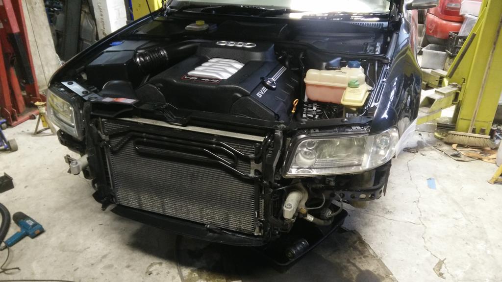

Engine covers on
Headlights in and ready for the bumper

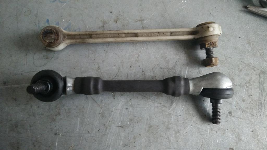

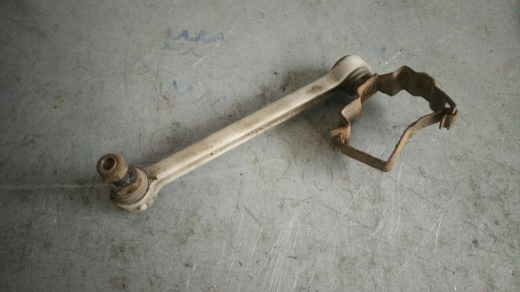

The headlight level arm was seized, as usual, and actually the wrong one. This is for the non-20" cars so was rattling around on the arm.
This is the last ever FE levelling arm. We don't want that though cos its rubbish.
Chop the bracket off - we still need that.

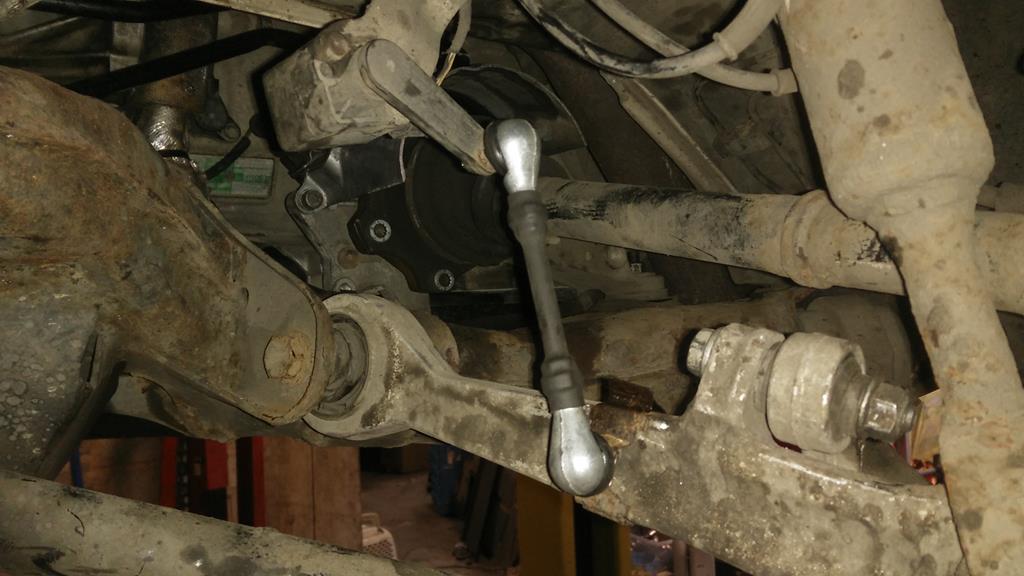

Oh looky - ball joints
Set the length and then apply heat shrink to protect the thread
Attached to the bracket
That ought to last a few more years than the plastic tat, and I can make as many of these as we need
Re-using the original bracket isn't ideal. I plan to print nylon versions instead.

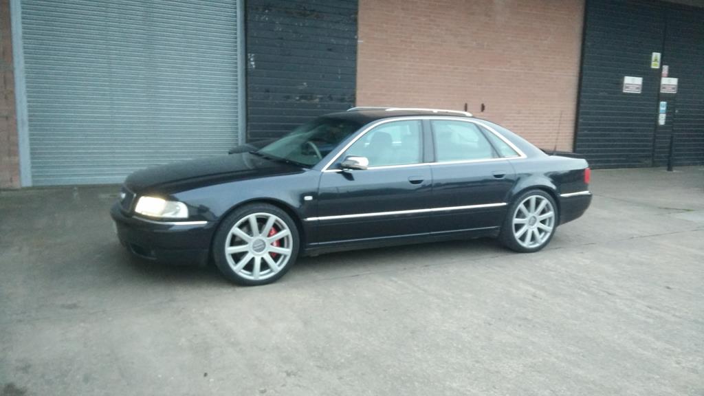

Out in the yard after the road test. I haven't fitted roof rails - that's my A6 almost perfectly obscured
The final step - setting the headlight aim
72 hours all told. That's rather more than I planned for since there was an awful lot of cleaning to do, but a good result at the end. The engine is lovely and quiet now, and in fact starts up more smoothly than mine!
