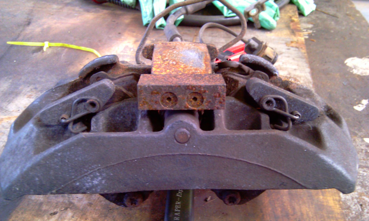

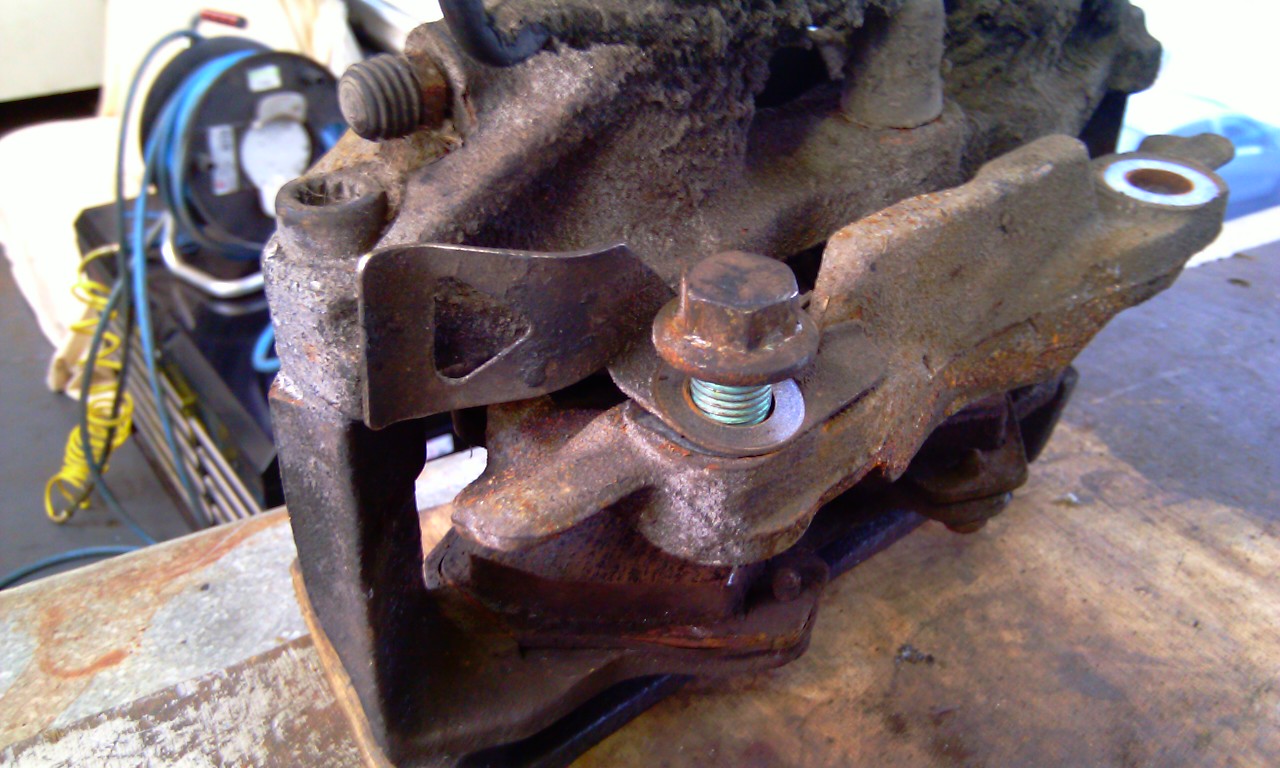

Old 30th September 2010, 03:41 PM
Posts: 3,878
Default Calliper Anti Rattle Springs
Here is the slide anti rattle spring
Here are the outer pad anti rattle springs
HTH

Old 30th September 2010, 04:16 PM
Posts: 3,878
Part Nos for calliper springs are:
A8 - 4D0698135
S8 - 4D0698135A
