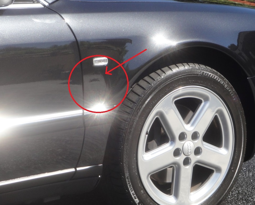

>> this has been painted at some point:
Sh*t, really? 35000 miles car...
Yeah that's not factory orange peel. Compare the finish on the panels to the plastic rubbing strips or the roof. I'd need to see it in person to be 100% sure, but I'm 99.99% from that pic. Likely it had a scrape down the driver's side at some point. It might be possible to wet-sand it flat and re-polish, but that would be entirely dependent on paint depth.
Mikki, would please you take a look at eBay advert one more time https://www.ebay.co.uk/itm/223514465998
In description section there's many outdoor pictures of the car.
I wonder if you can detect the difference in orange peel on driver's door on those pictures.
You can see it again here:
compared to the clarity of the reflections on this side:
As Adrian says though, chances of finding a D2 with immaculate factory paint these days are approaching zero. All of mine have been painted somewhere, as have pretty much all of the ones I've worked on. I think the only exception may be Neil's 3.7, but I haven't been looking for paintwork so I can't be sure.
It looks from the pictures that this black one has had its driver's door painted and been blended in to the wing and passenger door, but I'd have to see it in person to be 100%. The colour match looks fine in the photos so if there is enough paint depth then the orange peel can definitely be improved I agree with Adrian that if the rest of the car is right, that paintwork wouldn't put me off.
