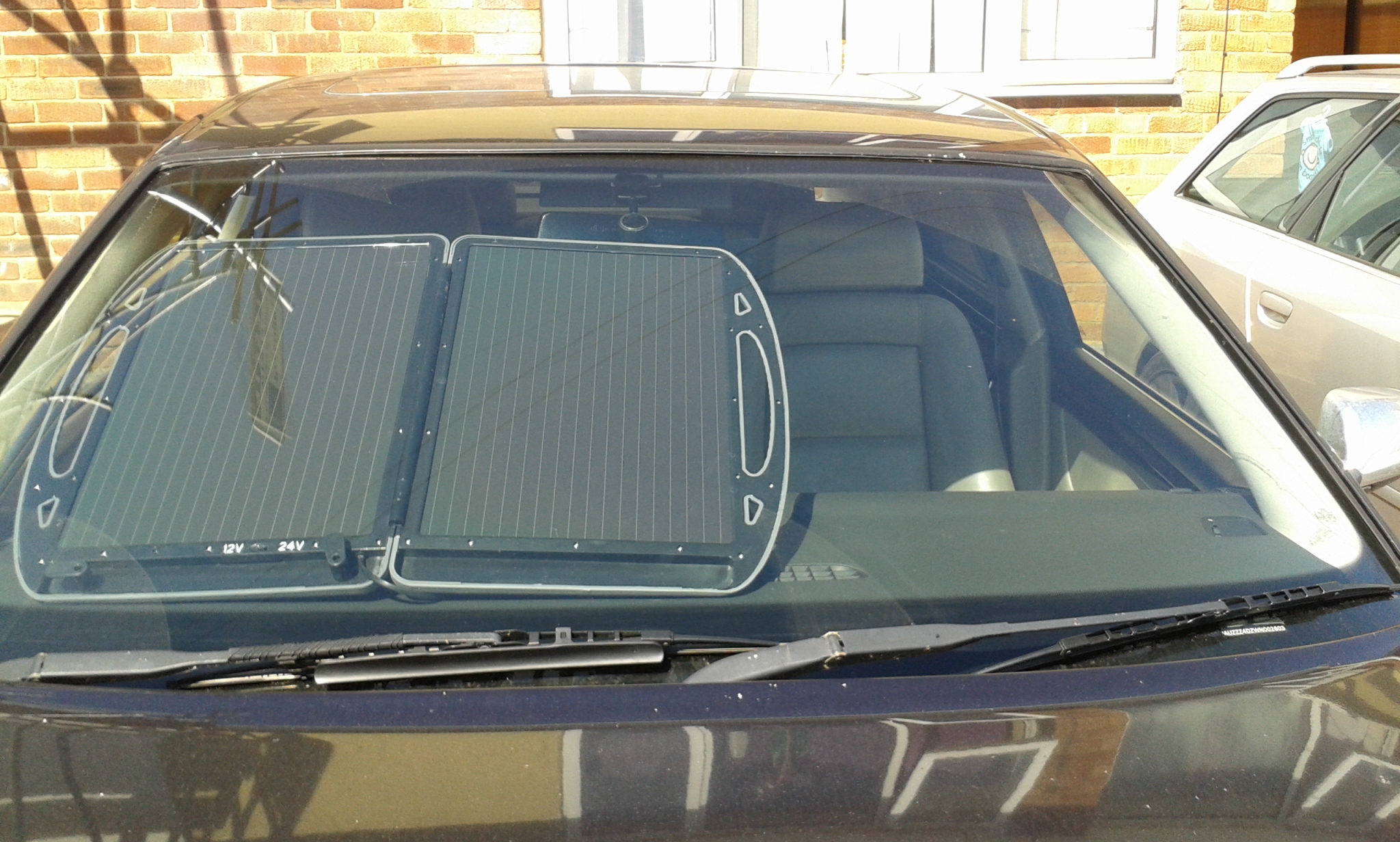

13W solar charger

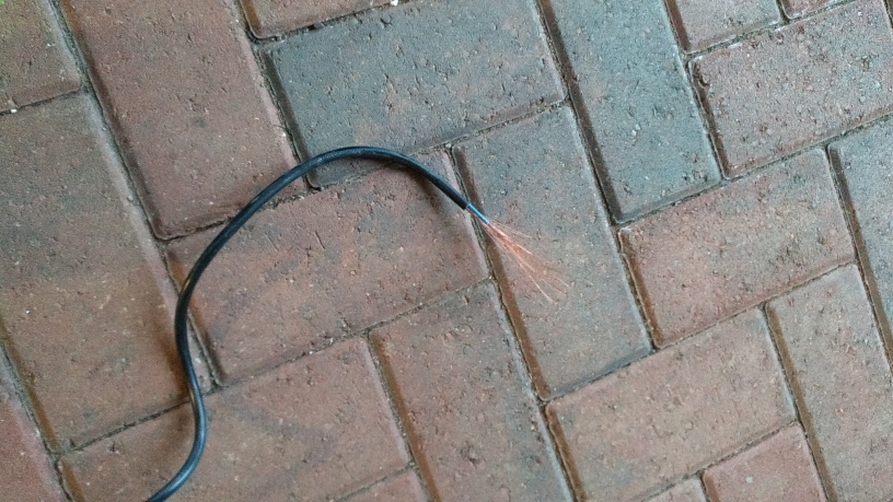

This is what happens with mains charger on drive if you have more than 1 user and that other user drives away without spotting a cable.

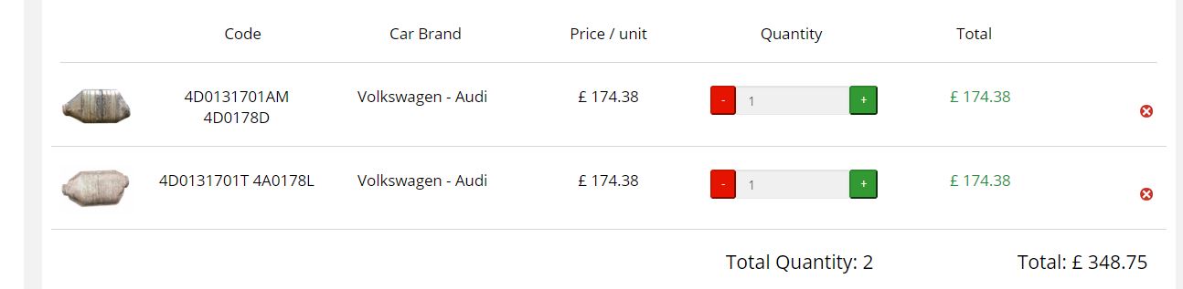

No progress as I have been busy with other things. I bought a set of 16" wheels from A4 to go on it so that I can keep 19" Carlsson wheels, cats are coming off as they have £340-350 scrap value, probably take out radio, good battery, floormats, maybe some other bits then rest goes to scrapyard.
