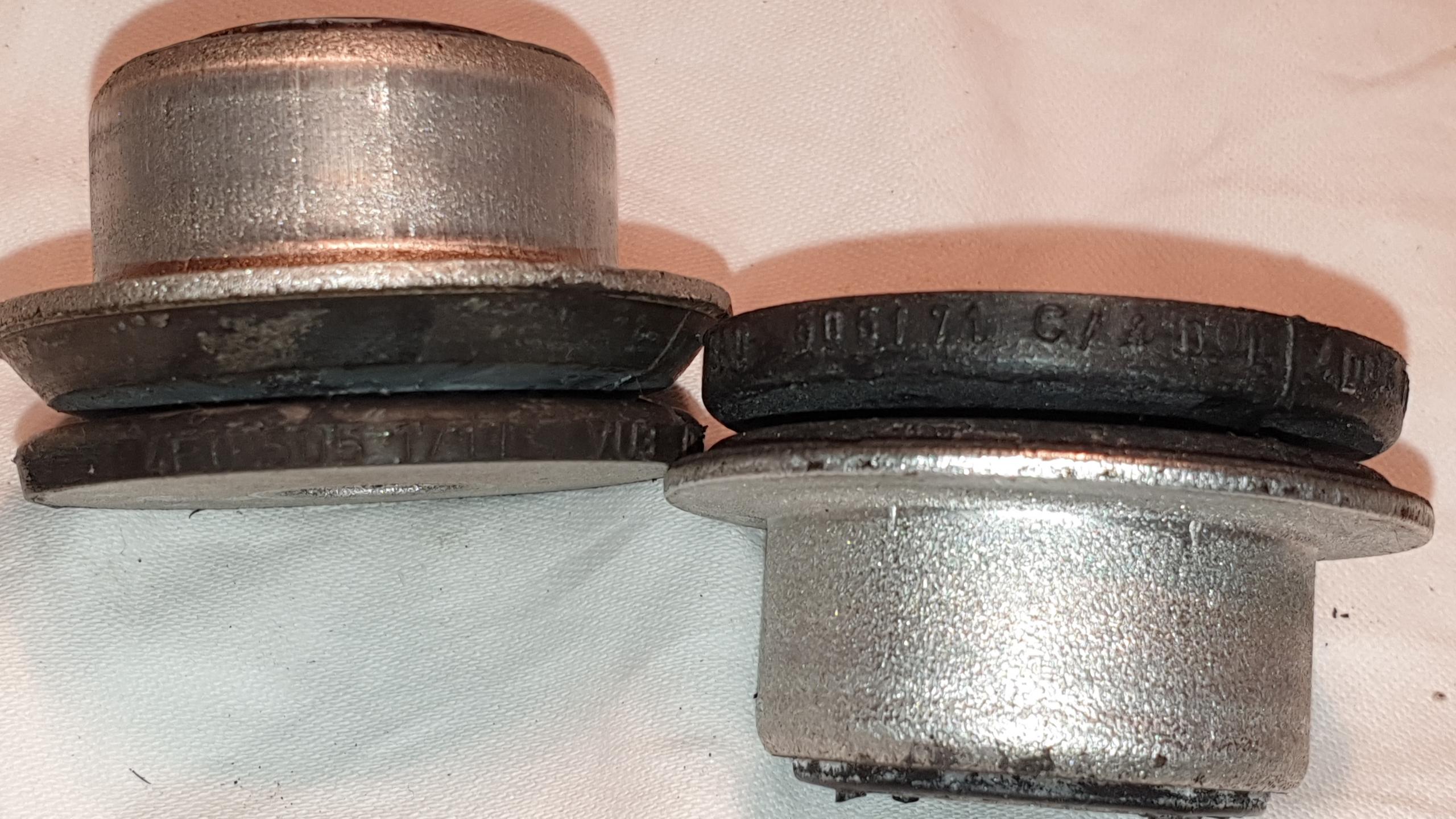

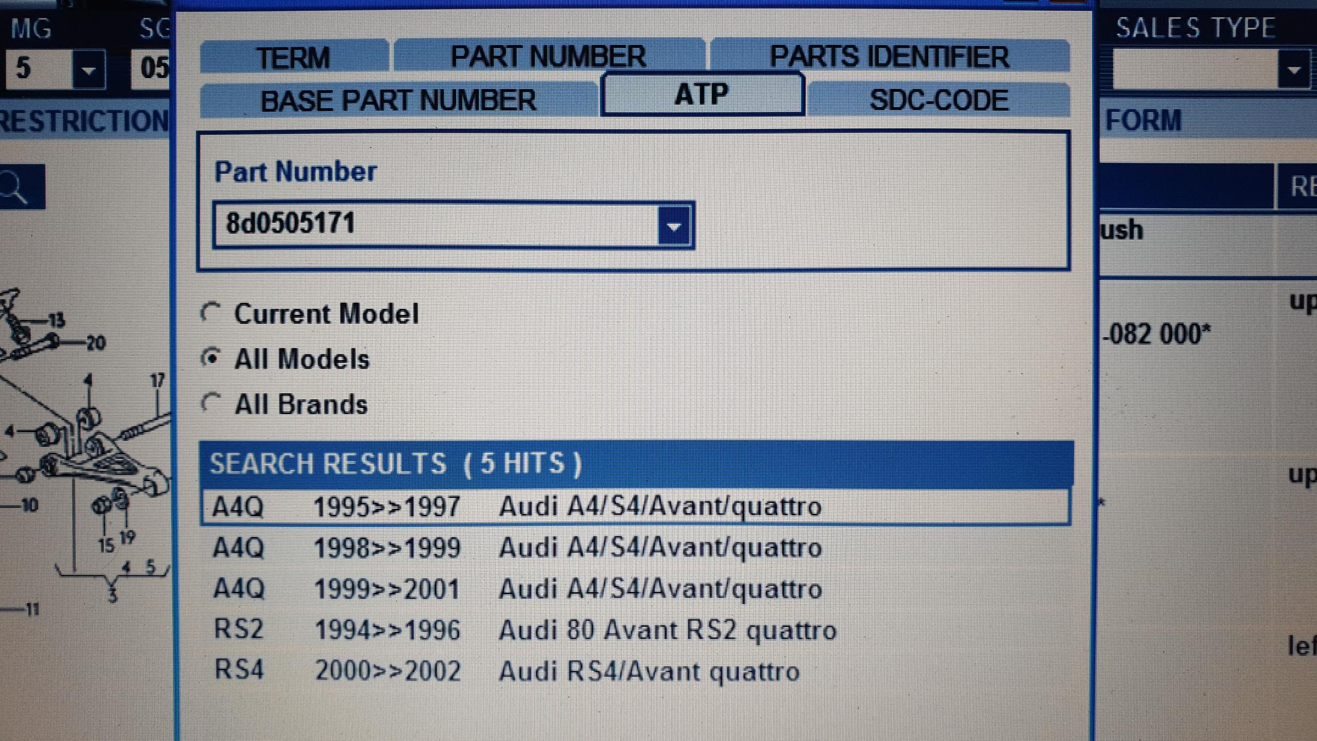

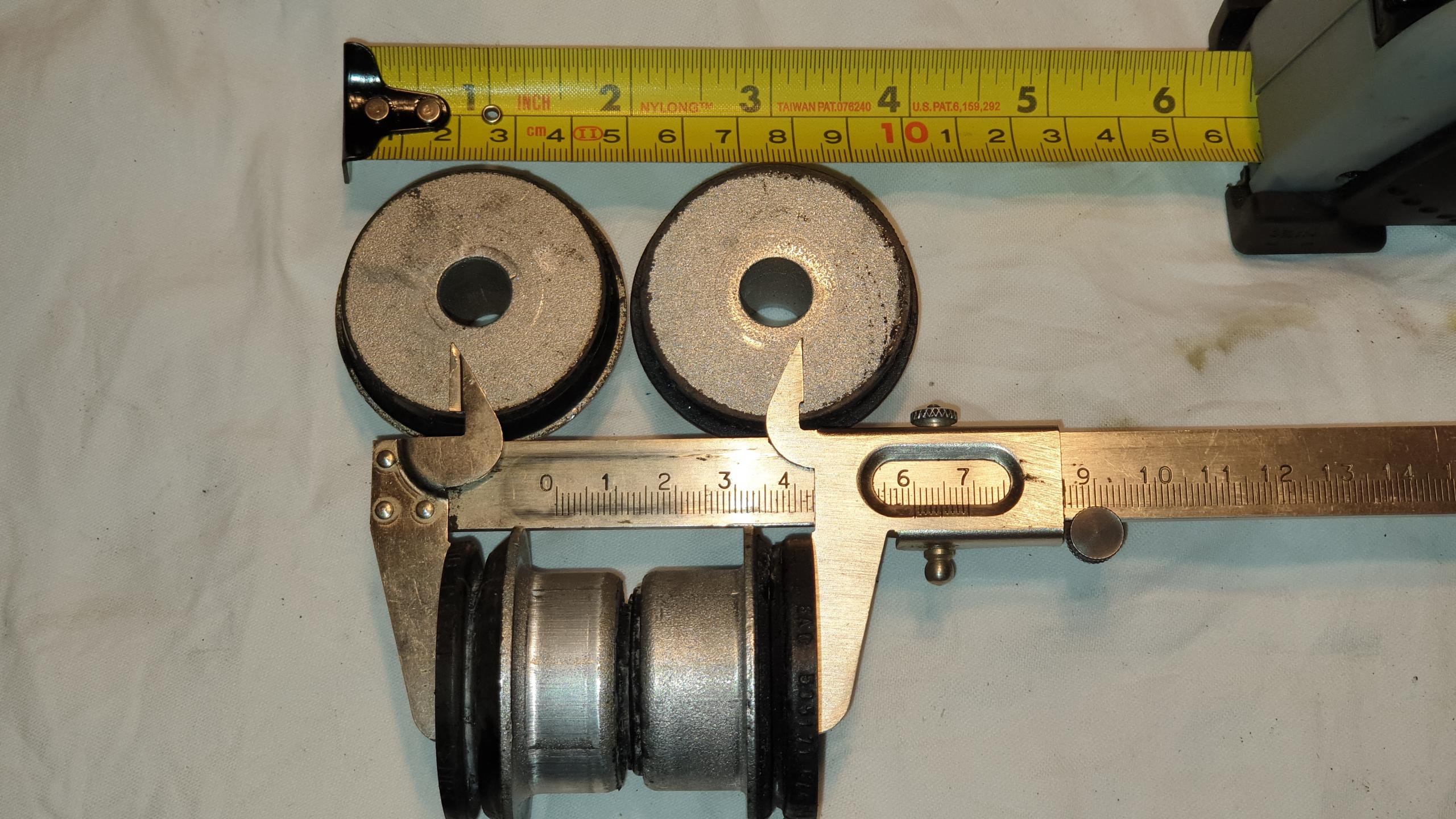

Old 16th November 2019, 03:42 PM
Join Date: Dec 2016
Posts: 424
Hi all
In the image below the Lemförder 25881 01 (aka 8D0505171) is on the left. The bush on the right is the genuine Audi 4D0505171H.
The second image is a list of what vehicles these (8D0505171) bushes were fitted to (I think).
I have had a vernier gauge all over both bushes and the dimensions are all the same. The only, and obvious difference is that the Lemförder one has a mild steel casing as apposed to aluminium of the original. Funnily enough the Lemförder feels like better quality. I guess that's just the illusion of "weight = quality".
I don't see any reason why the Lemförder could not be used if the genuine ones become NLA but am happy to concede to anyone with more wisdom.
The mild steel casing pushed into an aluminium wishbone may create a galvanic corrosion issue but I seem to think Audi has done this before anyhow.
What do you think, a usable back up plan?

  #39
Old 16th November 2019, 04:05 PM
I've had one of these from an A6 on my desk for years, but never bothered to measure it because of the mixed metals issues. I really don't know how everything would react.
I wonder if using some sort of sealant on the bush flange as it's put in would prevent moisture getting in to the joint and therefore prevent corrosion?
  #40
Old 16th November 2019, 04:20 PM
Join Date: Dec 2016
Posts: 424
I could be completely wrong with this but I think these bushes were fitted to the RS4 front end. Year 2000 ish and wasn't that an aluminium housing?
Still, would be a pain if you ever needed to replace them I guess. Aluminium ones seem to come out quite easily but I suspect that would not be the case after years of galvanic corrosion with the mild steel ones.
May get someone out of a bind at some point in the future though, maybe?
Audi S8 D2 2002 88k mls
