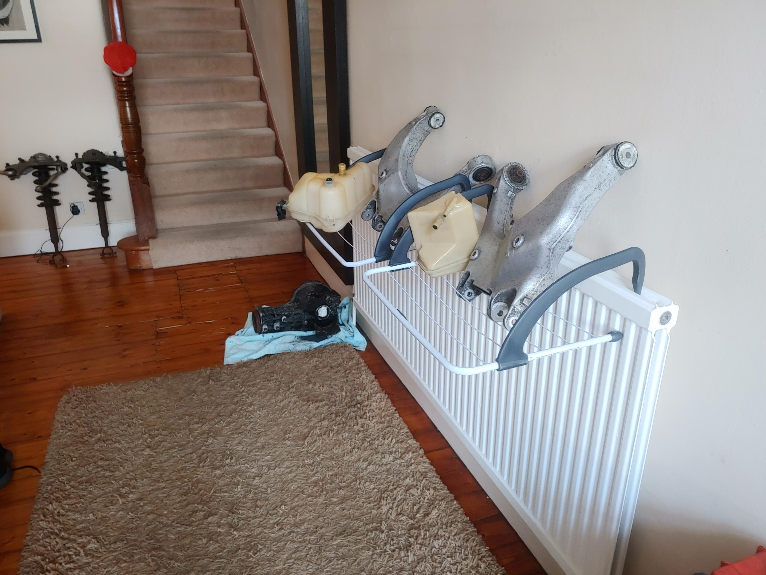

A bit random but I thought I'd post this picture incase anyway is interested.
Near side almost back together.

Not random at all. Looks like a job very well done. I'm putting myself through the same process at the moment so your picture has given me inspiration to ignore the onset of cold weather and keep going!
How did you get the Trapezium link so shiny? I've got a couple of spares which I've been cleaning up but haven't got anywhere near as shiny as yours. Are they painted?

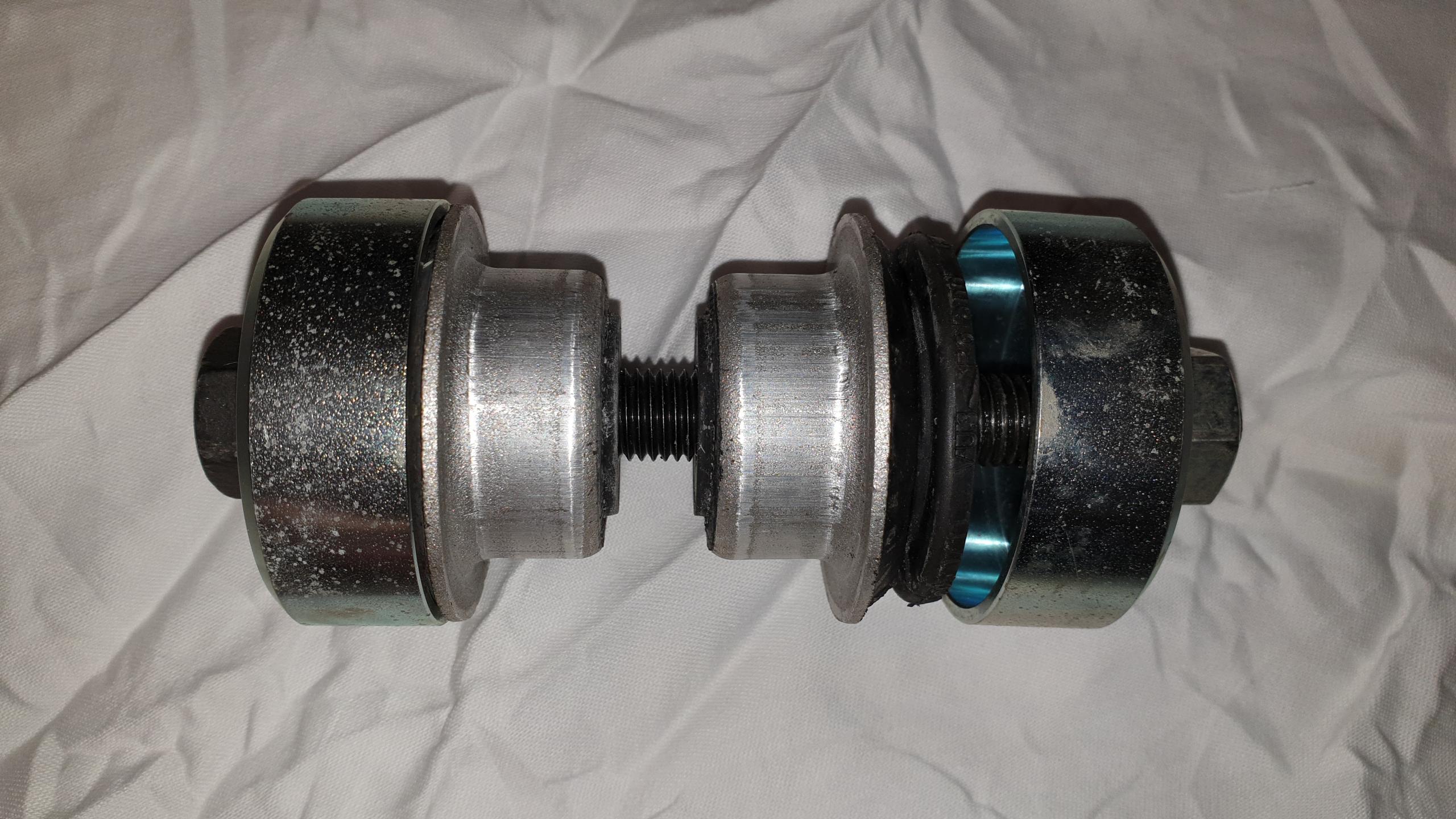

If I get chance later I'll post a picture of the old bolt I have. If I'm recalling it correctly I think they are in better condition than the ones in your picture, I'll check.
As for the bushes in the wishbone. I managed to change the single bush with the use of a 6t press. It was a bit of a pain as I didn't have the correct size of tube to push it out and the shape of the wishbone makes it even more difficult. I can't remember exactly how but somehow I managed.
As for the split bushes, they come out quite easily as they are made of aluminium. They will simply collapse as you start to work on them. Putting the new ones in is also super easy, especially if you have the correct tool. It's tempting to put the whole unit in a vice with the bushes in place and simply tighten the vice to force them in. This is not what should be done though and will put a lot of compression pressure on the rubber. I have the correct Audi tool if you want to use it. I'm sure you could make something up quite easily but if you want to borrow it just let me know.

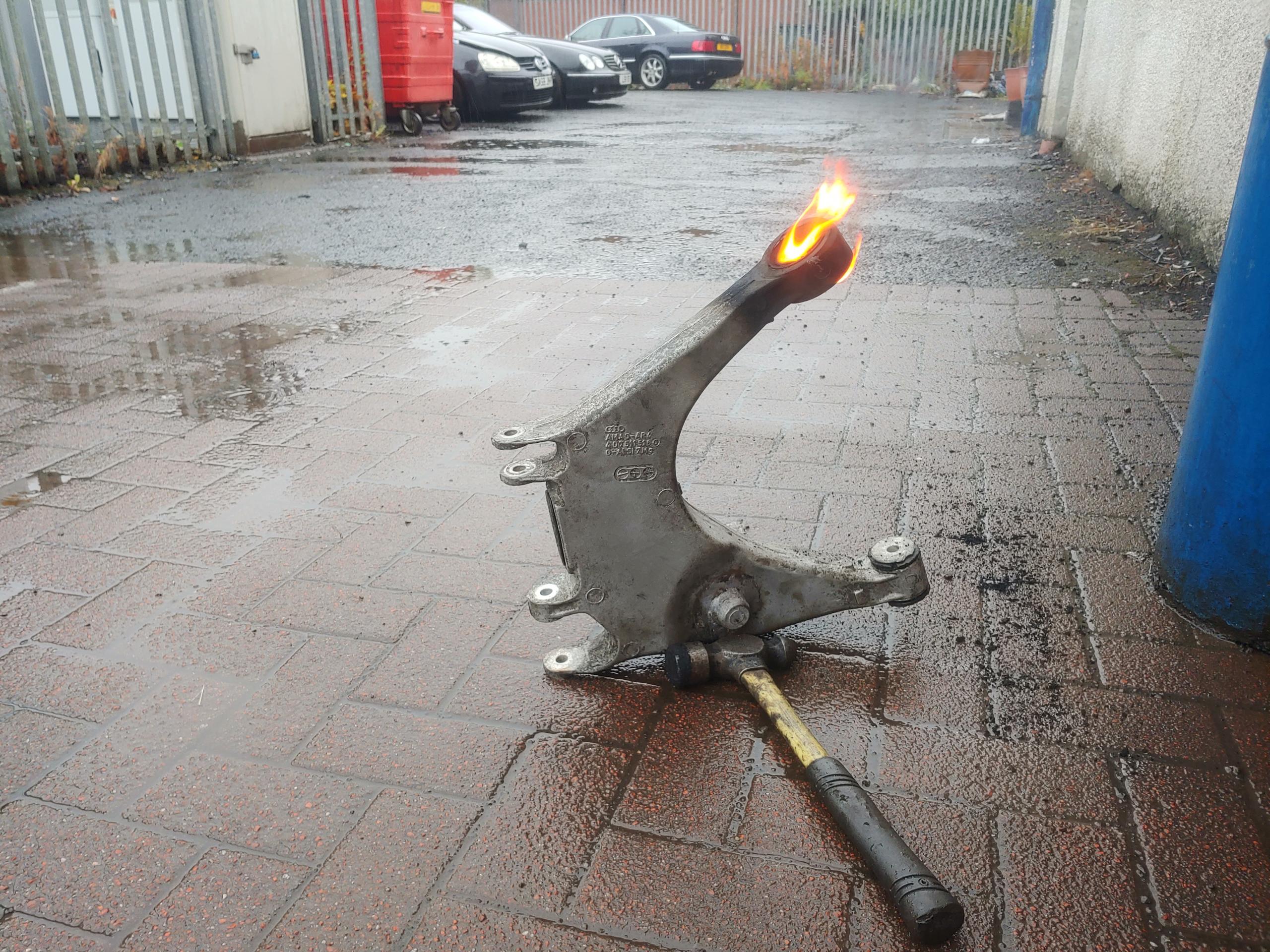

Having been in PM contact with Frank (Spannerrash) he's posting me up his bolts and tools for which I'm genuinely grateful. Both to him and also to the spirit of this forum
So, in the interests of using the tool and posting back to him quickly I thought I'd have a go at seeing if my spare rear hubs could be used as part of the 'off the car build-up'. The more I can build up off the car with new parts, the quicker and easier the restoration ought to be. Old out and new in. That's the theory anyway.
I was faced with properly rounded driveshaft bolts (see pictures) But victory was mine in the end. After a bit of not-very-pretty nuclear welding and my trusty Milwaukee impact gun.
After the new nut was welded on it really didn't take much for the gun to shock it loose tbf. I'd applied some MAPP Gas heat beforehand but, on reflection, that was probably a waste of time given the heat I'll have put in through welding anyway. I purposefully overdid it on the welding as conservative blobs on the first attempt just split off straight away. And I probably couldn't have done it much neater if I'd tried anyway
Managed to get all the single-piece bushes removed okay using a 10T press at the garage (had to burn out the centres of the big trapezium link ones to get better access to press the steel outers - that's how the boys at the garage routinely do it anyway, so they say) Not much sign of galvanic corrosion, I have to say. They are just really tight. Gives me confidence in using the steel bushes.
Interestngly, this Ruville wheel bearing kit appears to supply the elusive eccentric bolts and washers. Part of the Schaeffler Group who appear to supply FAG, INA and LUK. I think I trust FAG and INA as brands, but does anyone know about Ruville? Maybe just the same stuff packaged in different colours? The equivalent FAG kit includes the eccentric washer but not the bolt, judging by the pictures. I've messaged them to ask why and will feed back to the forum.
Wishbones cleaned up nicely with wire brush, Swarfega and Scotchy pads. Might follow Frank's example and paint them though.
