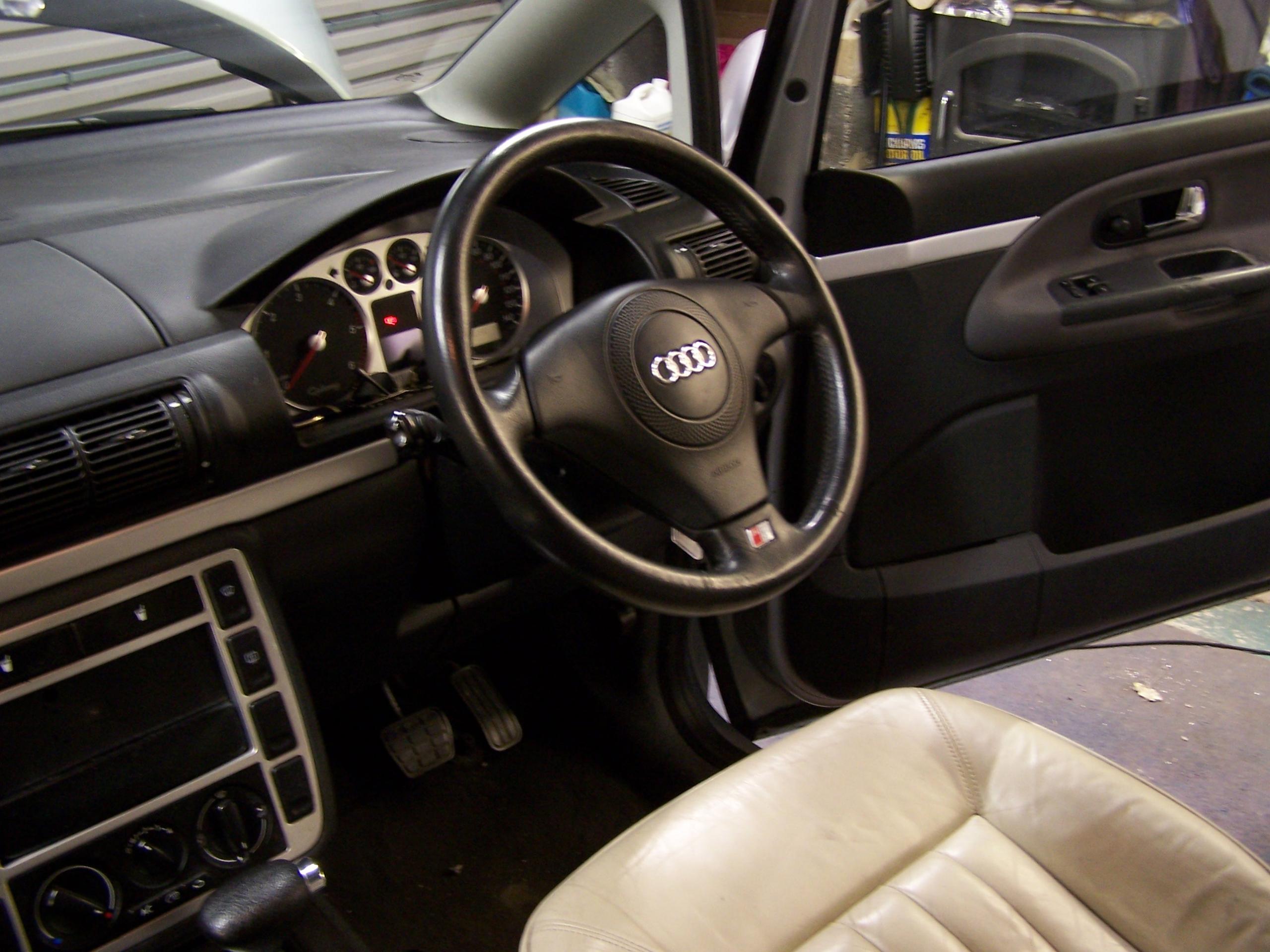

heres one for you ....
i had this lovely A8 steering wheel on my Ford Galaxy 2004 (the galaudi)
perfect fit
So the Ford Galaxy will fit perfect on the A8
why not ... ooh and front A8 seats too
