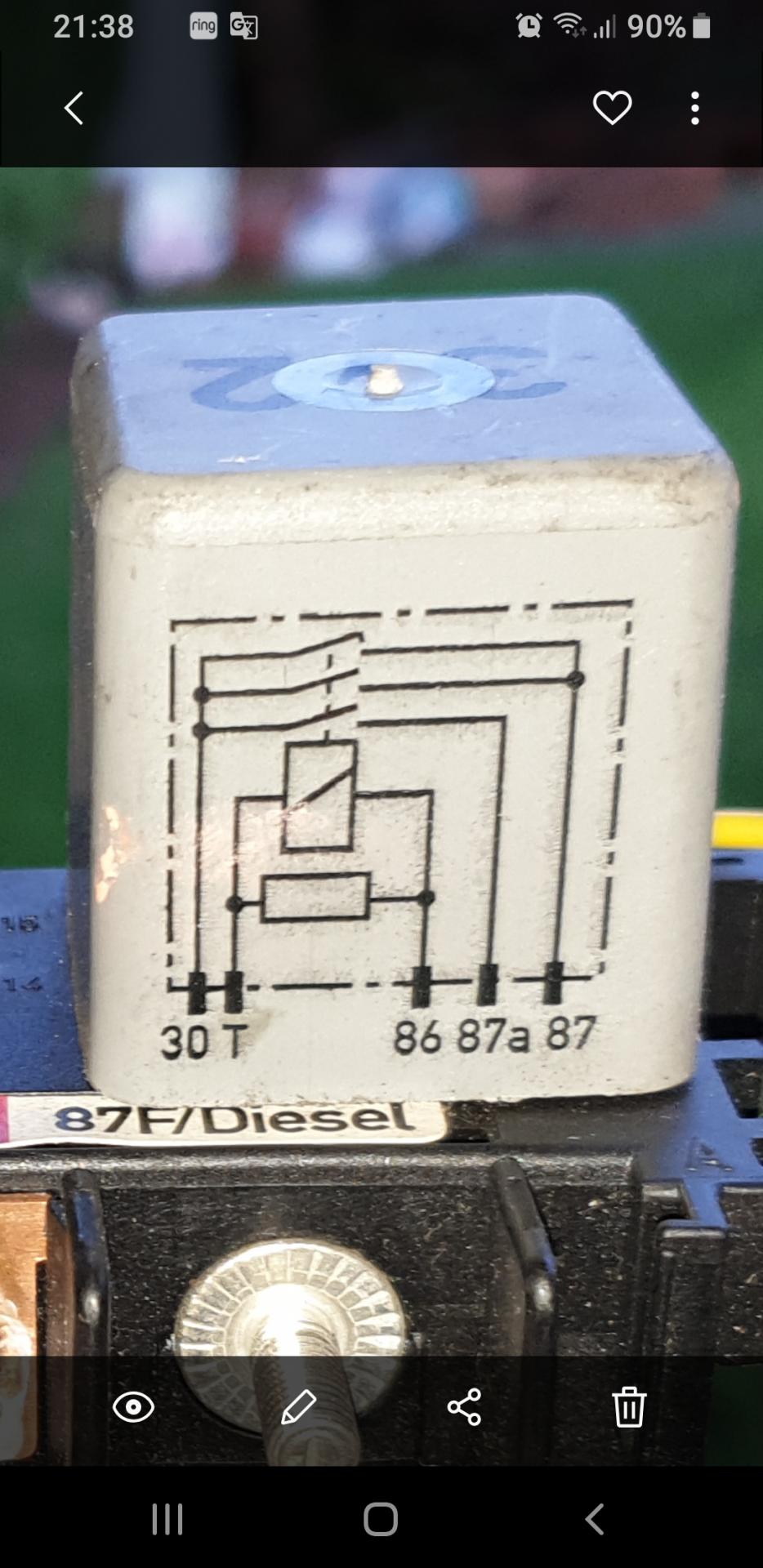

Its just an ordinary relay.
Just clarifying this a bit, attached is a photo of the side of the VAG 204 Relay (431 951 253H).
The extra component in the 85-86 circuit isn't the usual symbol for either a resistor or diode, so what it is? I assume it's providing some sort of protection.
I currently have a spare anyway (many thanks, Frank ) but if I was to order a replacement online (rather than trying to extract one from my nearest VAG spares department) what am I looking for in the specification?

My belief is that that is the symbol for a resistor. The one with the diagonal line through it is the symbol for a magnetic coil.
When the coil is energised, a magnetic field is created, which, as we all know, closes the switch. When the coil is de-energised the magnetic field collapses. This collapsing magnetic field has the potential to induce a current in any nearby conducting wires if not correctly managed. This is how an ignition coil works.
The usual way of dealing with this is either to block it from damaging anything sensitive with the use of a diode (electrical one way valve) or use a resistor to disipate the current.
I have some other Audi relays and the symbols are the same on a number of them.
Personally, I would only buy genuine ones. They can't be that expensive.
Cheers Frank

Sorry, forgot to put the picture in.
Yes, I think so too, I found some Bosch equivalents online with a specification that implied a resistive protection.

Probably a varistor rather than a simple resistor. I suspect they've just simplified the symbol.
Varistors are commonly used in electronics as voltage limiters/arresters. In this case it will be to limit the back-EMF generated by the relay coil, to prevent interference and potential damage to the relay drivers.
https://en.wikipedia.org/wiki/Varistor
A diode can be used instead (across the relay coil), but has the disadvantage of slowing the relay movement, which can result in contact arcing/burning.
