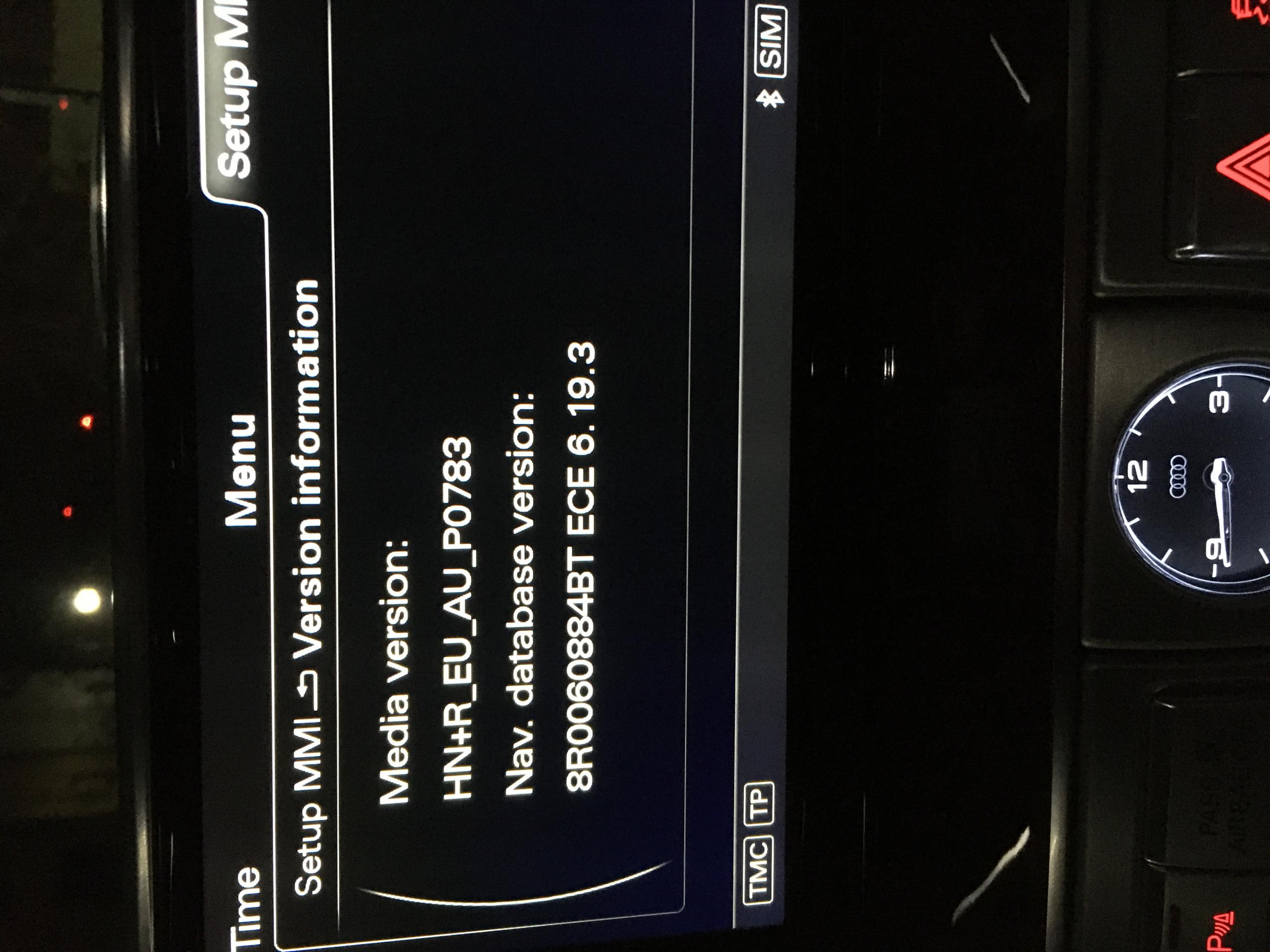

What firmware are you on (Menu > Setup MMI > Version information)?

My one is the factory SW dated 2014. Sounds very complicated from your end. I have done the SW and maps update on my previous D3 which was quite straight forward. Kept the engine running whilst I did it.

Pretty sure that 2014 firmware will work fine. How about grabbing a free Vodafone PAYG SIM from Tesco, sticking a fiver credit on and editing the APN?
