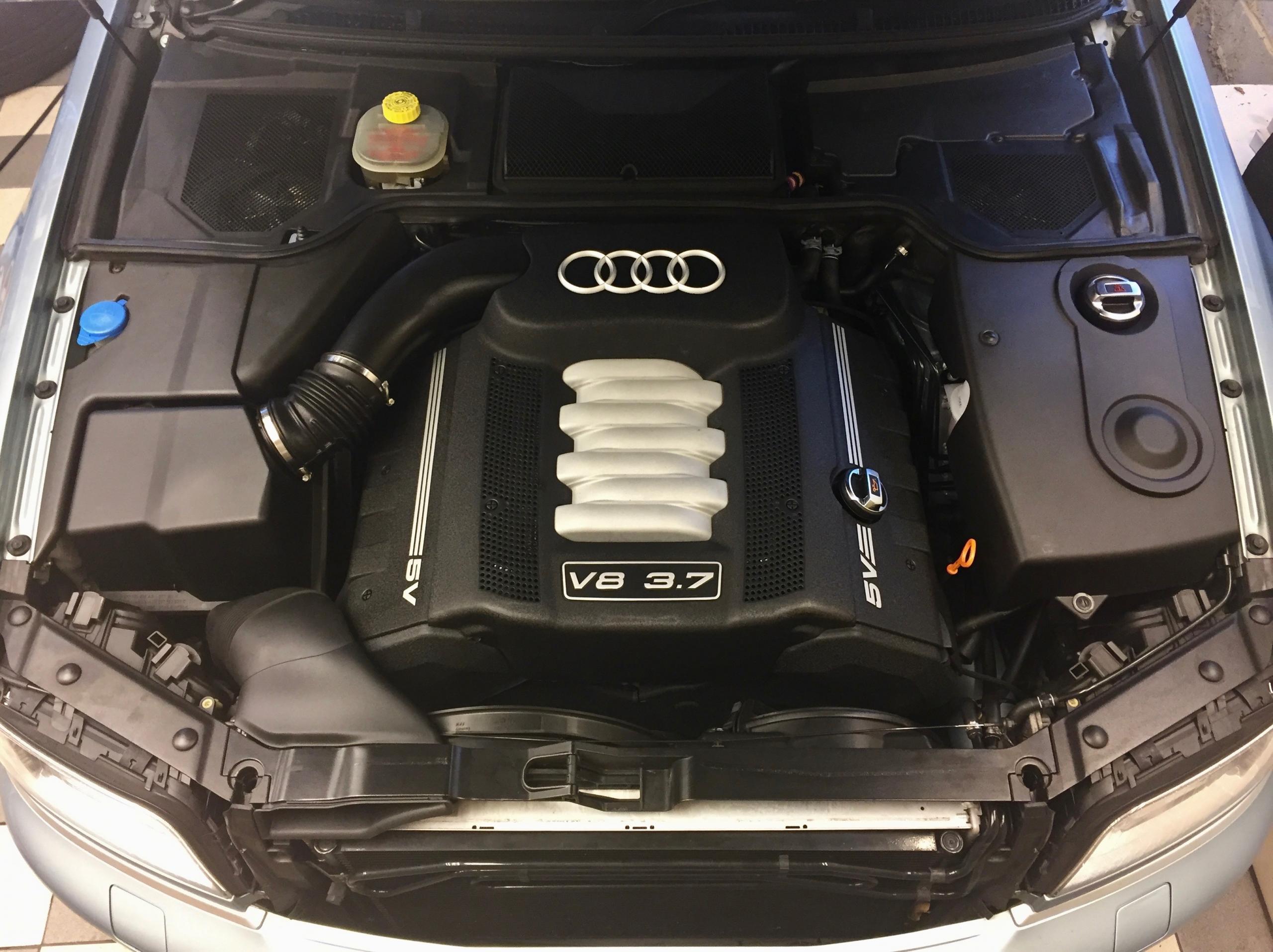

Posted to my Facebook today:
"I found the key to the universe in the engine of this car"
