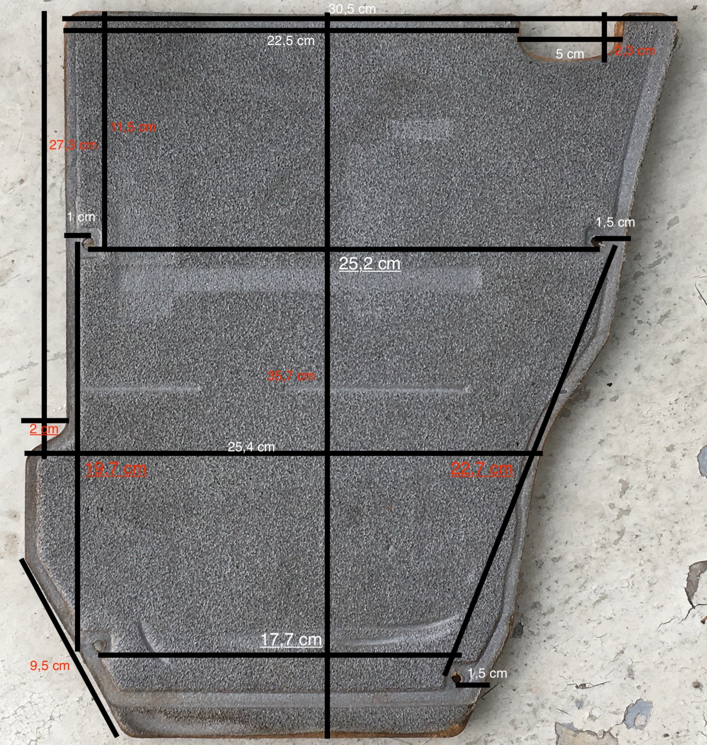

Anyway, some measurements looks to be in the neighbourhood of mine. If so, this is how it looks on my car. Left wheel drive, of course. Apology if you mean something else

I took mine out and measured it, photo from the backside. Should be correct perspective for the right hand drive
With specific measures between bolt holes, center/center

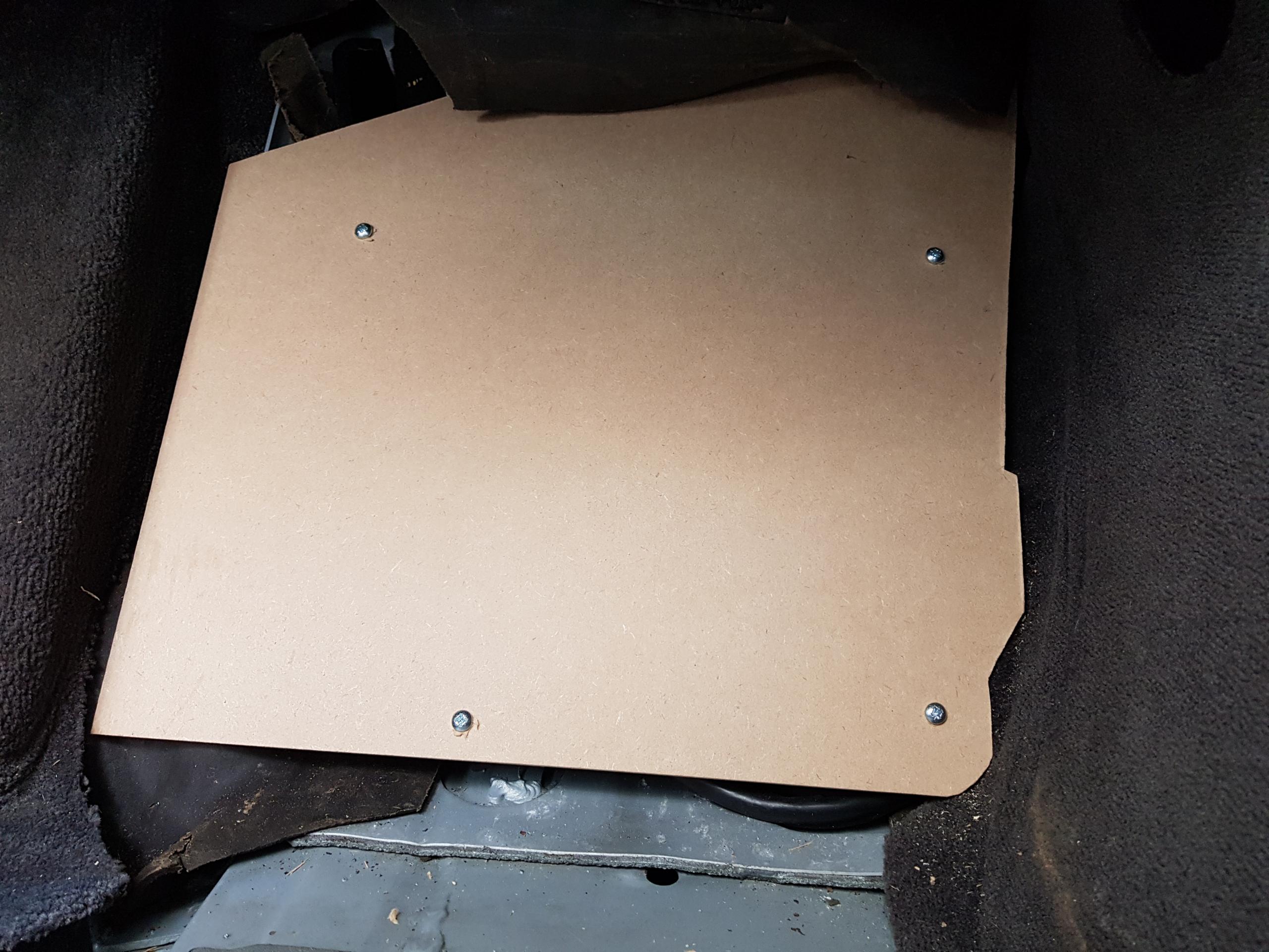

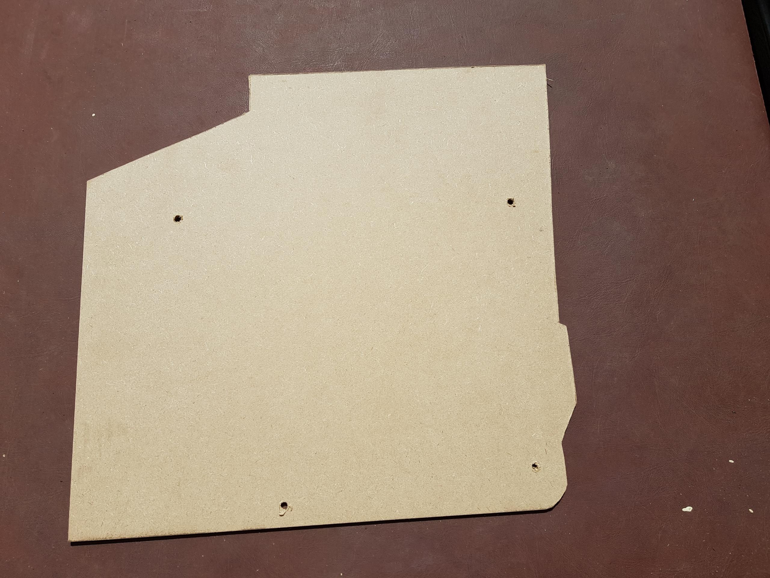

Hi Ronin, I had the same issue a while back. The whole board was a soggy mess owing to multiple leaks. No real template to start from so I made my own. I have a full set of dimensions if you are interested.
I still have it in CAD format as well.

Hi Ronin,
Hopefully they are attached (still trying to get used to the forum). Priniting the A4 or A3 at actual size should guide you.
These are the dimensions that worked for me.
