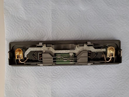

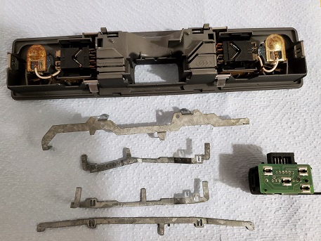

Here is a picture of my rear light assembly taken out of my S8. Oh my gosh I hate rust!
I carefully pulled out the bus bars and light switch.

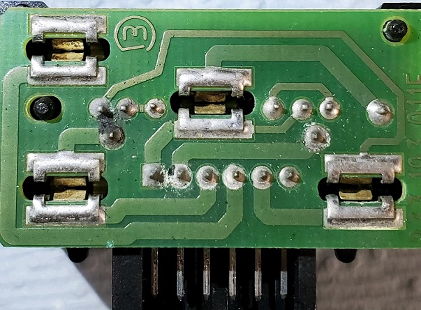

Here is a close up picture of the light switch circuit board.
Do I need to separate this green circuit board to fix the solder joints? If so, do I just carefully pry up the circuit board?

Old 9th June 2020, 09:17 PM
NO! All the joints are in front of you. Just make sure they are separate from each other and resolder as needed. Some of those look less than ideal.
There is a clear short circuit bottom left for a start!
I usually scrape away contamination with a sharp point and after soldering apply some nail varnish to seal (ooooh missus!)

Ah ok. I'll see if I can get my friend to help out with this as he's more experienced with type of stuff then me.
Old 10th June 2020, 09:44 AM
Good idea; anyone competent at soldering will tidy that up in no time!
