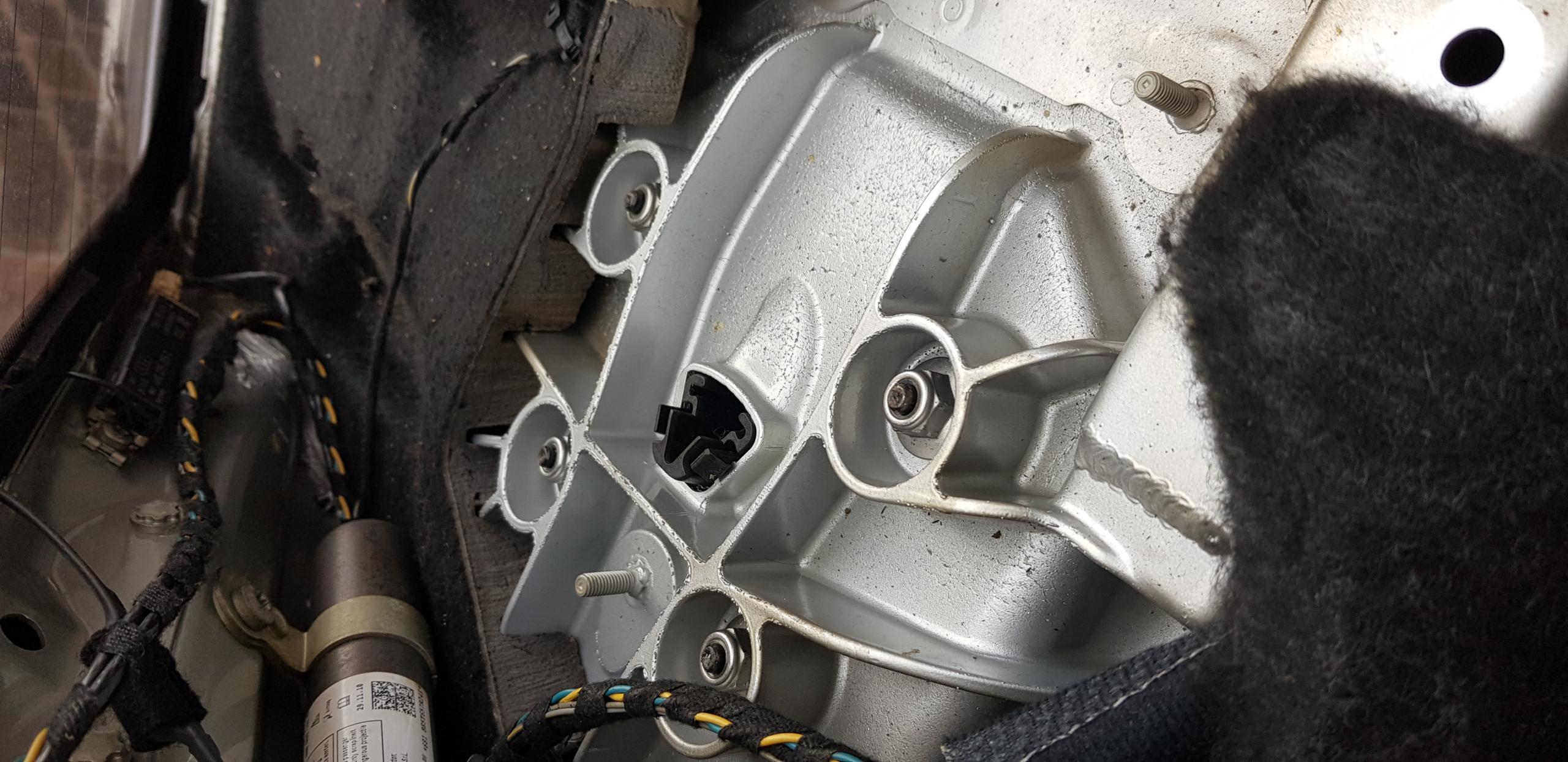

Had both my rear legs off at the beginning of this pandemic.
Took a day to strip the interior, removed the legs the next day, then put it all back together once water was emptied from both of the legs.
It wasn't too difficult (following Elsawin) just pottered about, took my time, and did it right.
Now i have dry(er) legs, i'm hoping my new valve block won't start sticking like the last 2.
