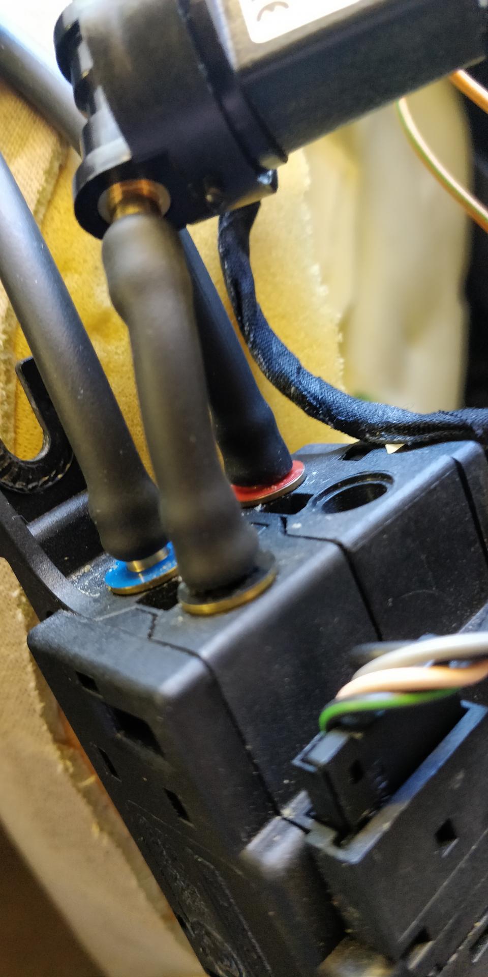

Update:
7 series e38 valve block appears to be suspiciously similar to the audi one, except they don't seem to have the cracking issue as the inlets are completley recessed in the plastic. I bought one to try and will let you know how it goes.

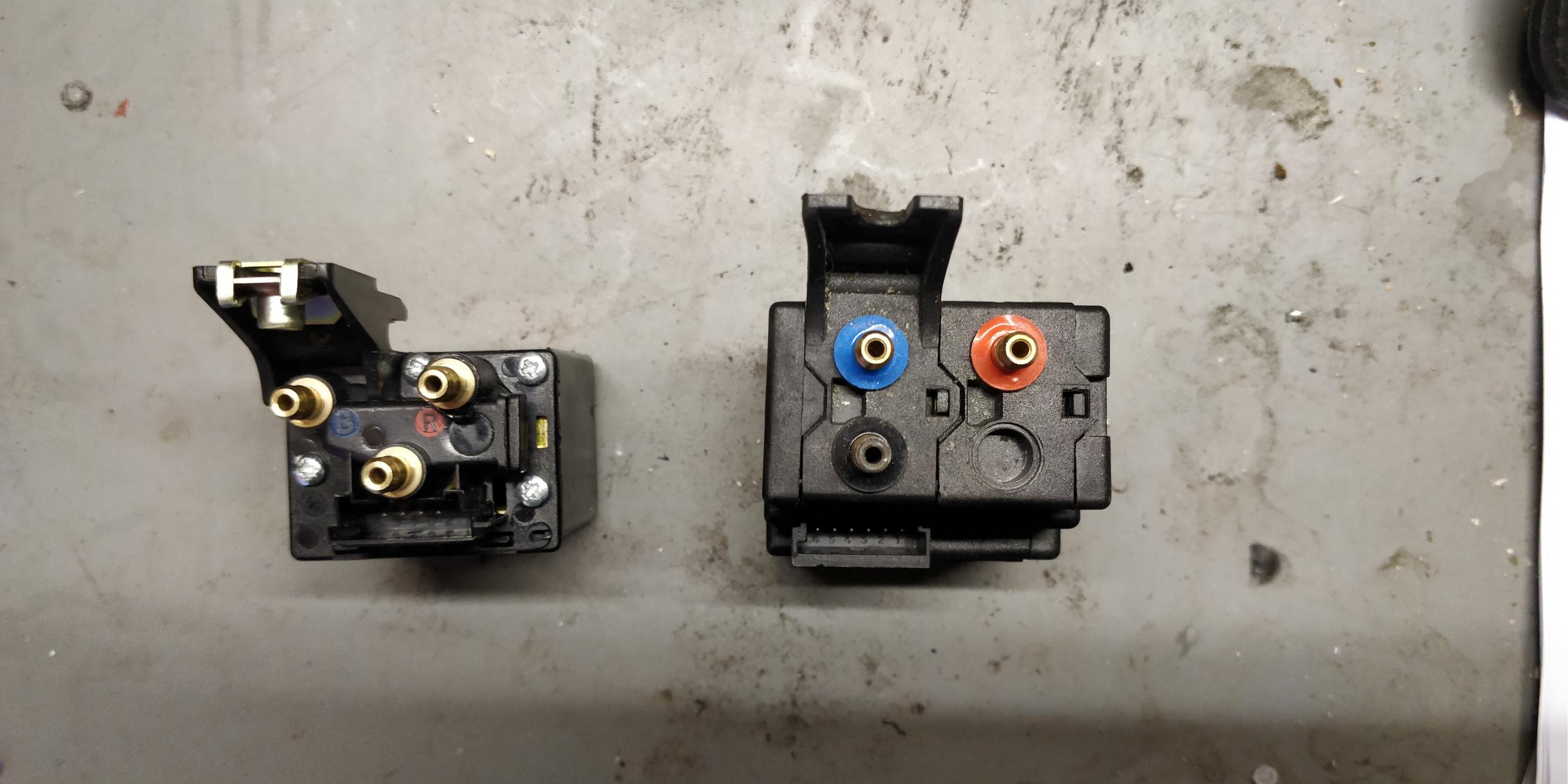

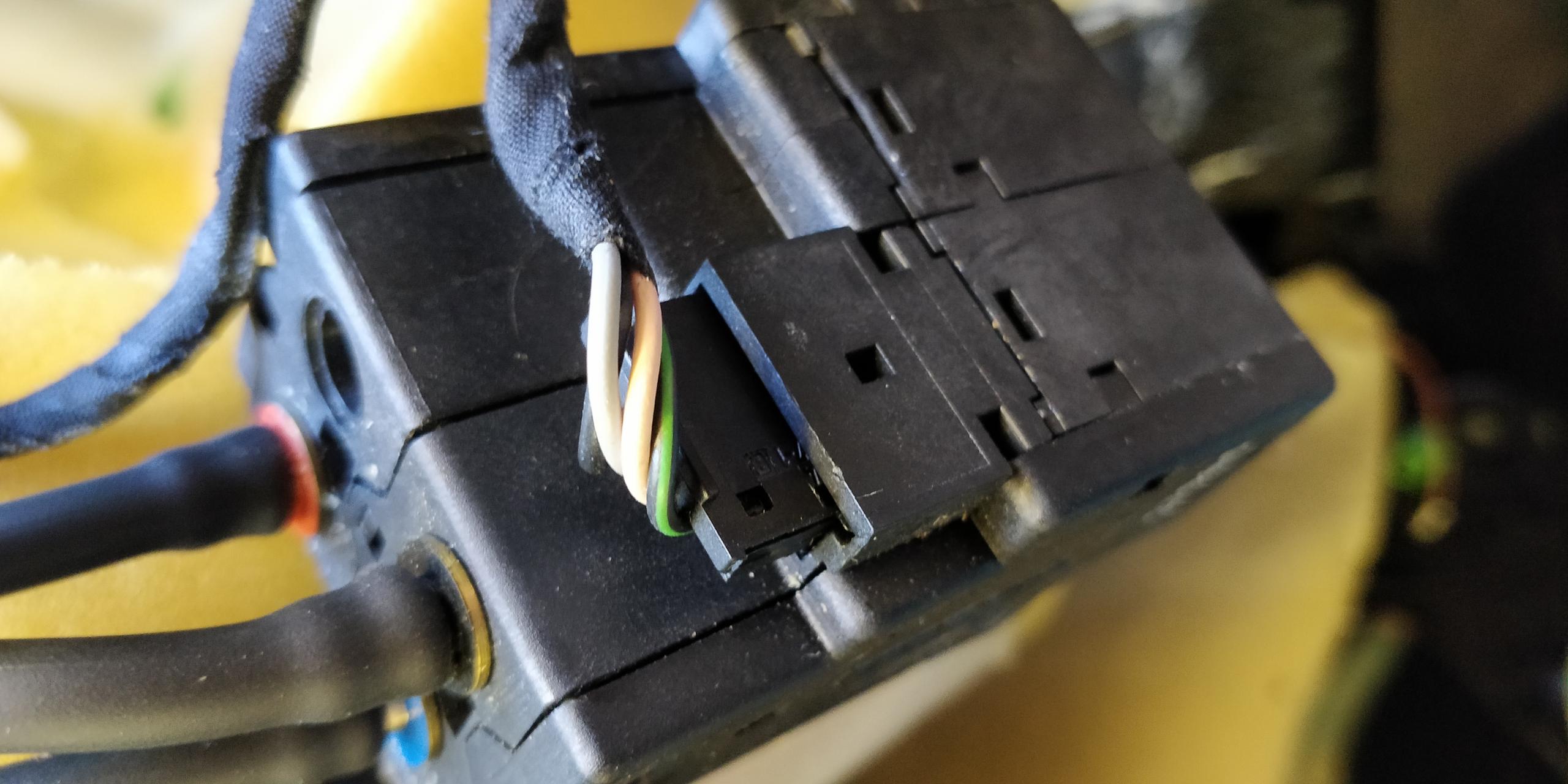

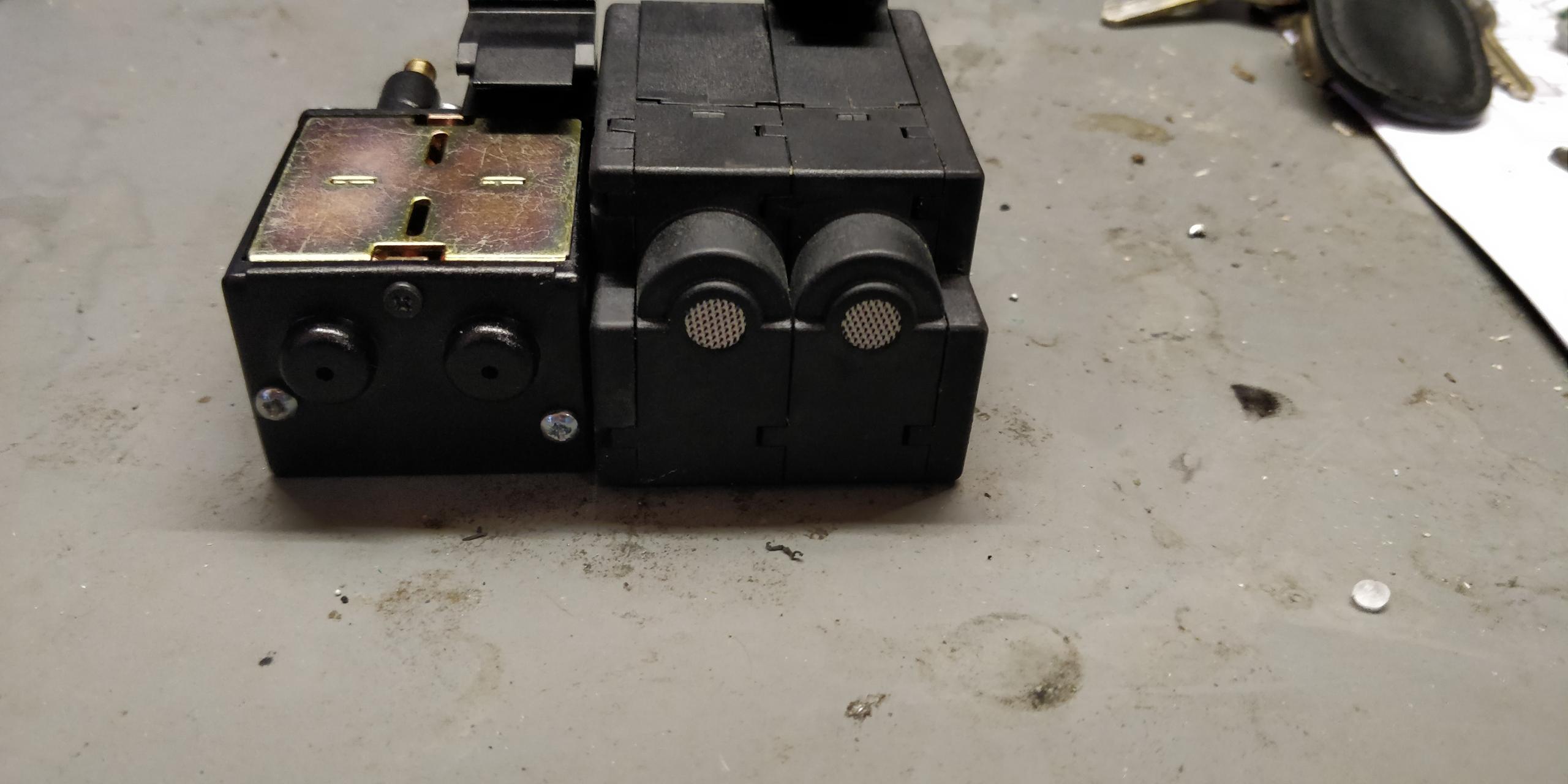

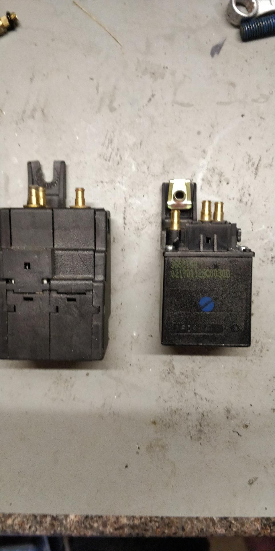

Default It works!
OK people, I'm glad to confirm that the above BMW valve block is a direct swap with the AUDI one and is a much better and sturdier design, even the mounting tab matches and the threaded clip fits the BMW part too. No modifications required at all, the plug from the loom in the seat fits perfectly too.
You should budget around 4h to do the first seat, 2h after that for the second seat.
There is no special tools required other than a zip slider to zip up and then staple the bottom of the back rest as it was done at the factory.
