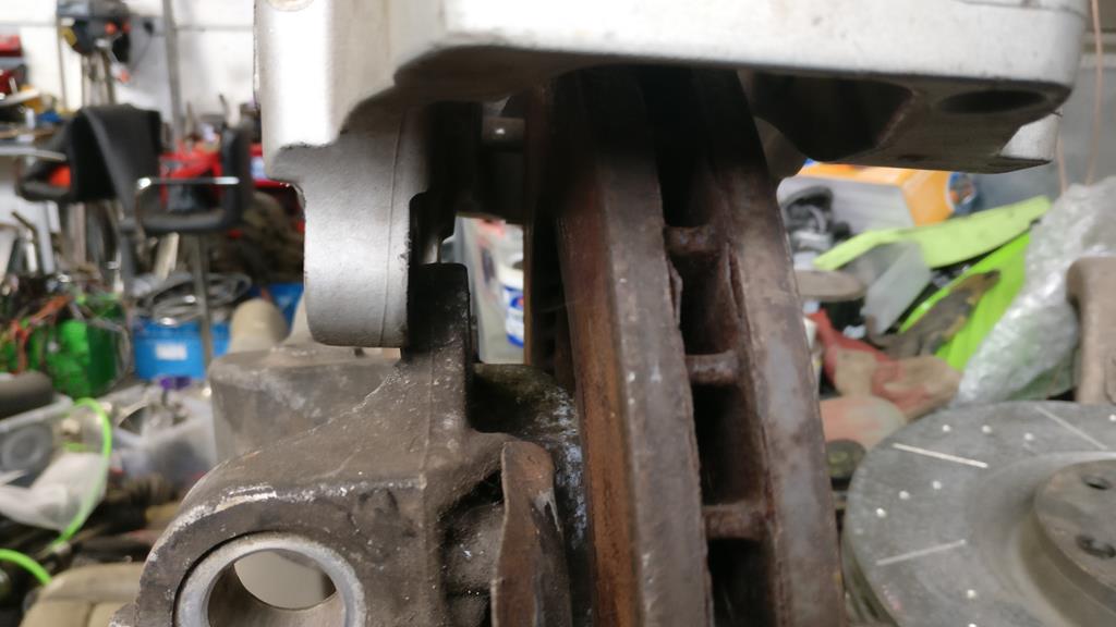

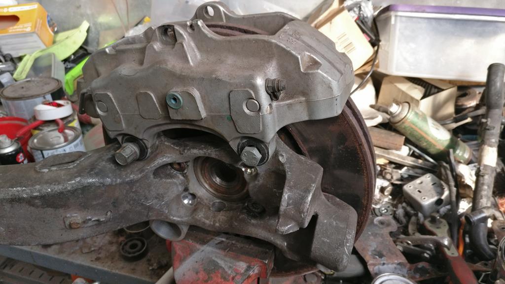

This is what I mean about the 18z calipers btw:
The caliper lugs and the upright lugs both occupy the same point in spacetime. There's nowhere to create a bracket.
However, this is the first time I've tried with a 345mm S8 disc, and its actually pretty close. I am going to try some C5 A6 hub flanges later which sit 6mm further inboard than the D2 ones, and it might just work. I feel that these calipers would be a worthwhile upgrade from the stock Brembos, even on the same size disc as they tend to work properly for longer, are lighter, and should give more even pad contact. I'm not sure they would be better than the 360mm D3 setup though, even with the associated weight penalty. I'd probably have to try both back to back.

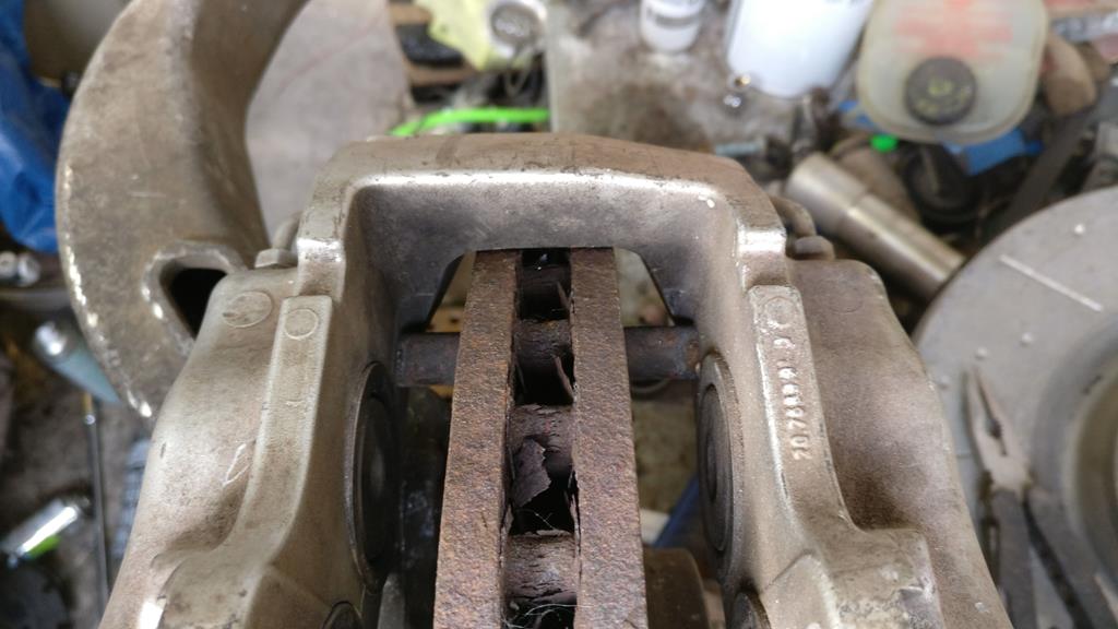

Sooo....
A8 upright, A6 C5 hub, OE S8 345mm disc:
To make the S8 disc work on the A6 hub (moving it inboard 6mm) means you forfeit the splash guard, and I think the hub needs a little 'lightening', although it is possible to offset the hub up to 2mm with a laser-cut aluminium spacer so that might be a solution. The 18z caliper fits fine with a spacer washer (maybe offset by spacing the hub) and the usual bolt adapter set with a sleeve for the caliper side. The pad may overhang the disc slightly (since its 2.5mm too small), although I've seen mention of using 17z pads in 18z calipers to solve that. Still, with M12 hardware it would be possible to move the caliper in a couple of mm.
That gave me an idea...
A8 upright, A6 C5 hub, D3 A8 360mm disc:
This also forfeits the splash guard and definitely needs a mm or two shaving off the upright, as it is exactly centred in the caliper as-is. Its very tight on the caliper and may need a little massaging of the caliper inner radius (or machine 2mm off the disc). Again, with 12mm hardware it might actually be possible to move the caliper out a little.
Alas, none of the lightweight discs I have are even close to fitting as the offsets are completely wrong. It could be done with custom alloy bells, but thats missing the point.
I'm not sure what the pad radius of the 18z caliper is so I've ordered the cheapest Q7 pads on ebay (£26!!) to find out. I will report back at the weekend when they are due to arrive

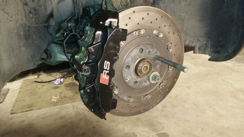

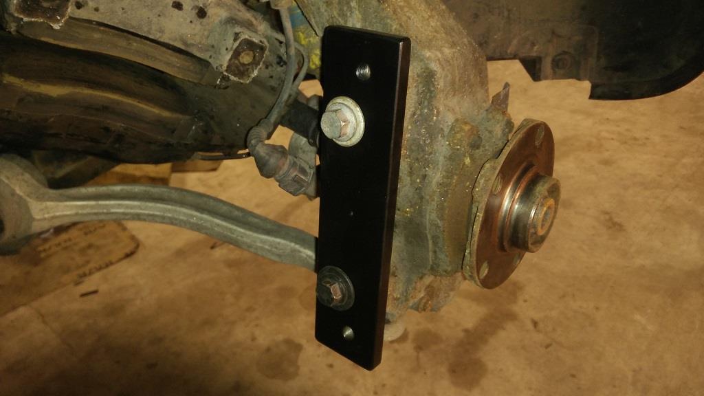

Thanks for info and pictures MikkiJayne . Curious if you have any pictures of the B7 RS4 brakes installed on a D2?
Pretty simple really. The adapter is just a piece of 10mm flat bar with four holes in it. Wheel clearance is an issue as the caliper is quite chunky and the disc is quite flat compared to the D2 stock disc offset. I can't remember if 18" Avus clear, but the 20" FE wheels need spacers. ET needs to be 30-35 I think.
They stop very well but these discs are very prone to warping and judder and, at £1000 a set, that can get expensive very quickly! This particular car is going to get updated to C5 RS6 discs which are non-floating 2-piece and which are both cheaper and more reliable, at a small weight penalty. They also have more disc offset so we can move the caliper inboard to make more room for wheels.
