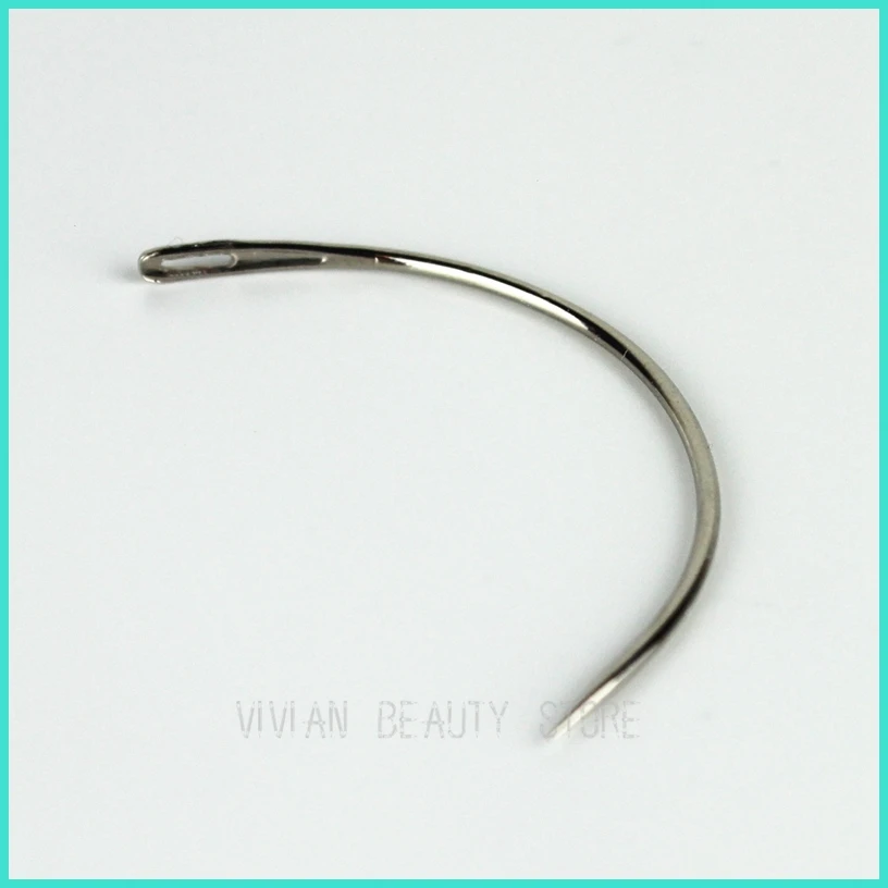

I suggest using a C shaped needle for the job haha.

And put the seat back together, sewing the zips you opened with a needle like this:
