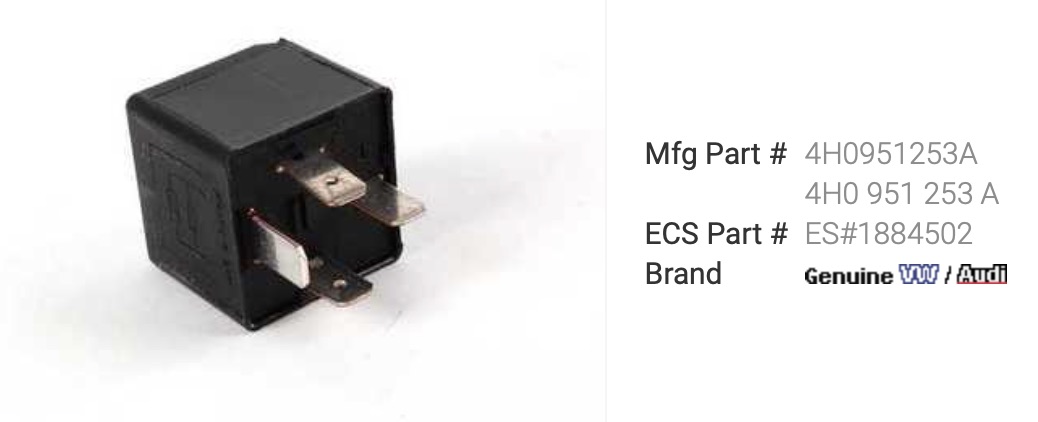

Two years ago my car wouldn't start after driving 300m or so. Audi first figured the fuel pump was no longer working. Turned out it was only a general purpose relay that was faulty, 4H0 951 253 A.
Could this cause your symptoms?
The relay is very inexpensive, I paid SEK 205 for the part.
On LHD cars, the relay box sits on the drivers side, opposite the ECU on the passenger side
