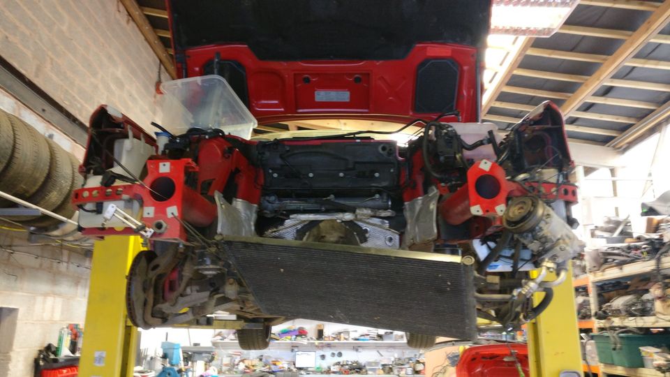

After retrieving BR from storage, I noticed a shudder in from the gearbox in D around the point where the converter clutch should lock up. Whilst studiously ignoring this and driving everywhere in S, reverse then stopped working too. Reverse was just an F125 fault as it could be persuaded to work by holding the gear stick in a particular position between R and P. I have a box full of repaired F125s so I thought I'd spend a couple of hours on Saturday swapping that over, and pretend the shudder was just my imagination.
But, as I mentioned waaay back at the beginning of this thread, the V6 is a packaging horror compared to the V8, and on the FL2 2.8, the upper cat is in the way of the gearbox mount which in turn is in the way of the F125, so the downpipe has to come off. It was about this point where everything went very very wrong:
Yes, thats a snapped stud There is no way that can be repaired in the car so...
that escalated quickly At least it wasn't oily this time.
Once the engine was out I was able to safely apply some heat to the other downpipe nuts and they all came off without too much of a fight, and then I could get to the F125:
The usual burnt contacts, but this time only on the reverse terminal for the TCU. This can be cleaned and recovered and put back together, but I'll use a known-good one from stock in this instance because I don't want to be taking it apart again.
Since the gearbox is misbehaving, and its now on the floor, I might as well replace it

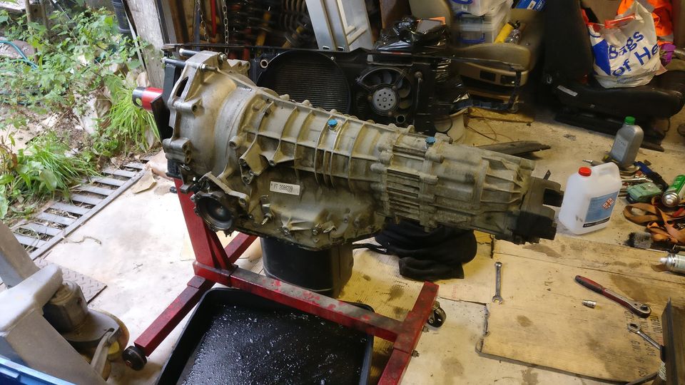

A 100k mile 5HP19, so only 2/3rds of what the current one has on it. It was a very sensible price too, on the basis that no one (else) is daft enough to go to the trouble of swapping the gearbox in a 2.8 A8 these days
I'll service and re-seal this before it goes back in of course. It had never been opened since new.
Very clean inside:

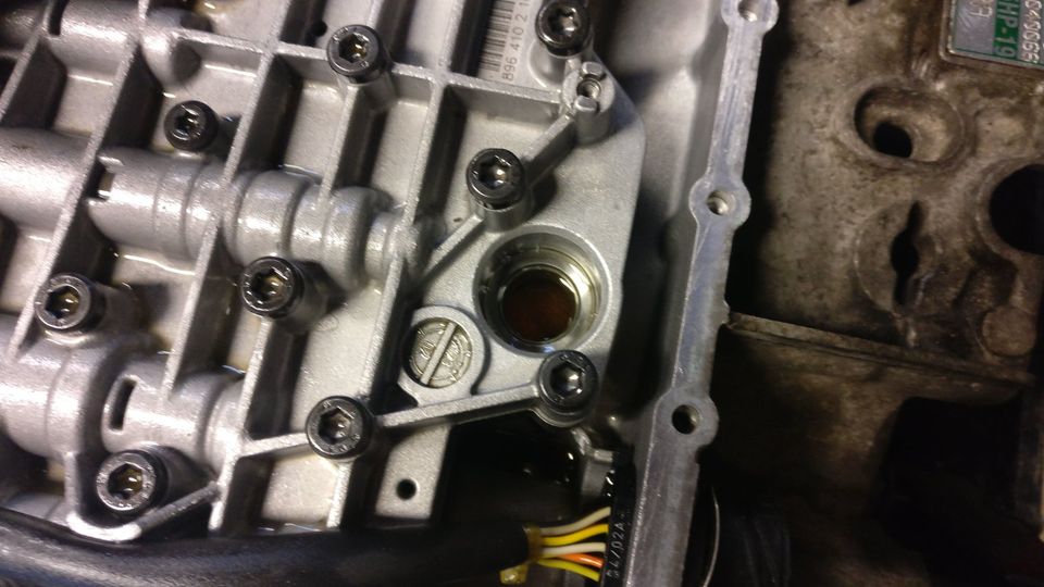

When the filter is removed with the gearbox in the car, the oil drops out of the oil pump pickup. This means that when it is refilled and started up the pump briefly sucks in air before it can pick up any oil. While it is expected behavior given the design of the gearbox, these things are so fragile they need all the help they can get so while its upside down I will prime the oil pickup and the filter with fresh oil.
As Prestige no longer had the converter which came with this gearbox I sent BR's original off to JP Automatic Transmissions in Bristol. They reported back that the lockup clutch piston seals had perished and the clutch friction material was badly glazed so that has been refurbished and is on its way back.
So, there was never anything wrong with the actual gearbox in the end. But, since it had to come out of the car to get to the broken F125, and be removed from the engine to get to the worn out torque converter, I'll take reducing the mileage on the gearbox by 1/3rd for what the replacement cost.
An oil change 3 years ago may or may not have averted the converter seal failure - its impossible to know. On thing is for sure - D2s do not like sitting about. They need to be used or they will go wrong out of sheer boredom!
Well, maybe two things are sure. 'It ain't broke so don't fix it' does not apply to 5HP gearboxes. It ain't broke yet so fix it before it does break.
