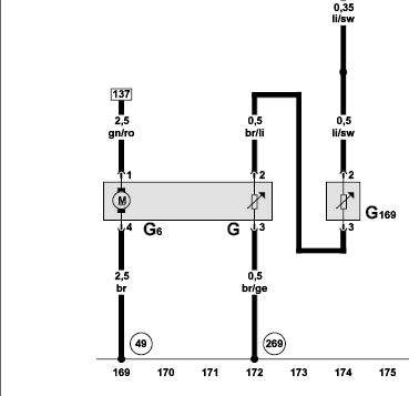

Now does anybody have a wiring diagram so I can check the 4 wires or what I should be reading? I have also been going through the Fuel Supply systems test on the Service manual and not got much further with that also.

When you switch the ignition on you should hear the pump running for a second or so, but it can be very subtle especially with a new one.
Pump power is on the large green & brown wires on that connector. The two small ones are for the level sender.

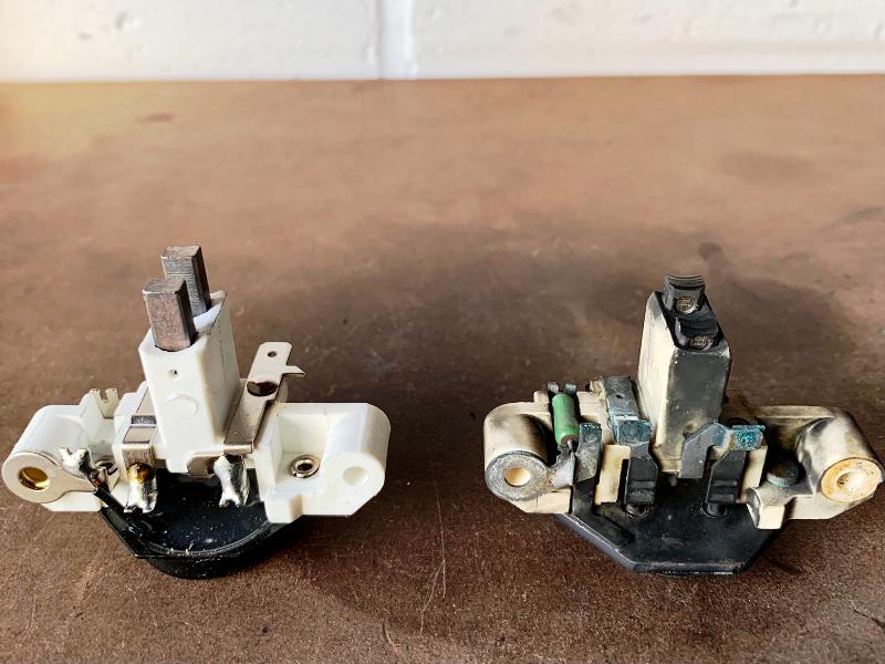

Evening all, a fun day underneath the car tinkering with it.
Replaced the regulator in the Alternator, and indeed 100% fixed that problem so thank you for that. No red battery light on dash and well over 14v being put back into the battery when the car is running.
Can you tell which is the old one....
Though getting the alternator back in, lined up and bolts in is a little fiddly.
