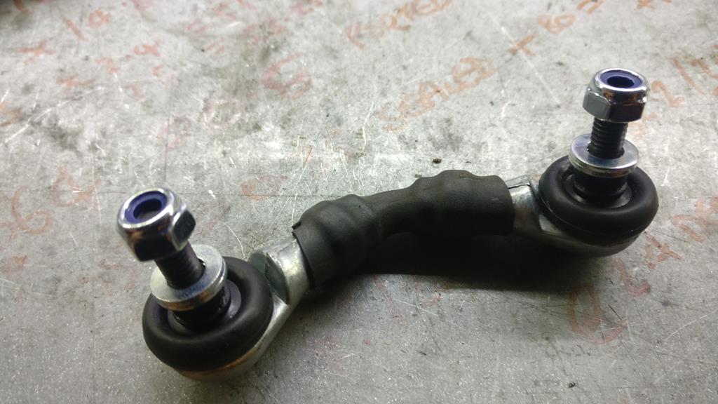

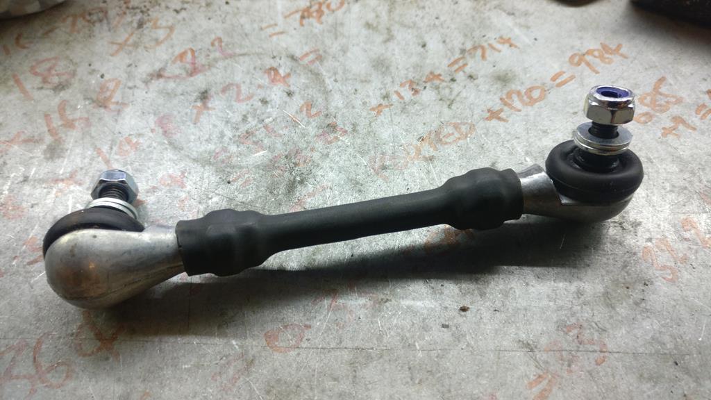

They are made from M6 rod ends from McGill Motorsport, some M6 threaded rod, and a couple of M6 plain nuts as lock-nuts. The threaded rod is covered in heatshrink to keep the weather out.
Front - this uses an 80mm piece of M6 threaded rod
Rear - 50mm threaded rod with a bend in the middle

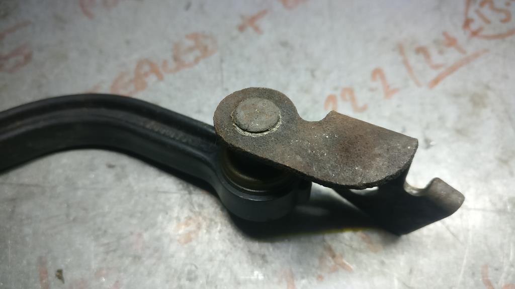

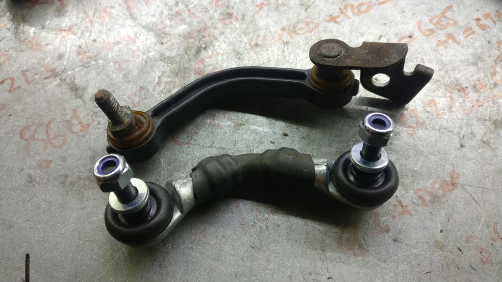

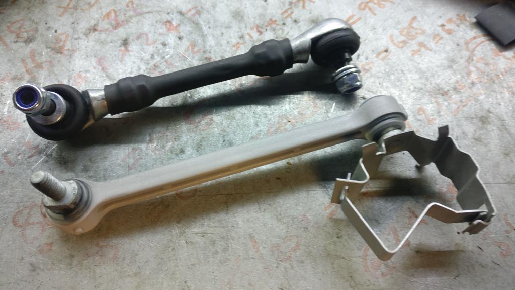

Compared to the originals

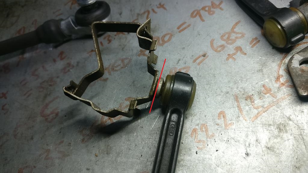

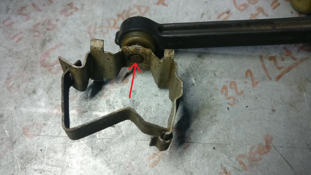

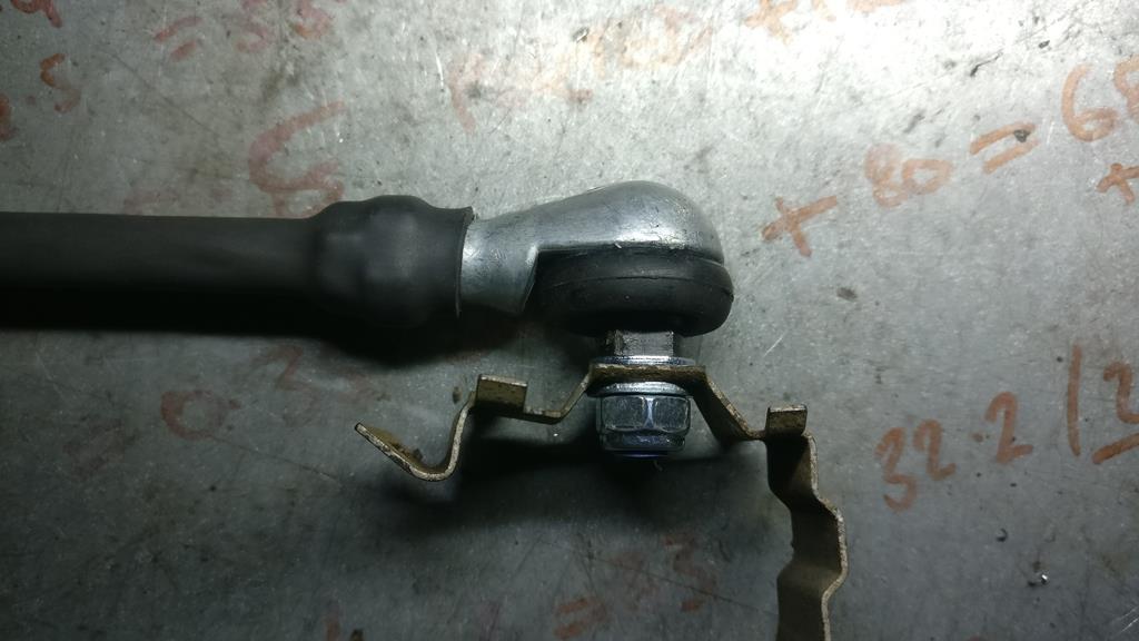

The new links require the old brackets to be recovered. We need to remove the ball at this rivet-joint

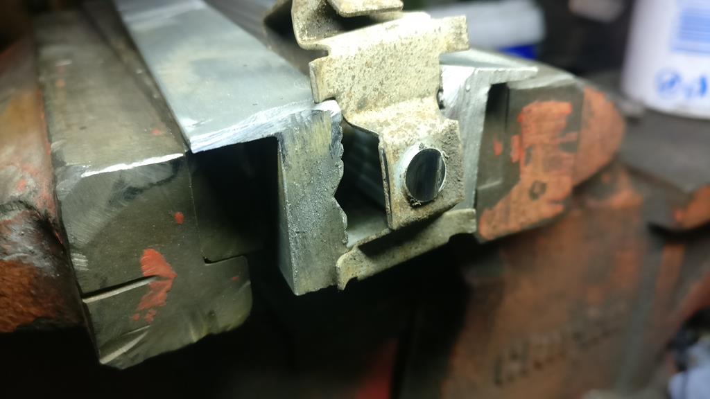

Cut off at this stub

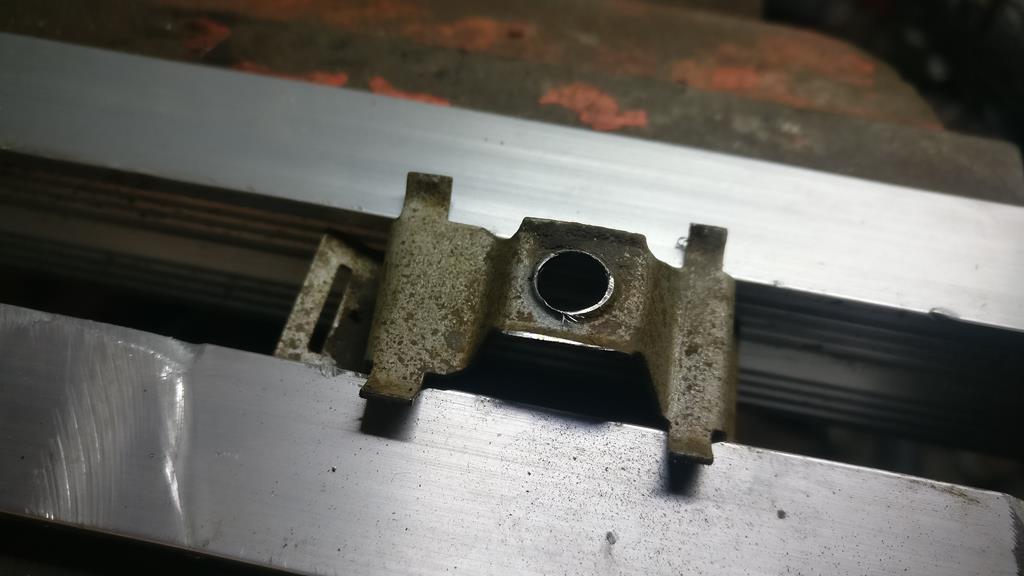

Punch out the centre
Drill to 6mm
Secure in place using an M6 nyloc and two washers. Note the stub of the balljoint needs 4 threads removing in order to clear the control arm - just enough so the nyloc still grips
Exactly the same principle for the rear bracket
