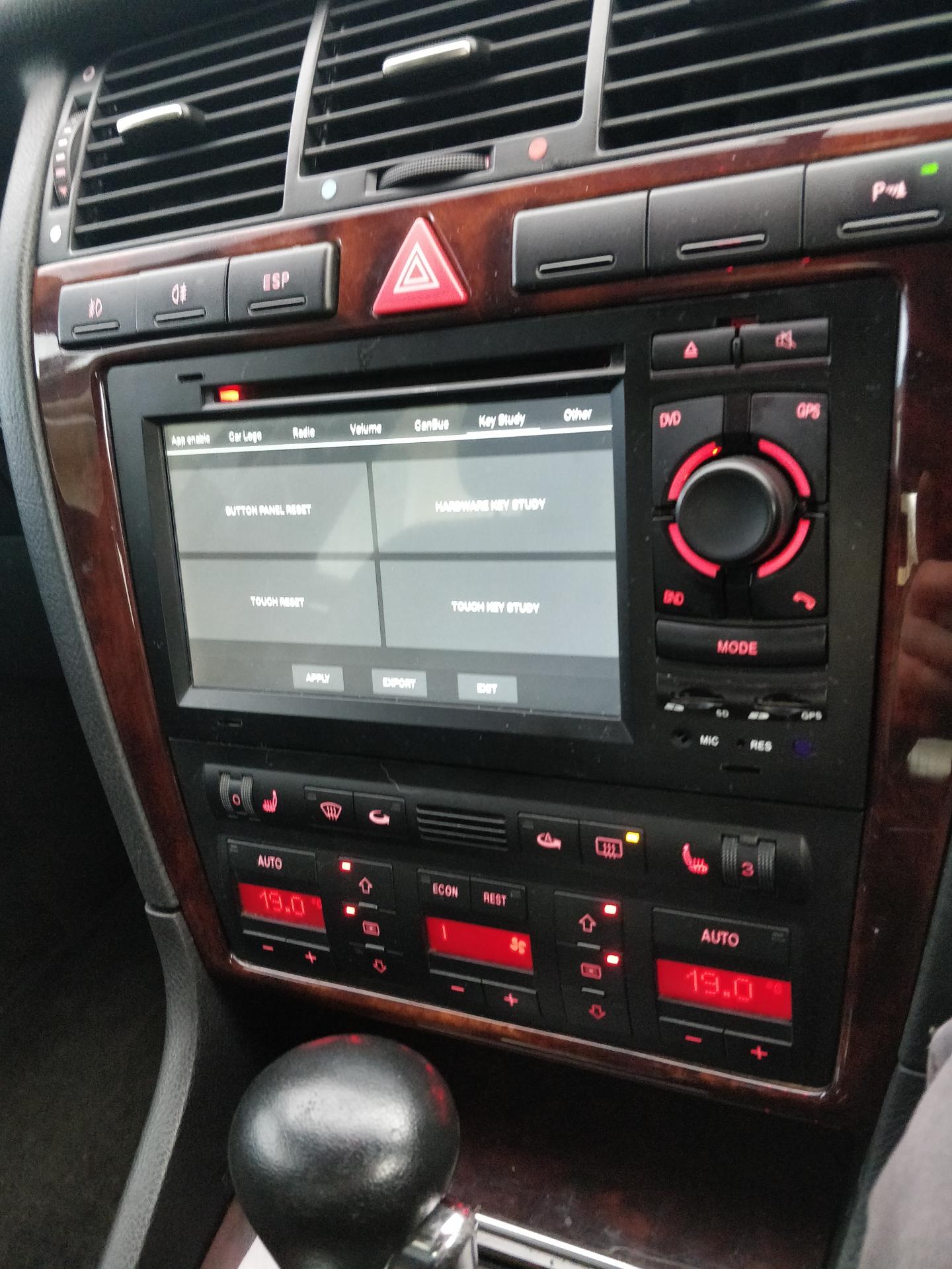

A little update for you all
the code for factory settings on this head unit is m123456
It allows you to mess with all kinds of settings like CANBUS options, or teaching the HU your steering wheel buttons.
I'll be trying to get a noise cancelling app installed on this radio, to see if it'll make the cabin noise much quieter, it works the same way as those fancy noise cancelling headphones, playing the opposite frequency of the 'noise' to cancel it out.

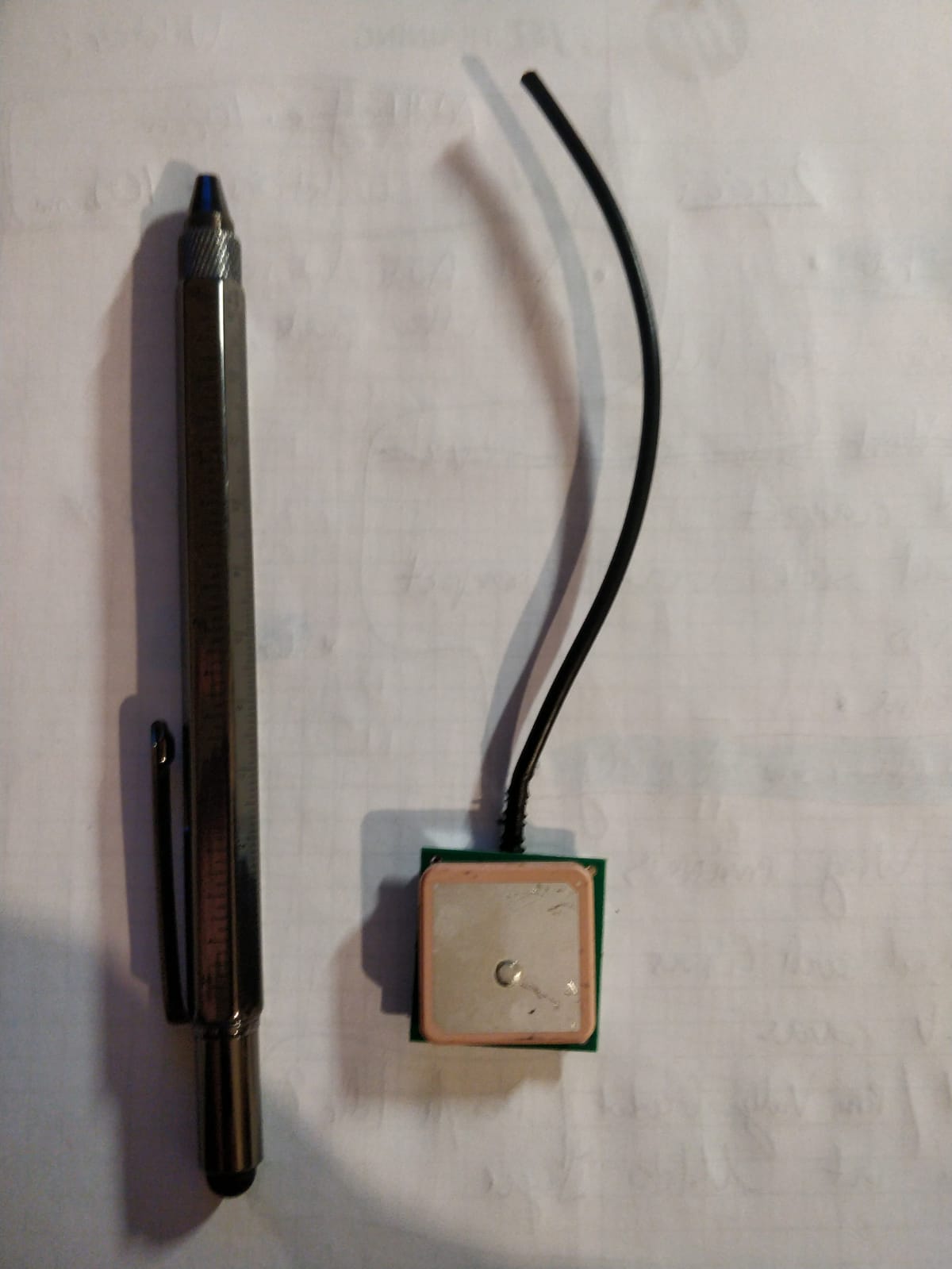

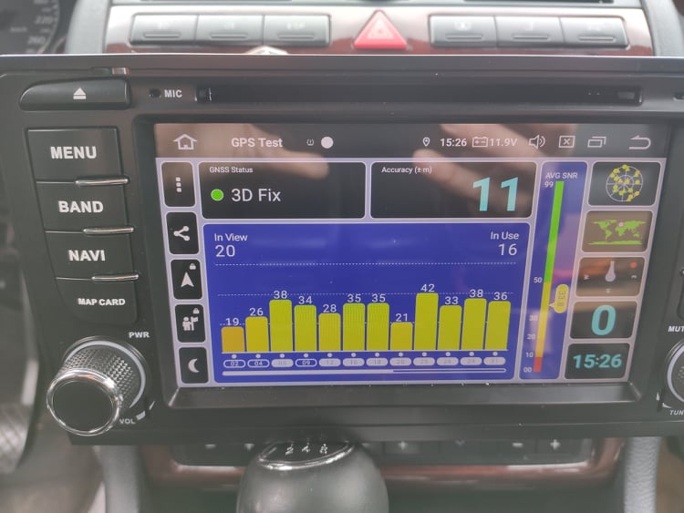

Minor update:
After talking with other Android HU users on the internet it was found out that if we remove the GPS antenna PCB from its casing, and install it in the gutted A8 antenna box located in the rear the GPS signal will improve significantly so I'll be trying this tomorrow, I already have the android gps antenna removed from its casing.
