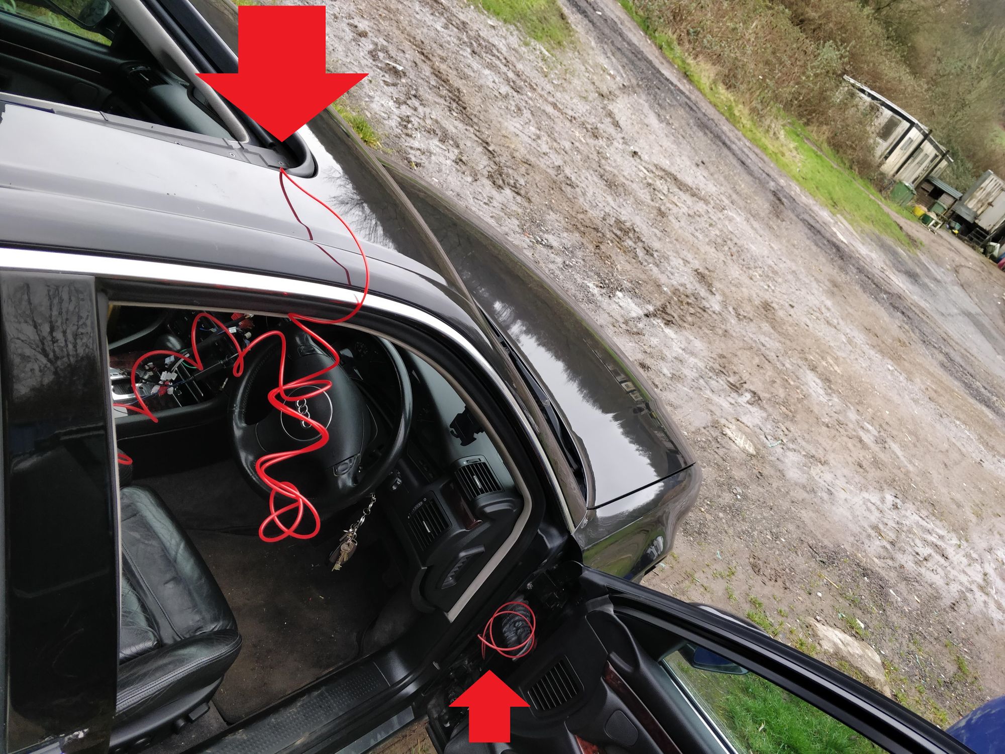

Who is the idiot that decided it is a good idea to have the front sunroof drains above the door hinge?! For a premium luxury car that was a STUPID idea!
Any tips on clearing out the rear sunroof drains if you don't have shop air to blow the lines clear?
3mm trimmer line

What's the best way to use the 3mm trimmer line for the rear sunroof drains?
Old 7th January 2021, 05:27 AM
Ronin Ronin is offline
Join Date: Jul 2019
Location: Wales
Posts: 847
same as the front?

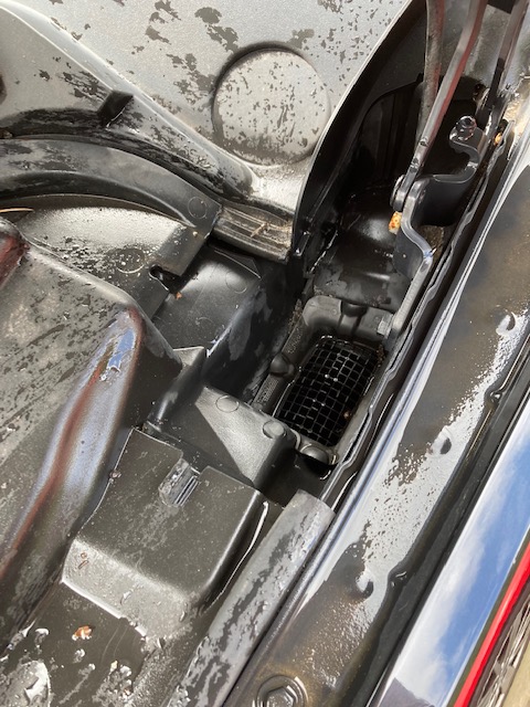

Yesterday I was chatting to a neighbour who was cleaning his 3-series BMW; he'd just discovered an unknown (to him) feature. I had to take a picture!
The scuttle drains flow off each side to near the bonnet hinges to a pair of filter baskets that are designed to catch leaves/debris and can be easily removed by hand for cleaning/clearing.
If only Audi had thought of that.....
