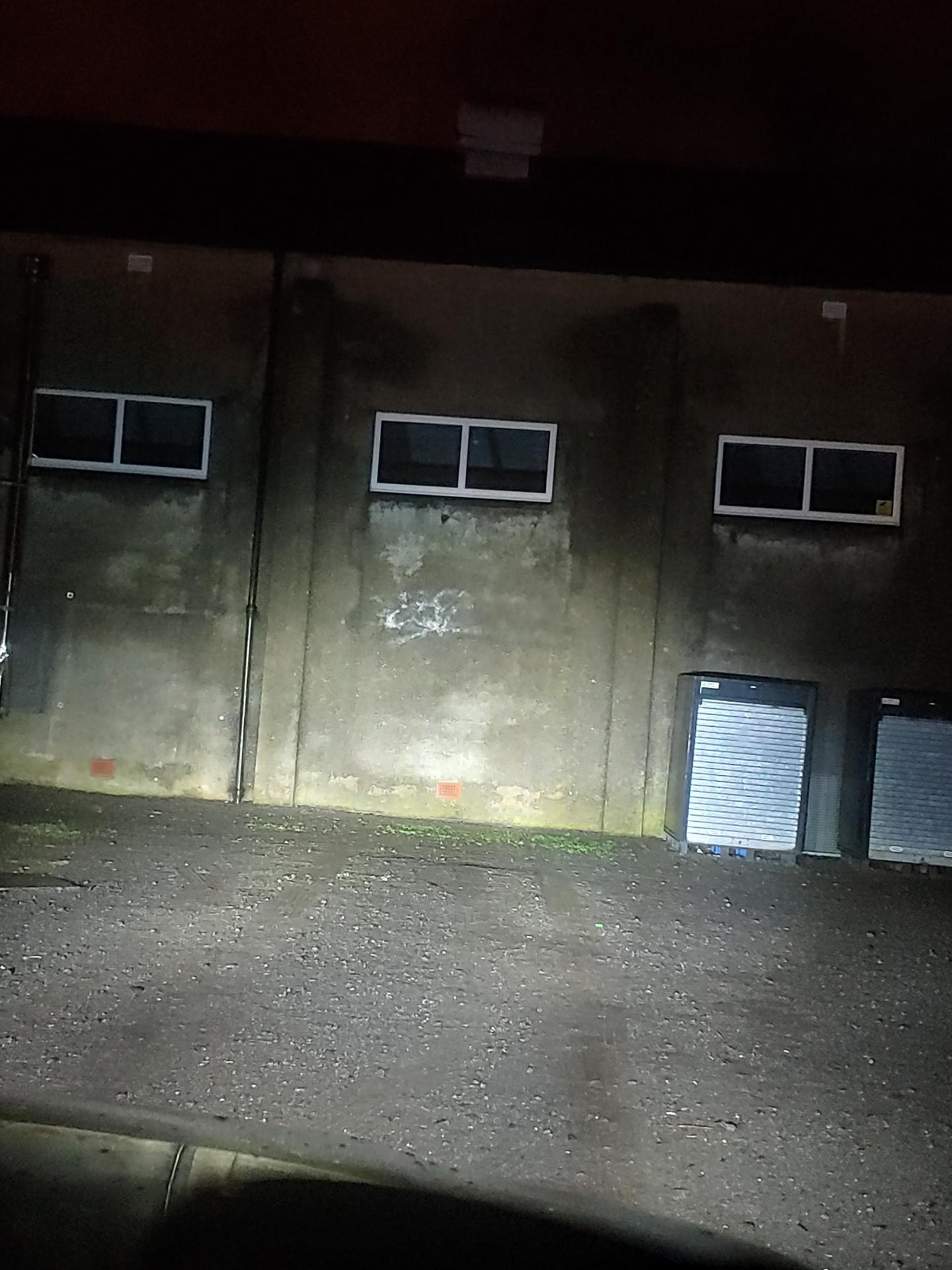

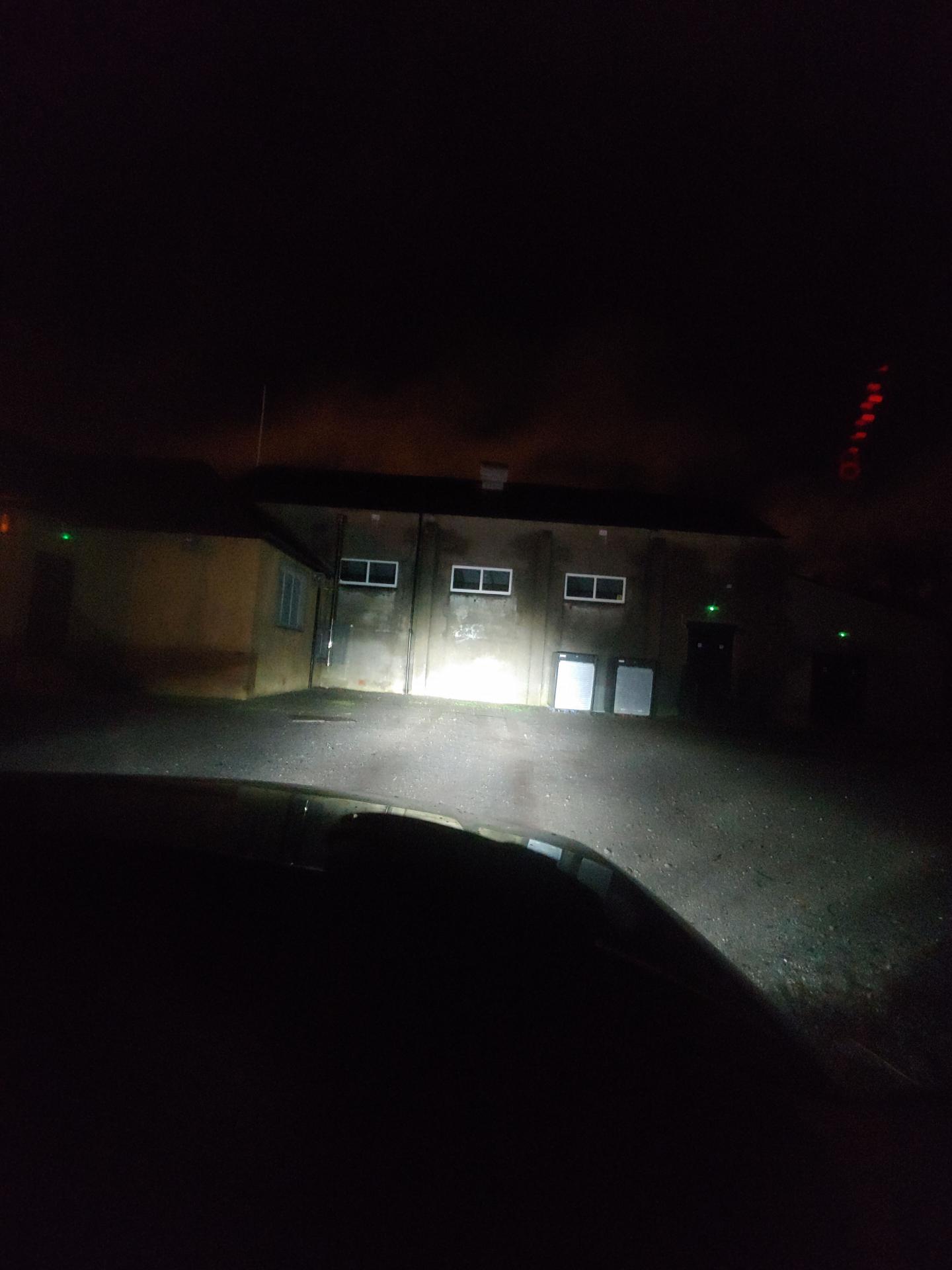

The yellowy main beam however has been a niggle ever since so I recently took a punt on these eBay H7 LEDs and am very, very impressed over stock. And now everything up front, except the fogs, is nice, white and bright. Did a bit of research and although the claimed 6,000 lumens is a bit dubious, the measurements seemed like they would fit in the housing okay and the fact that the main beam isn't ever on for any real length of time I concluded that for £20 the passive cooling instead of fan cooling ought to be okay. It all fits inside and the cover closes completely.
Main beam flashing is also instant and immediately bright which is a definite bonus. Especially if you like a bit of flashing of an evening
The attached pictures are the 35W HIDs on the 55W ballasts and then the LED high beams. About 30m in the distance pictures and 10m closer up. Just thought worth sharing if anyone is considering an upgrade on the main beams and unsure if worth the trouble. I certainly think it's been worthwhile.
Maybe worth mentioning that I did an outer lens refurb back in summer and, while that no doubt adds a bit, I think the main light output improvement is down to the 55W and the new LEDs. LEDs in the sidelights make up the white front-end package nicely.
ID:	25167   Click image for larger version
ID:	25168   Click image for larger version
ID:	25169   Click image for larger version
ID:	25170   Click image for larger version
