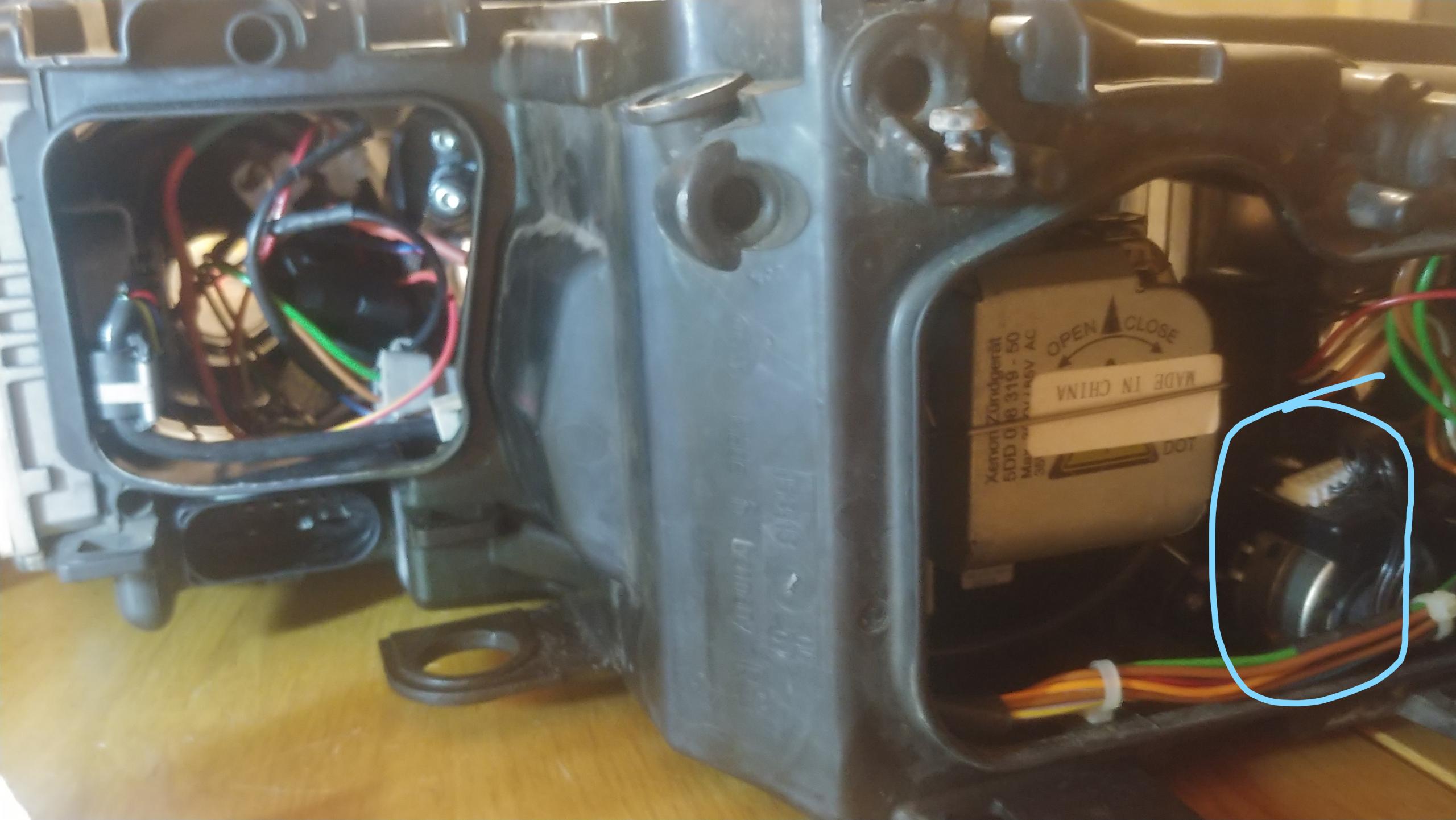

Originally Posted by GH77 View Post
Can we even get adjustment motors for the D3 headlights? .
Actually, I'll answer my own question there. Yes, we can. 4F0941293A (No9 in the diagram) and it looks removable from the back of the housing so no need to take the front lens off like in the D2. Would need to drop the bumper and remove the headlight though.
