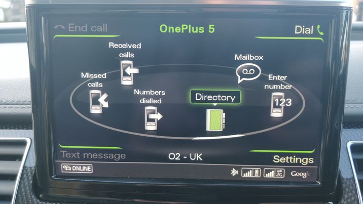

Can anyone help with this small problem that i have ( no not that one ) When using my phone in the car my text messaging is just greyed out and messages are not displayed on my screen. I am using an Android phone and have just tried my sons Iphone and that does the same. Is this feature supposed to work ?

It'll be greyout if you are using the standard bluetooth audio/handset to the phone (most common)
For it to work, you'll need to have a sim in the dash so the car is the phone, or you will need to use rSAP to connect your Sim from your phone to the car, so again, the car becomes the phone.....
rSAP works on a handful of androids, most Samsungs notably, but no iPhones...
