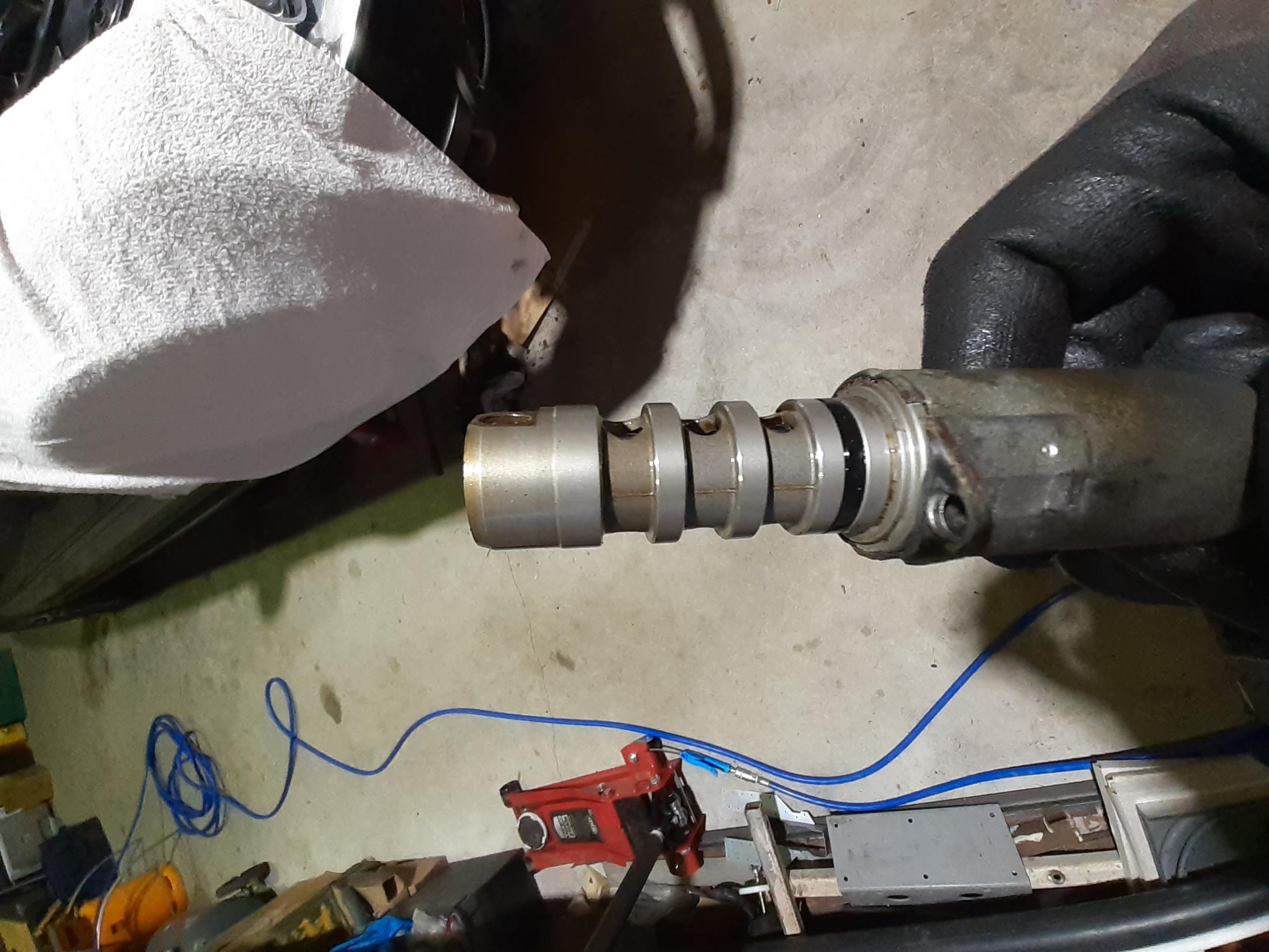

Do the vvt solenoids have one O ring each ? Thanks

Correct,that's a pic of one i took out to change oil ring ,i had difficulty getting them out as I didn't want to grip them with pliers so I very gently levered with a screwdriver whilst turning back and forth and pulling them they came out

Thanks S81 appreciate your help, today I fitted a new right side rocker cover which comes with gasket, also replaced o ring on one solenoid one which fits in through the cover but still have oil leak, after closer inspection looks like it’s coming from around the solenoid housing so the o ring a purchased from eBay must have been wrong size. Will have to go to local dealers to get correct o ring.
Just to add the inlet solenoid seems fine/dry
So didn’t see any point in touching that.
