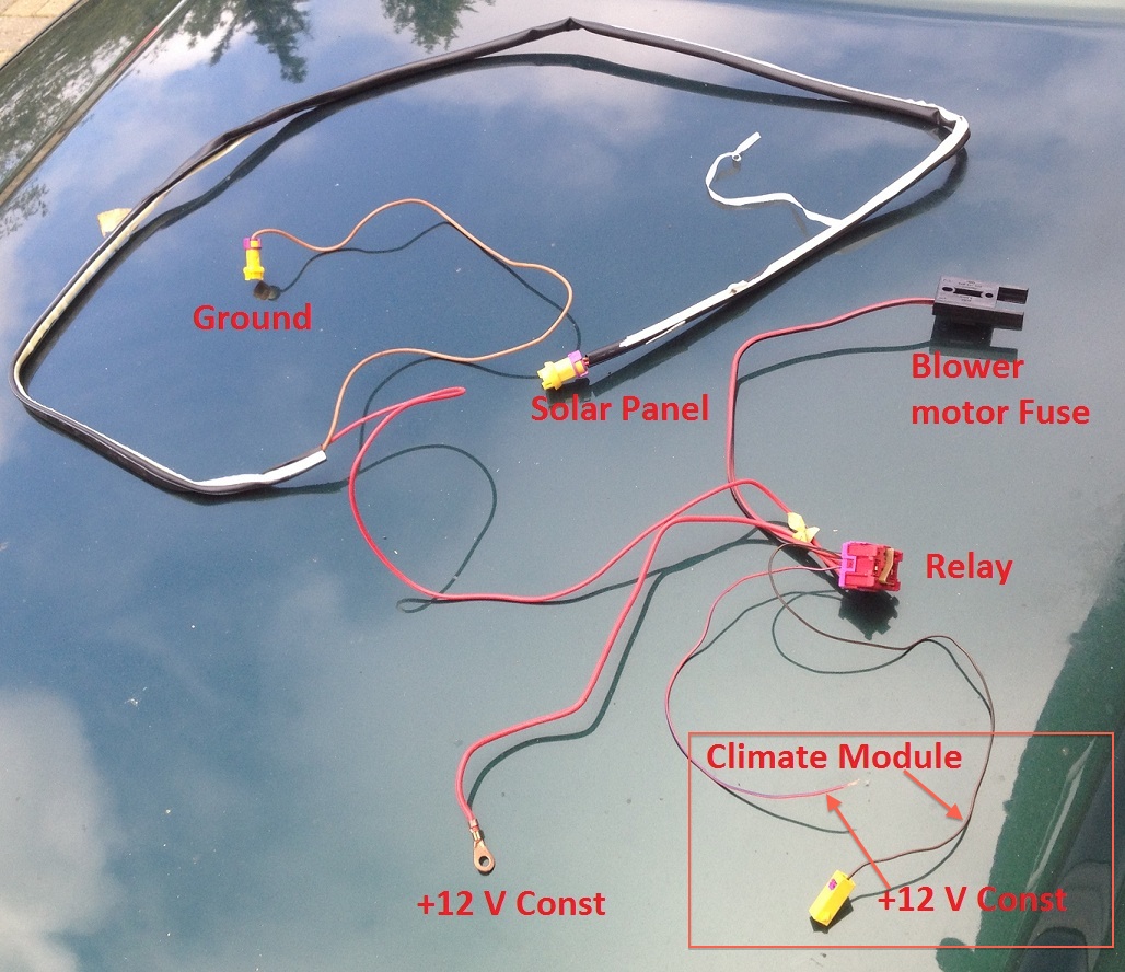

Just correcting an error on the first picture where the cables should go:

connect these 2 earth connections together, one from the solar panel, and one on the car
