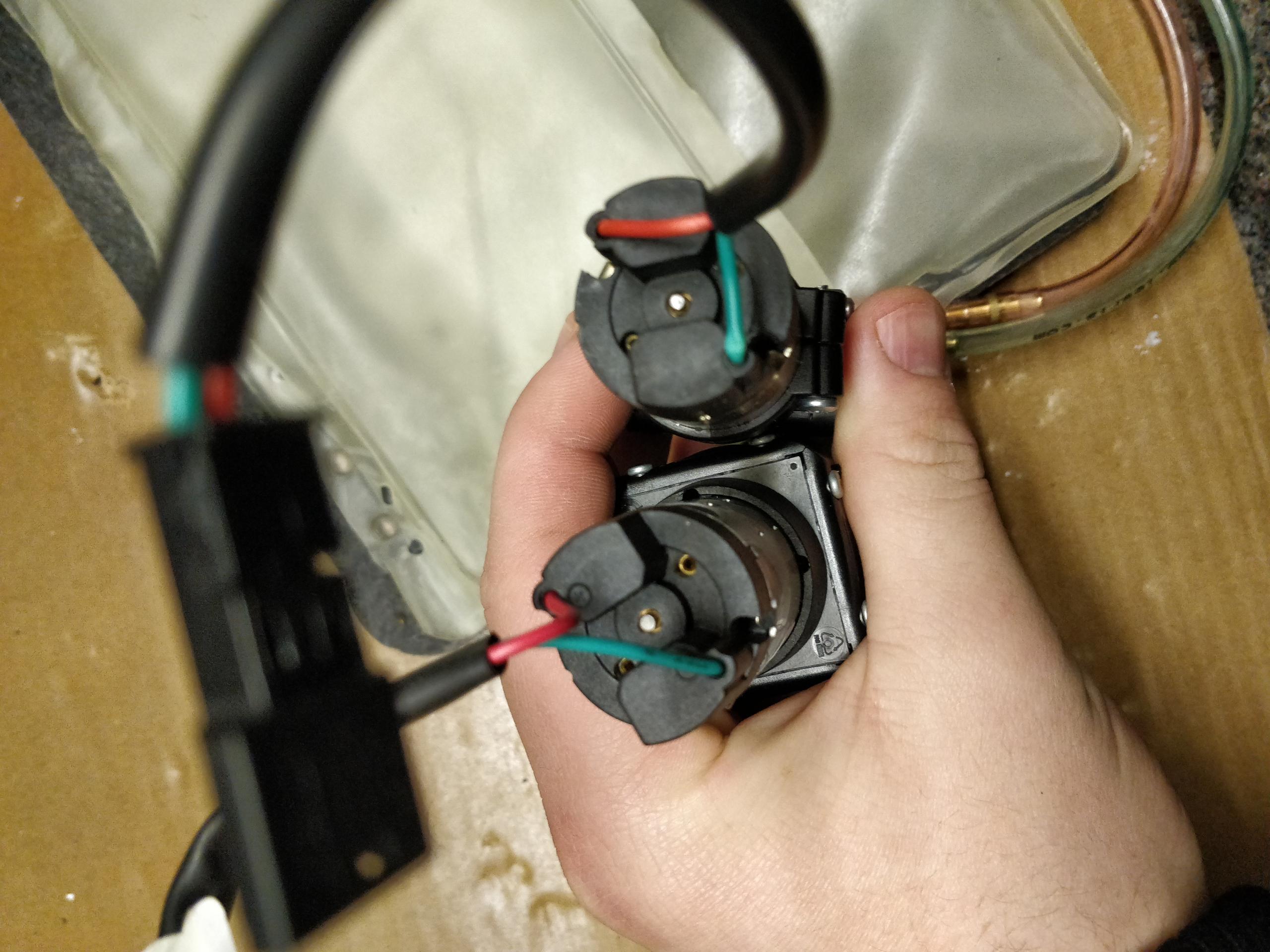

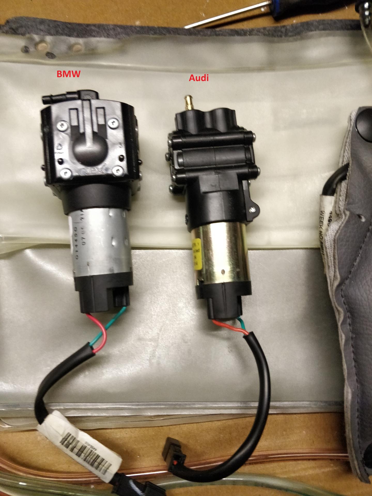

Update - now the pump/compressor has failed.
And yes, you guessed it, a compressor from BMW e60 with 4 pistons instead of 2 like in D2 fits plug and play and works much faster and quieter.
Part code: BMW 7039191.
