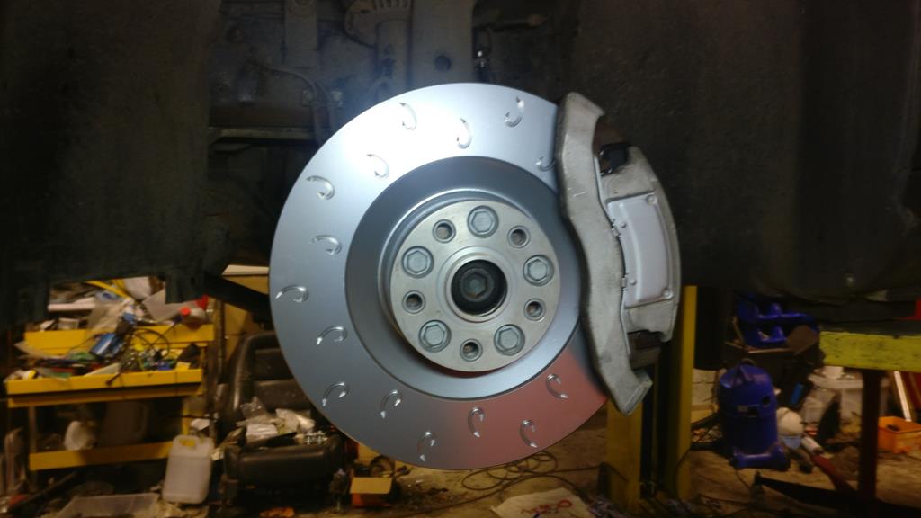

Tell us about the choice of MTec C-hook discs please. My rear discs will need replacing soon and I’ve not come across these before. And what’s the caliper on the front?
  #82
Old 25th February 2021, 08:27 PM
They look good... Also the c-hook grooves perform the same function as the usual linear grooves (dissipating gas and friction material build-up under the pad surface) but without the noise, as they are a less regular pattern.
The rears are 280mm D2 S8 (from 269mm originally). The fronts are 360mm D3 2-piston sliding calipers (from 323mm).
The D3 front calipers are a straight swap for the D2 A8 HP2 caliper and are a much better design in every way. One of the few uses for the D3
Looking good is a perfectly good reason for fitting them!
My MoT today was all fine but for an advisory on slight pitting/grooving of the rear discs so that looks like a reason to investigate these

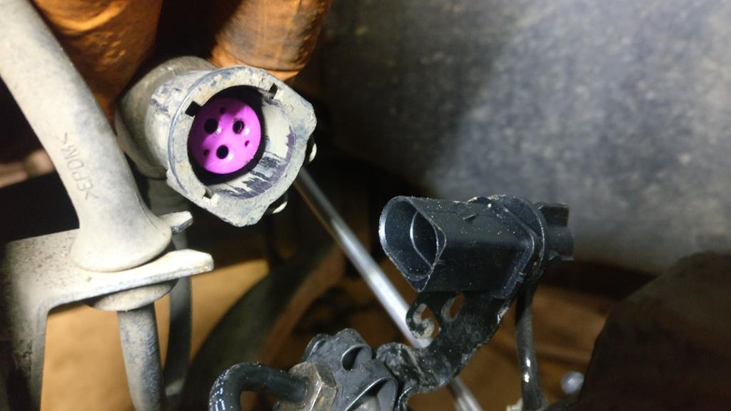

The front brakes are now complete, also with Mintex pads and braided hoses. These calipers are a joy to work with compared to the HP2s
This is the only bit which isn't plug and play - the pad wear sensor. I have new connectors and terminals for this which I will crimp on to the D2 wiring for an OEM-quality job.

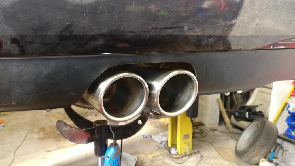

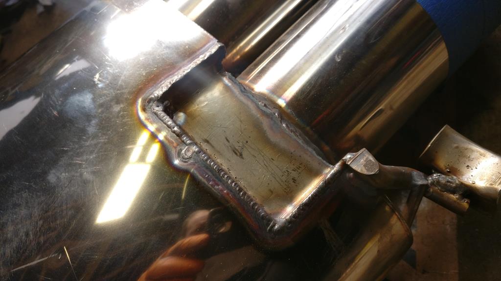

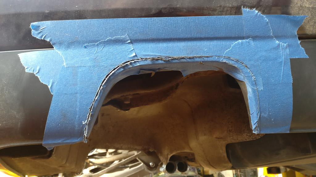

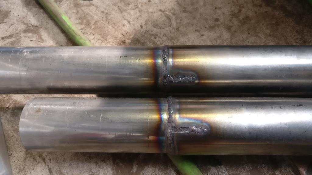

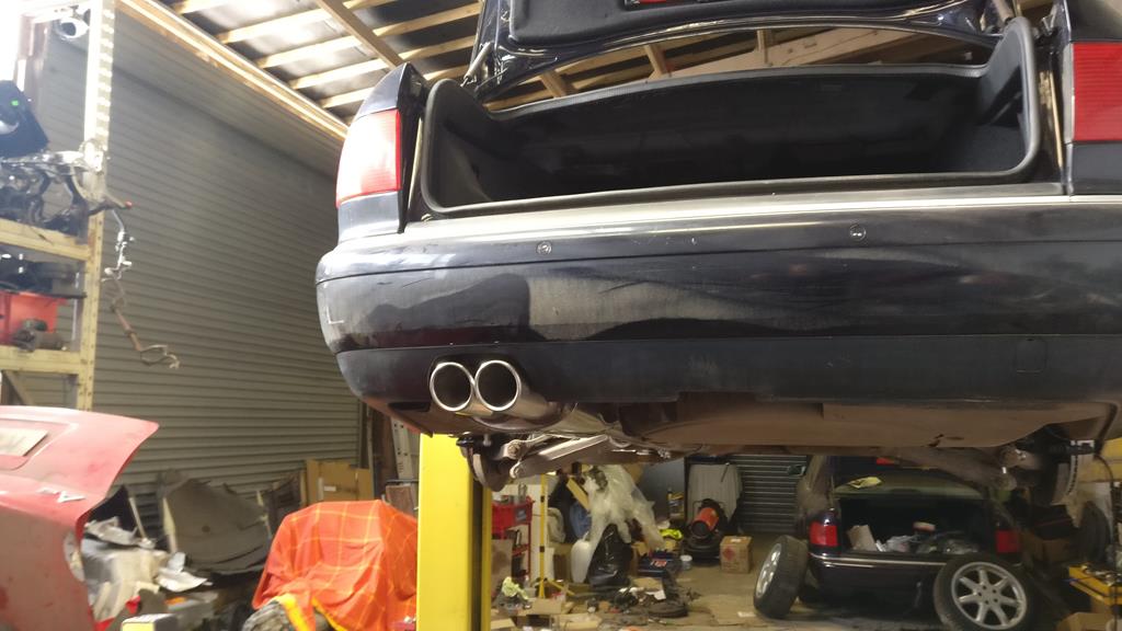

Spent this morning on the exhaust - the modifications to it have been tig welded
This is the 2x90mm version (same as Vera's) which needs the bumper cutting, whereas my S8 has the 2x70 which doesn't need any modifications
There's about 4 hours work to get to this point The hangers were miles off so needed considerable modification in order to get it to sit straight
Looks good though, and sounds lovely

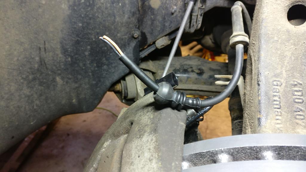

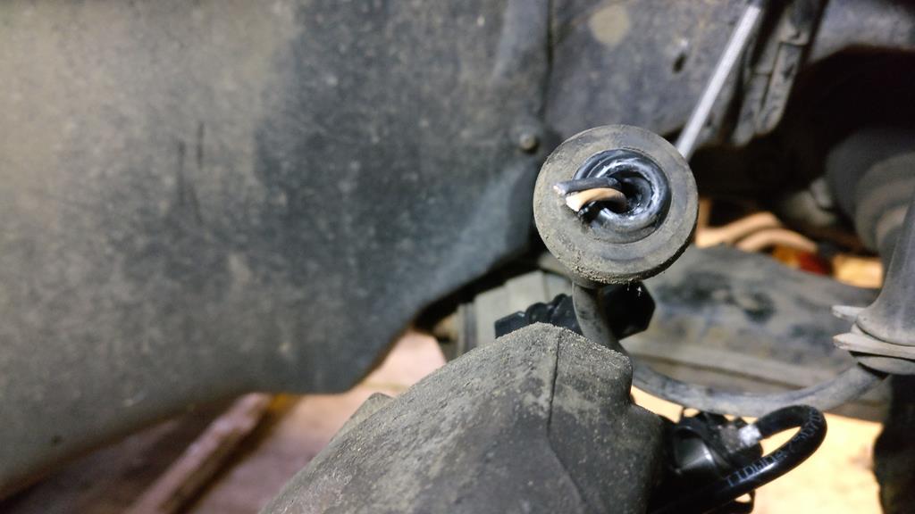

The missing rear caliper arrived at 14:30 and by 15:30 the brakes were finished off and bled, so on to the front pad wear sensor connectors. Start by cutting off the old connector
New boot on as the new connector is much smaller

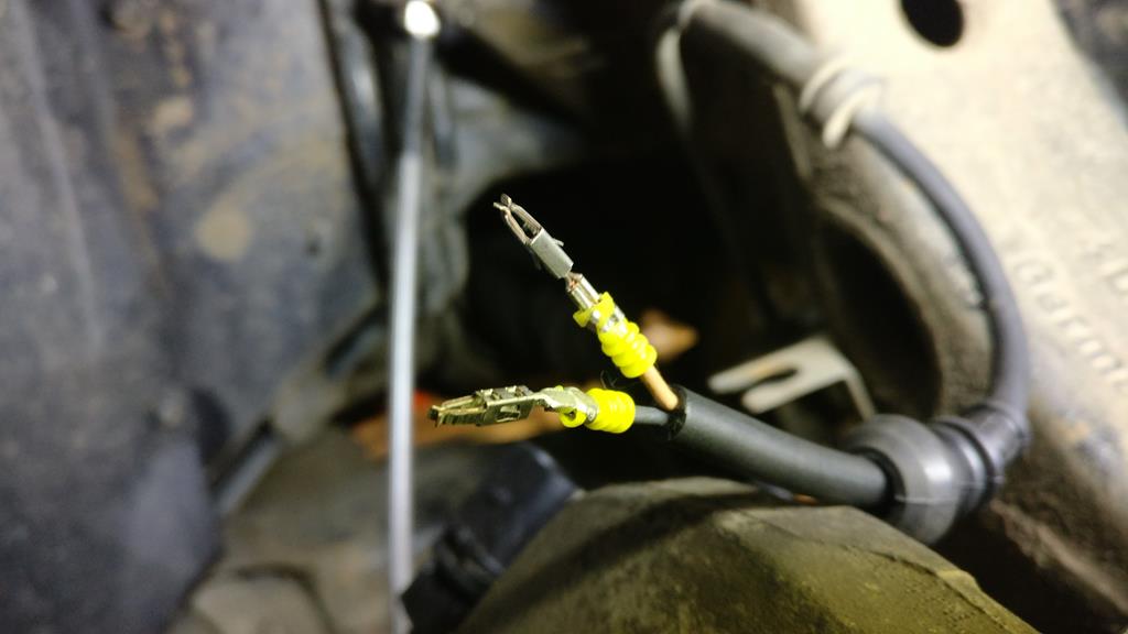

Terminals crimped on

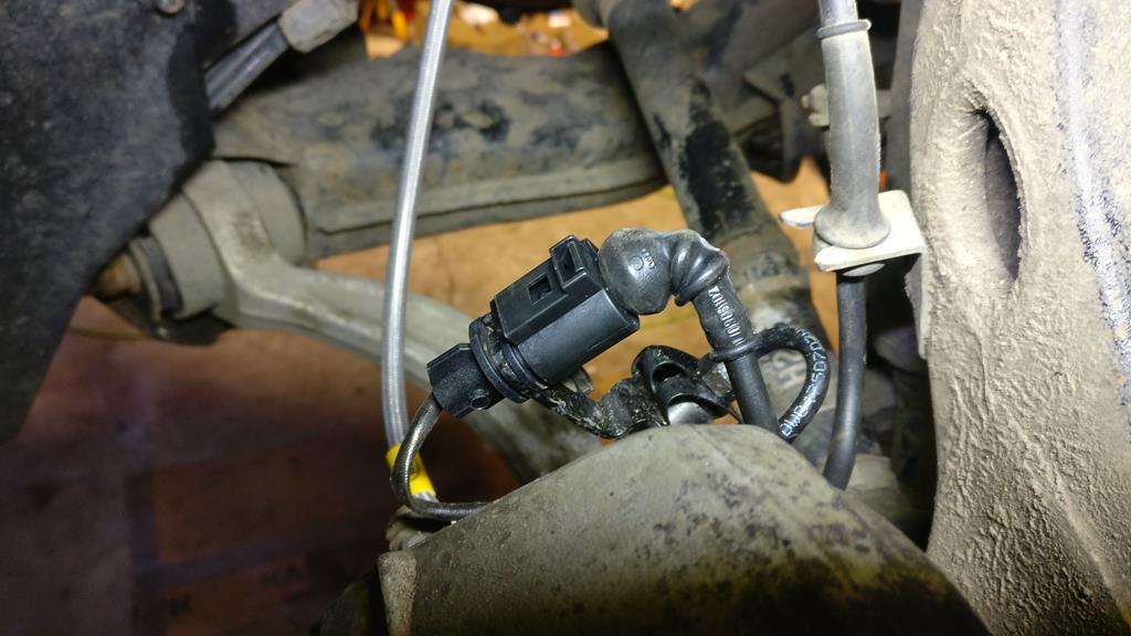

Assembled

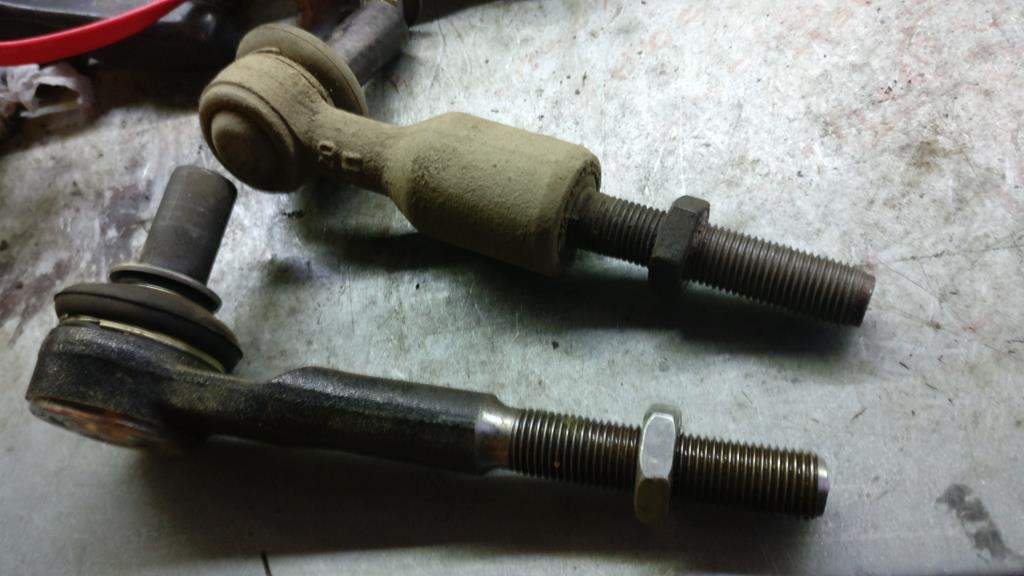

Since we're aiming to improve the handling, the D2 tie rod ends (top) with rubber insers were replaced with RS4 solid versions. This job is usually a day's work on most D2s, spent dealing with seized bolts and then having to replace the inner tie rod as the inner and outers are stuck together. Ten minutes a side on General Vod
