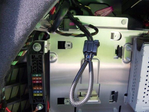

when updating the MMI 2G software/firmware, is it still a wise choice to use an optic loop on the DSP AMP to avoid component protection?

From memory, bose or b&o amps might go into component protection or even get bricked when upgraded, so best to unselect the amp 👍

I decided to use the optical loop on the DSP amp to avoid the component protection, hopefully.........

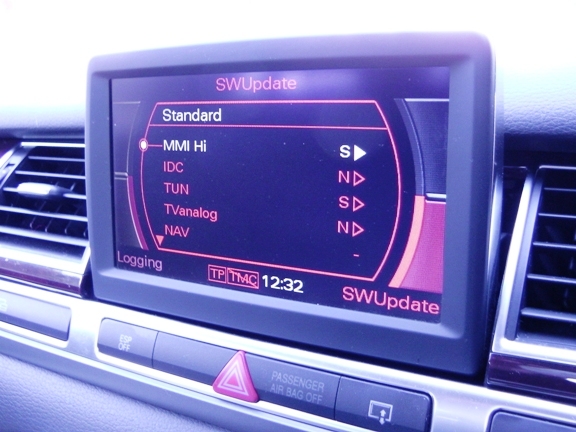

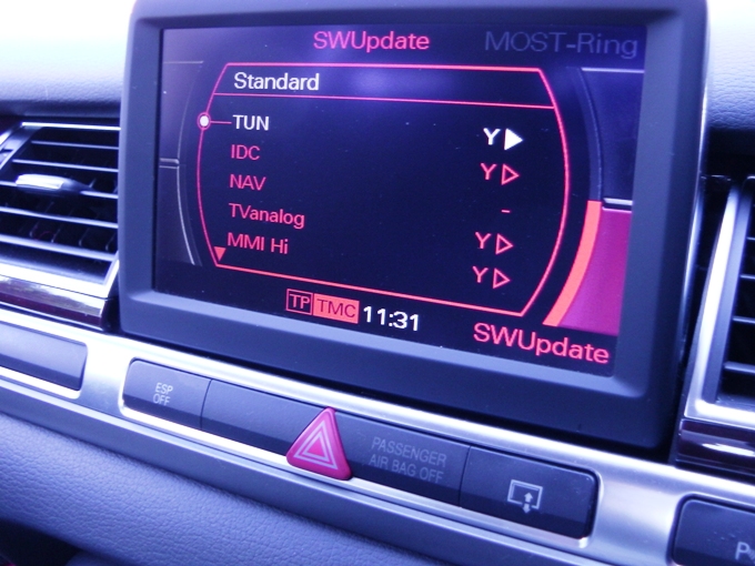

This was the update list..........
What's IDC?
Also, the Nav wasn't included in the update?
Maybe it'll be included in the later discs. No, not there either!

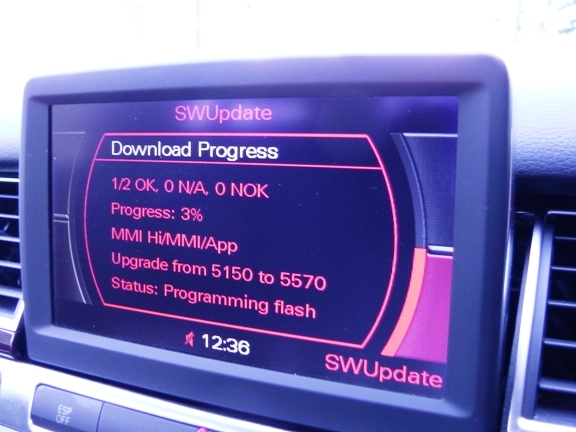

Anyway, that finished and I then ran 1 & 3 of the 3 disc set: 4L0 998 961.
Left number 2 out with not having the phone.
Not sure what the 'S' means?

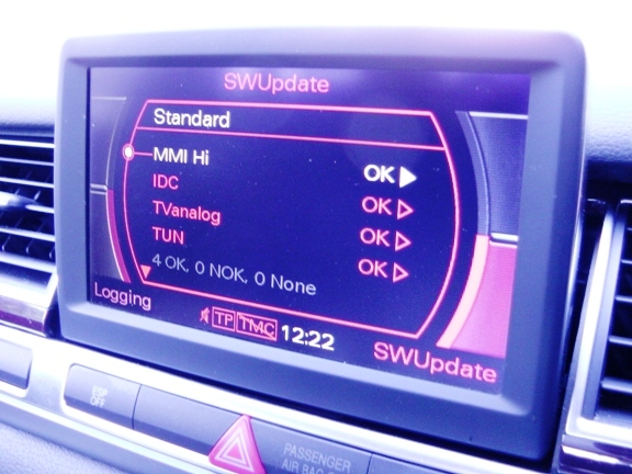

And this is what I ended up with............

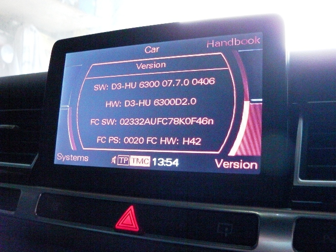

The SW 'VERSION' isn't on the bottom right of the MMI 'car' screen anymore, it's in the 'car' settings now, don't know why.
Took about 1 1/2 hours, but I was so relieved
The radio and speakers seem ok, so looks like the optical loop worked then!
Did a VCDS scan and there were some fault codes, but mainly for the loop when I took it out the DSP and put it back again. Also, fault codes for no sound, well there wouldn't be would there, with no amp showing, so just cleared them, and final scan showed they'd been rectified.

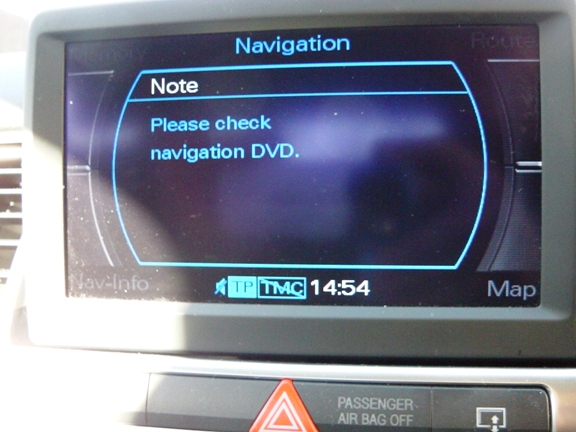

I had already bought a 2019 - 2020 map DVD:
https://www.satnavishop.co.uk/2018-2...disc-128-p.asp
I swapped it with the old 2004 DVD, but all I got was this........
So I put the old one back, which is working fine, though outdated.
Very pleased that the update to 5570 went well, but a bit miffed at the Nav bit.

My take on the nav is that the older drives seem to have a problem running newer nav upated discs for some reason which may possibly be due to wear or other issues with the nav unit laser. I had the same issue with my 2005 early FL D3 not liking newer nav updates either despite running the updated MMi software. I sent for a couple of chinese laser pickups for the maps drive and didnt get around to changing them yet ut was hoping that might solve the issues

Is the new disk by any chance a copy? I have memories of similar issues, I did replace a laser, it was a PITA but it worked.... for a while!

By Nav update, do you mean the maps? 2018 was the last official release so that one you linked will be 2018. There is a thread on here which had the maps on which you can download and burn a copy yourself. I did mine and it's still working over 2 years later. Possibly the old drive doesn't like it. I would send the disc back and get a refund. If you are stuck, I can burn you a copy and post it to you
Oh, right, I didn't know there was a problem with the nav player in these cars.
I just thought the MMI update would update the nav player so you could load a newer map DVD in it, but it's not even selected in the list.......just my way of thinking.
