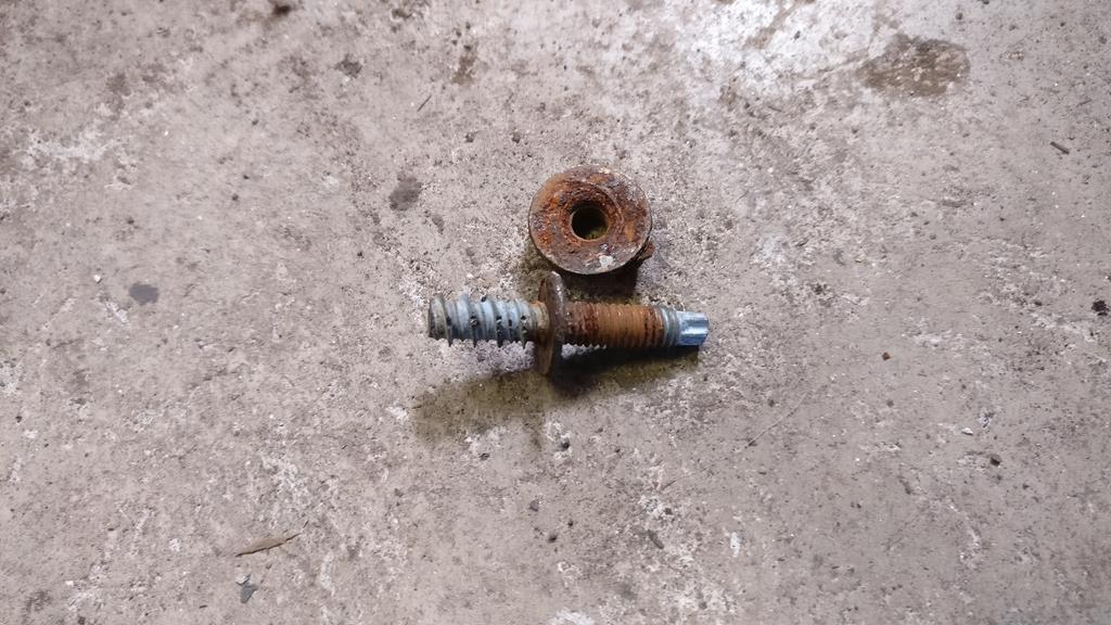

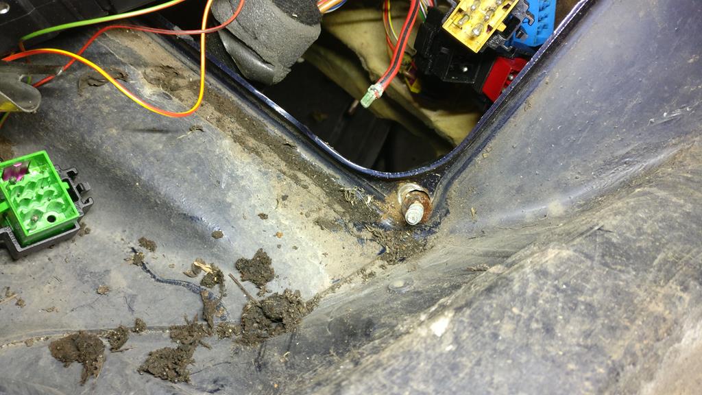

However, here's where the General remembered he's a D2, and since he's been a joy to work on all week decided that 2 hours before going home he would throw a spanner in the works He was quite damp inside when he arrived and so I suspected blocked drains - either scuttle or hvac, but there was no evidence of either. Alas when I lifted the passenger side carpet, the relay box cover was wet. My immediate thought was botang's hole, which has never been a problem on this one but thats the usual culprit for this.
On inspection, there was no evidence of the hole being exposed so I decided to remove the ECU box to get a better look, at which point I found the problem - one of the studs had come adrift from the plastic and was allowing water in at the base of the box.
The nut was rusted almost solid on to the stud from where it had been leaking. I suspect this may have been the problem right from the start, but I never noticed when I did the work on him originally.
The only other ECU box I could easily get to was in the murple so that was quickly retrieved and fitted, and all appears to be well again. I got everything back together with ten minutes to spare

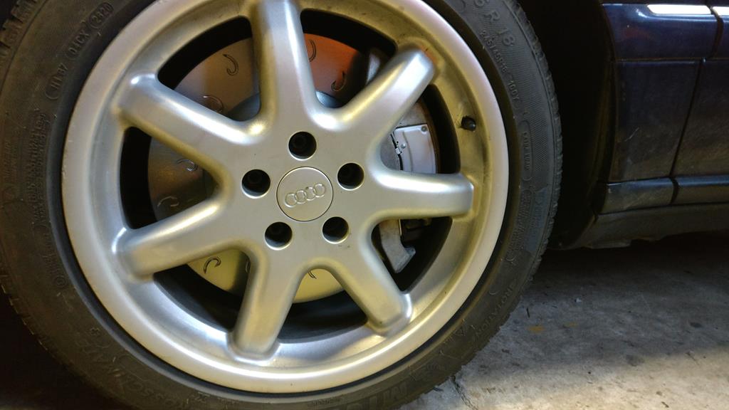

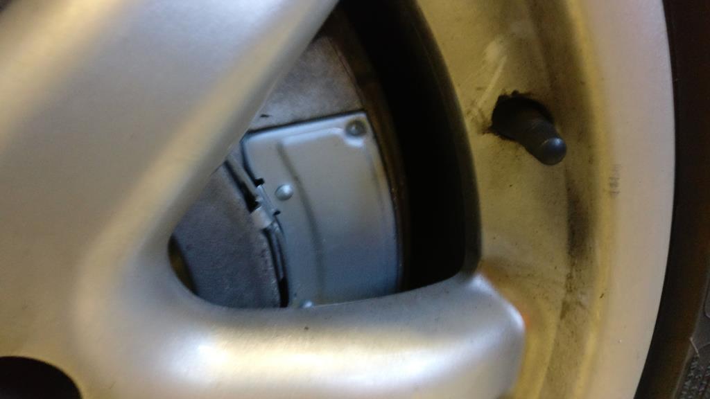

The brakes fit fine in 18s!
Plenty of room there, although its a good job he has spacers on otherwise it would have been a little tight on the spokes
The brakes feel pretty good but obviously haven't bedded in yet so once Bert has had a chance to use them properly I will report back on his thoughts
