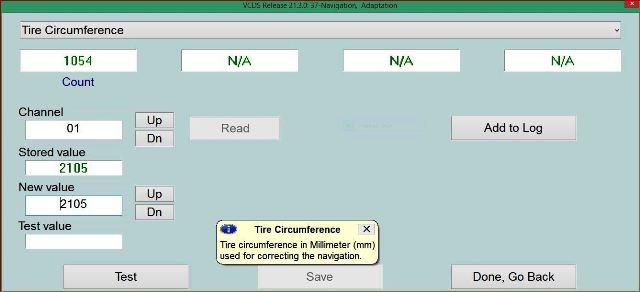

I then gave Matty's Nav module adaption a whirl:
Value that was already stored:
New value:
What do the different values of 2105 V 2140 mean concerning the wheel size?

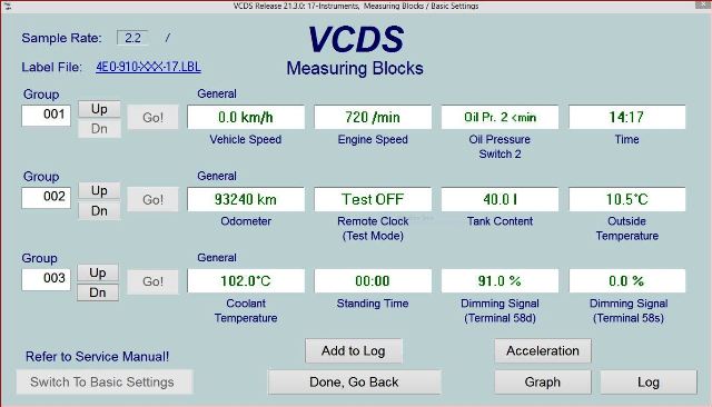

I don't think I have the digital speedo readout, so I used the km/h vehicle speed in VCDS - Instruments as I was driving:
When the speedo needle was (approx), dead on a certain speed, I had a VERY quick glance at the VCDS. This is what I observed:
1. Needle at 20mph - VCDS showing 30kmh.
2. Needle at 50mph - VCDS showing 77kmh.
3. Needle at 60mph - VCDS showing 92kmh.
4. Needle at 70mph - VCDS showing 109kmh.
ID:	25966   Click image for larger version
ID:	26013   Click image for larger version
