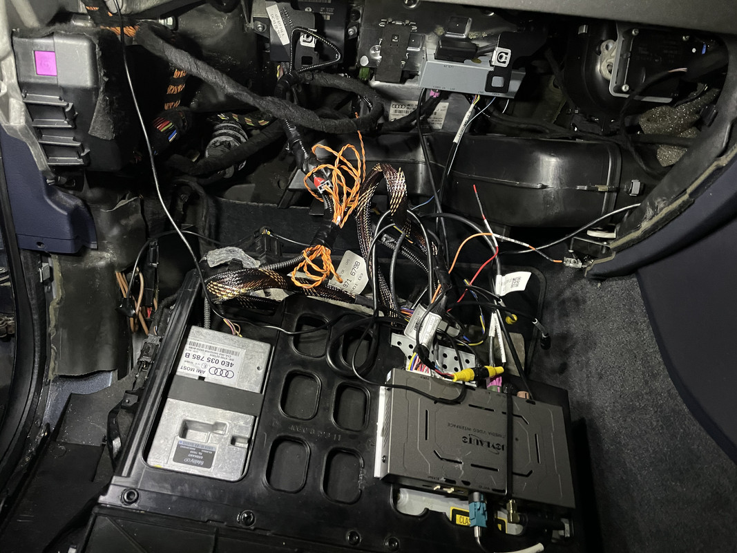

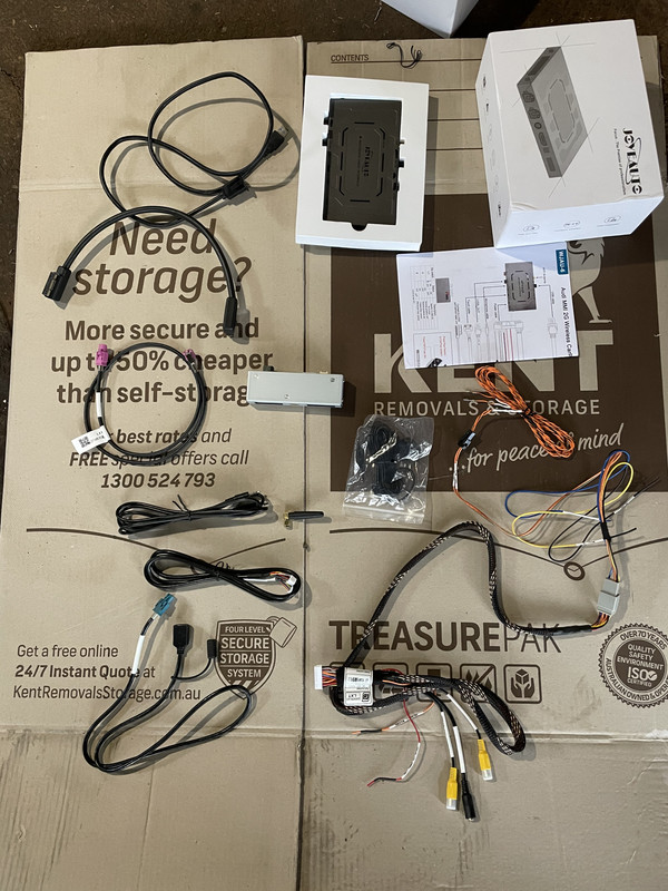

Finished install. The system uses the MMI controls to operate
Most of it lives behind the glovebox. This system also can support reverse camera and front camera.
I put the microphone into the roof Using the free position. It works really well.
I have installed a USB port for the apple CarPlay connection in the centre bin. This way I can free up the AMI and also keep the car tidy without cables all over the place.

Have you got any more details, link?
Sure.
https://www.joyeauto.com/wjau-6audi-...link-solution/
I was very impressed with the quality of the wiring from this kit.
Also, for the D3, you will need to attach CAN high and low wires to the Gateway (pin 6-high and 19-low) then you’ll need to attach one wire to 12v+, one earth, and one to the MMI (pin 16 on the MMI control head)
If you do not have aux in or AMI you’d have to chat to the company. I had aux in through the TV module

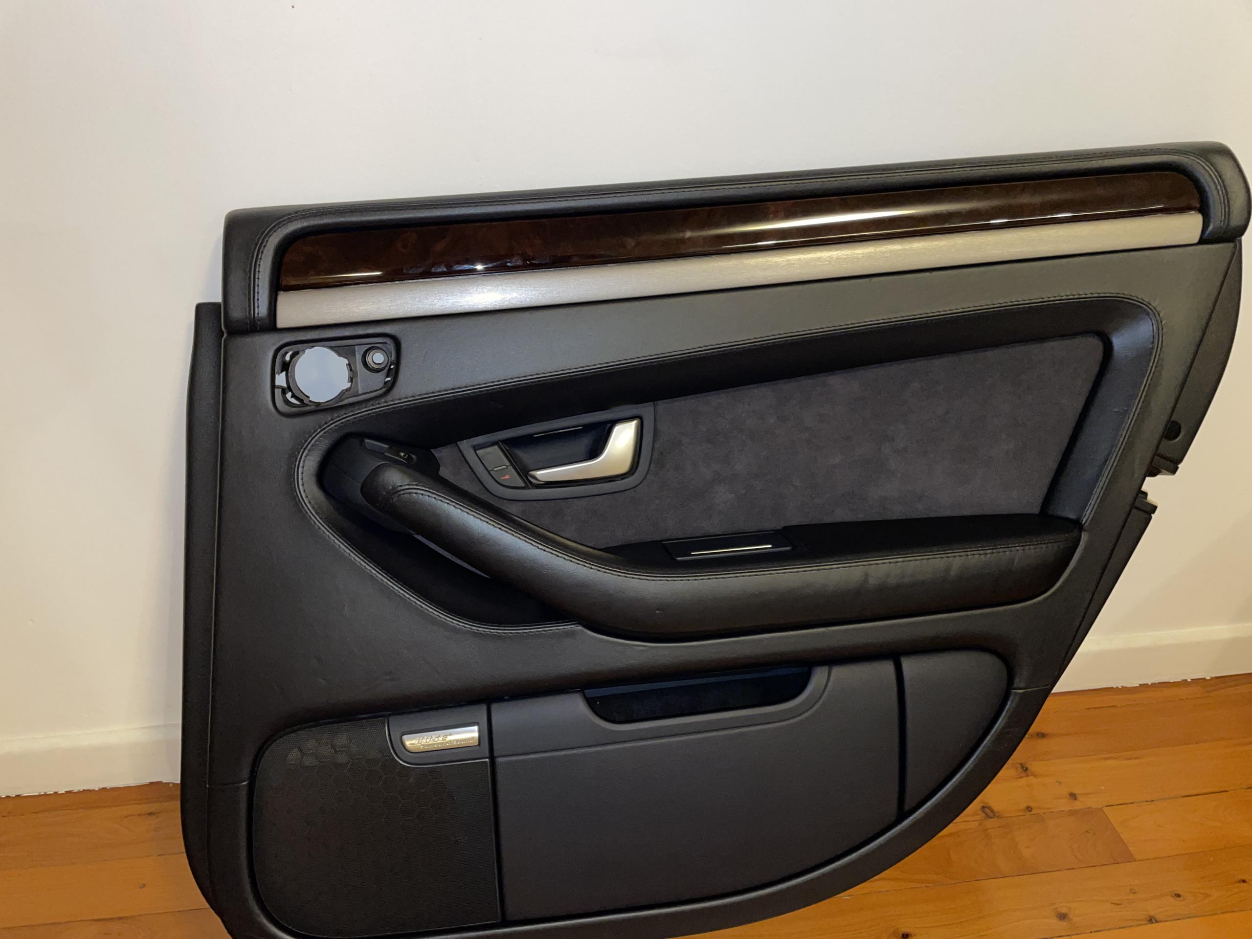

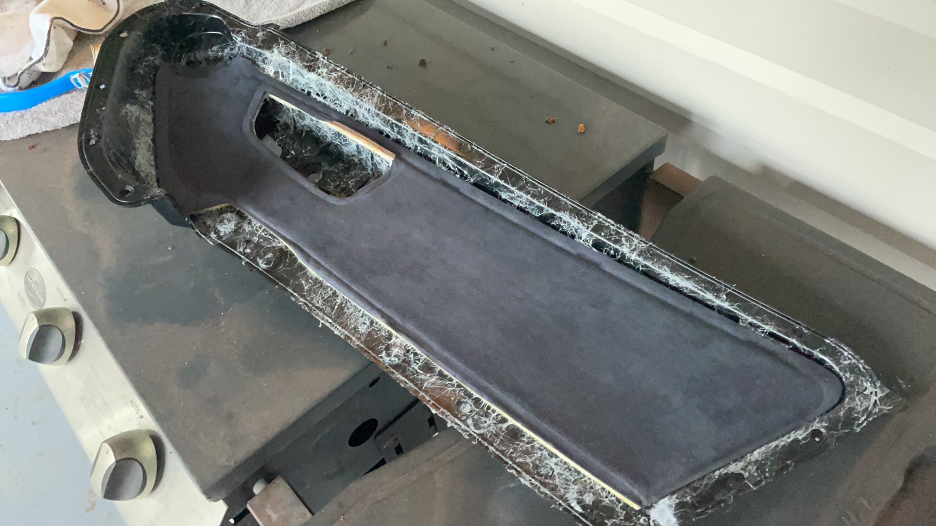

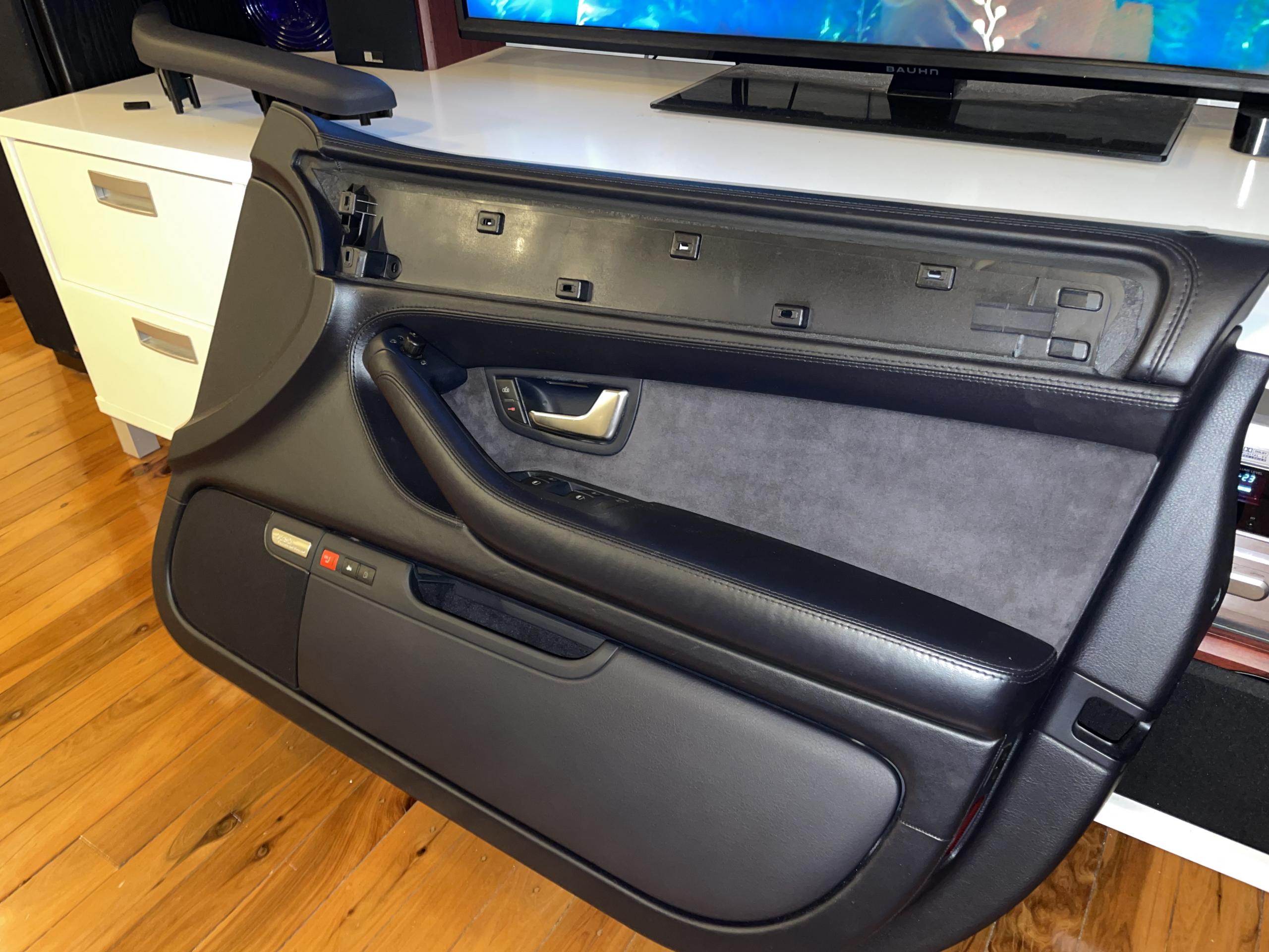

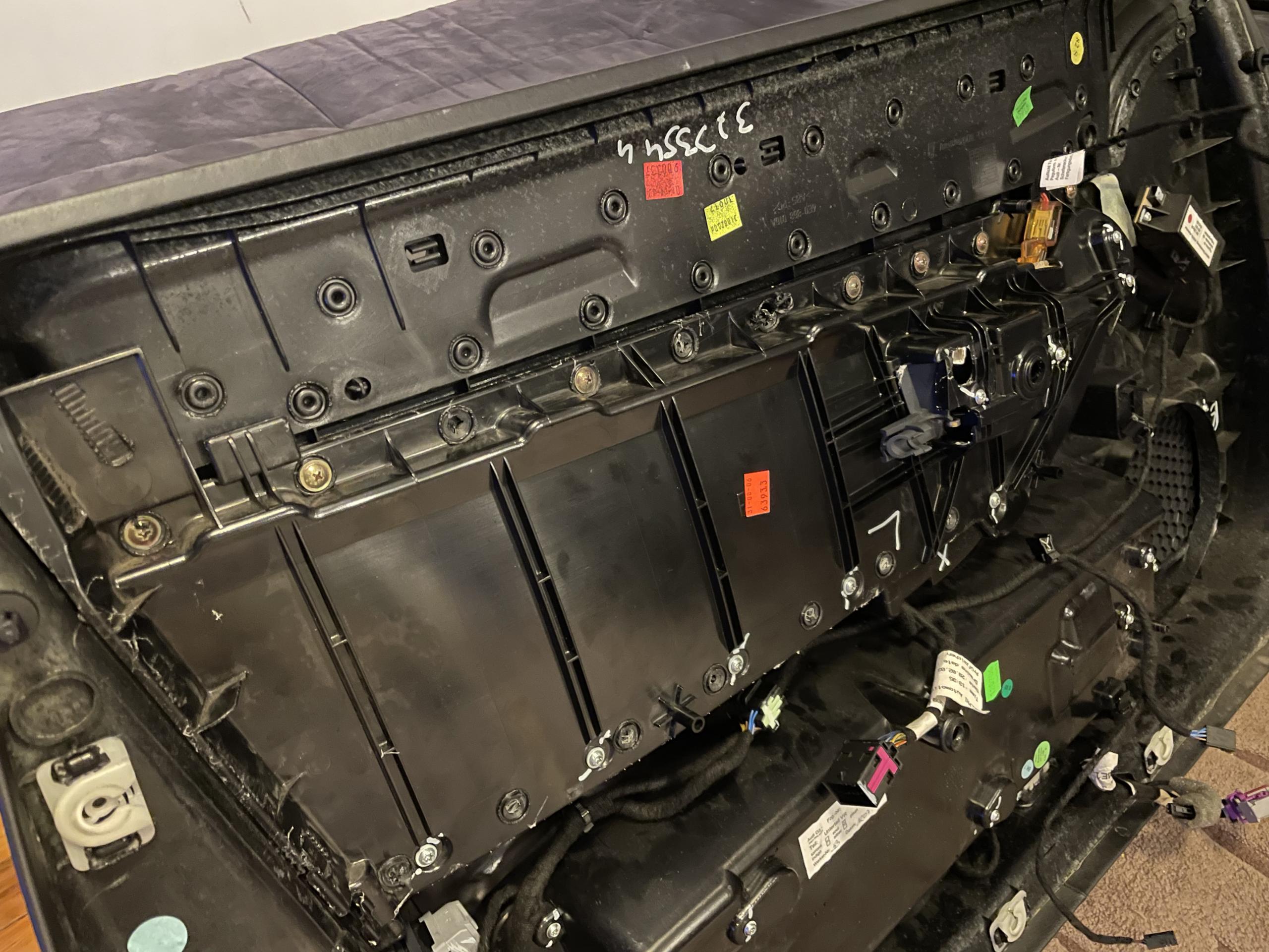

I have been chasing an extended leather interior for a number of years but my interior colour (indigo) is too rare and extended leather pack 3 wasn’t actually offered locally. I have only seen one car with leather pack 2 and 99% of them have no extended leather at all.
Happily, I got lucky and bought a set of trims from the US. It was extremely difficult to get them organised and posted due to many reasons and when they got here it seemed they were soul. Bugger.
So I had to go down the road of recolouring and retrimming them.
It is possible to remove the suede part of the trim, and remove all the pockets and such, but this does involve breaking the plastic rivets. It is also possible to use small screws to reattach everything, provided it isn’t properly broken (I drilled the plastic rivets out)
The colour match is quite successful, and now I have rear door blinds in addition to the leather pack
