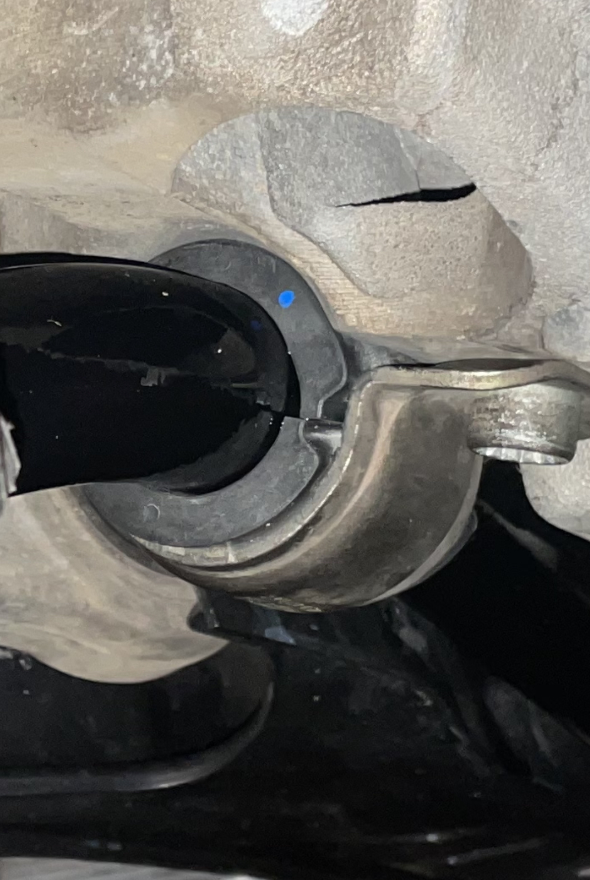

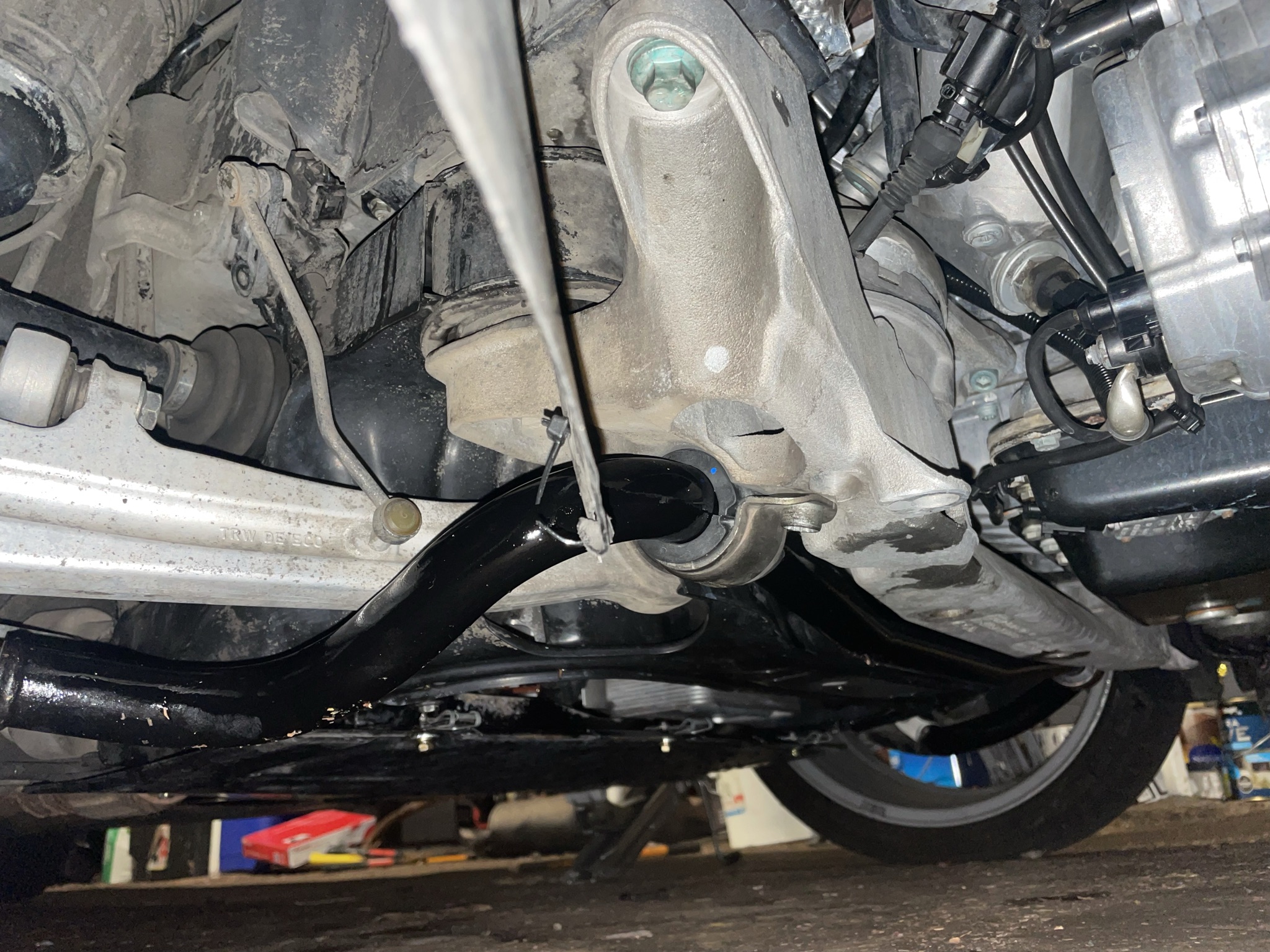

I have received the replacement sway bar, it is indeed the same Sport bar I had before. And the bushes seem to be just fine with it. There are no gaps etc when the brackets are done up.
The bushes fit the car perfectly.

I have used these.
I’m happy to get some for people and send them.
Mike
