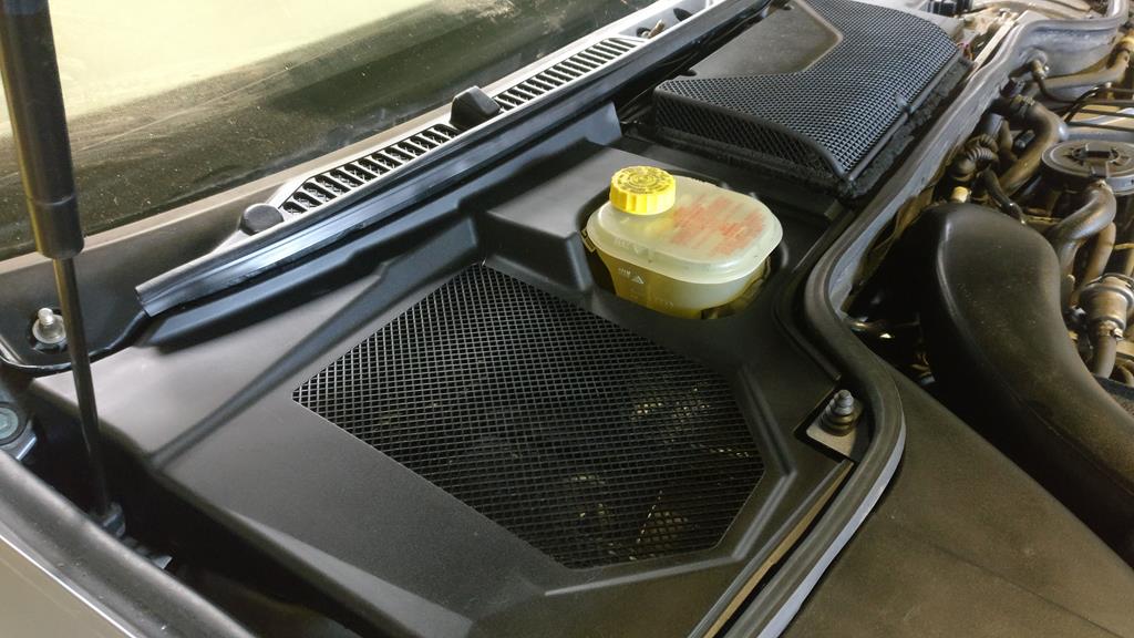

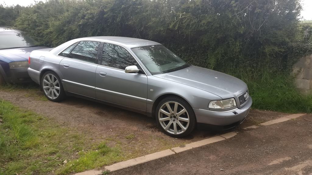

Last few bits this round from earlier in the week.
I replaced the wiper trim, and changed the brake fluid
The electronics box was a mess - connectors dangling and most of them broken, and one power wire just twisted together This was all tidied up and put back together properly and I replaced the missing and broken inserts and fitted new screws on the lid.
Back home on the driveway
The drive home went well - the engine is nice and quiet now, the gearbox shifts smoothly, and the suspension doesn't sound like its about to fall off! There's still a slight knock through the steering which may well be the rack so that needs a bit more investigation. Also the ESP is still in a grump with a whole pile of errors so that needs more work too.
Its now going to sit on the drive for a few weeks while the next project is in the workshop.

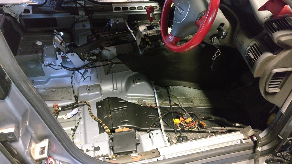

Old 19th June 2021, 08:21 PM
Barnfind back in the workshop now Mark's is done
Gave them both a bath

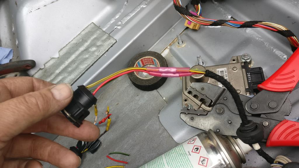

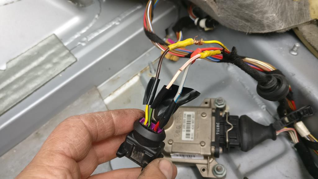

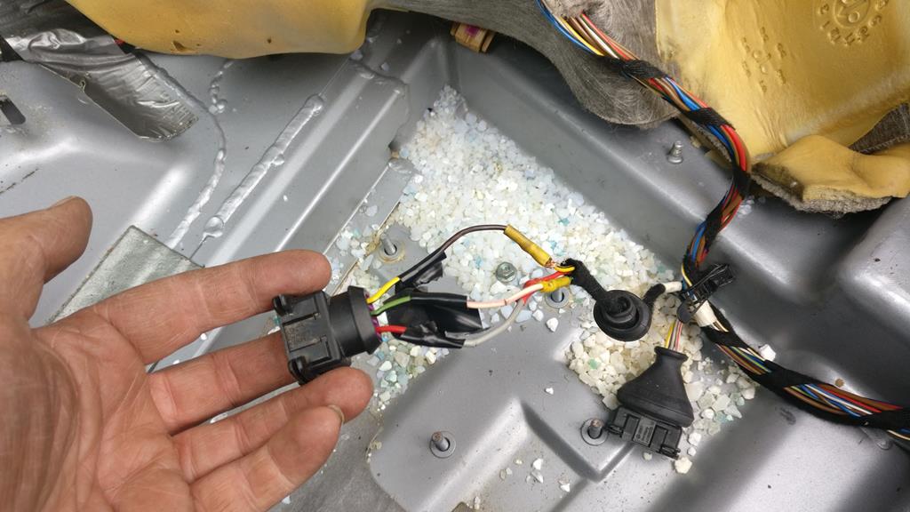

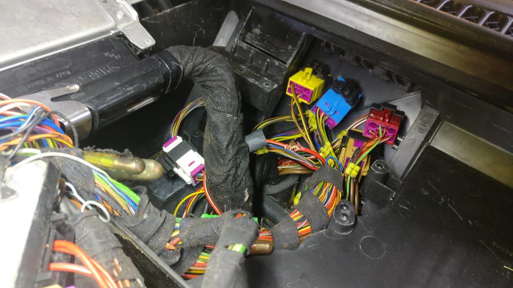

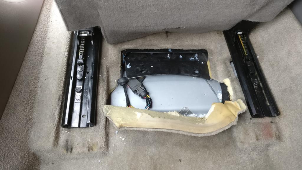

As I mentioned before, the ESP was in a grump reporting 'G200 lateral acceleration sensor implausible'. There was a broken sensor in the footwell, and a replacement with a Prestige stock number on it in the centre console so I thought I'd pop the passenger seat out and have a crack at that today.
I was slightly annoyed by what I found:
The carpet has been torn up to get to the sensor There's a 3rd broken sensor here, and some hacked up wiring
No idea what all the gravelly stuff is - its some sort of plastic crystals, possibly dessicant? I vacuumed all that up and got a closer look at the hacked wiring. I have no idea why this is all mangled since it seems to still have the original connector
I cut a good connector off a scrap harness and used heat-shrink crimps and Tesa tape to repair the harness, then fitted the Prestige sensor in place
Unfortunately, this wasn't actually the problem - even with two known-good sensors the fault remained, so I swapped the ESP ecu and the fault was gone It needed coding and the steering angle sensor calibrating, and now all the drivetrain modules are clear of codes except for the ecu reporting 'crash signal implausible' which I think is the airbag unit so I'll swap that tomorrow.
In the nearside passenger footwell on mine, the PO had cut a neat rectangular section out, presumably to suck out the water ingress. I never noticed it until pushing the carpet and the water squishing past. Not a great solution I guess but very convenient for getting to the water ingress without removing the whole interior.......

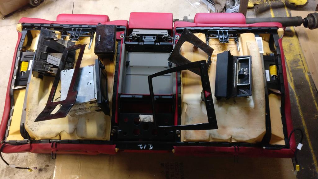

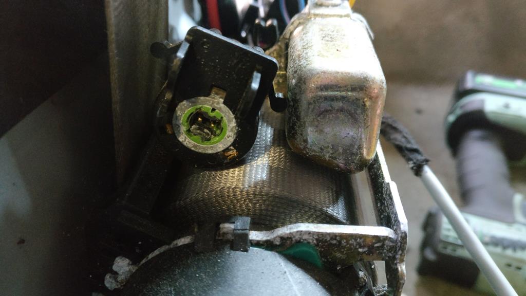

What appears to have happened with this is that someone took the passenger seat out and changed the sensor, which didn't help, so instead of taking it out a second time they just hacked it up, which obviously still didn't help.

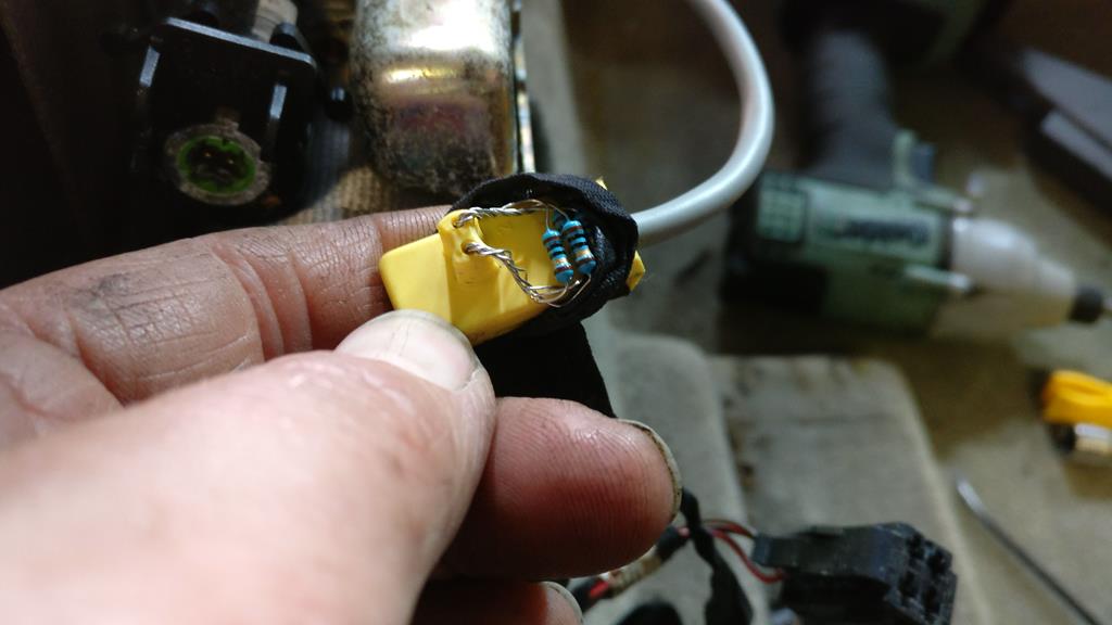

The ebay listing for this car claimed that it had been worked on by someone called 'Audi Doctor', which several people thought was me. Said Audi Doctor works more to the Harold Shipman standards of care than my 'OEM+' approach Witness this next heinous bodge:
Why is the driver's side belt tensioner not plugged in but not showing a fault code?
Oh, because someone has bypassed it with resistors

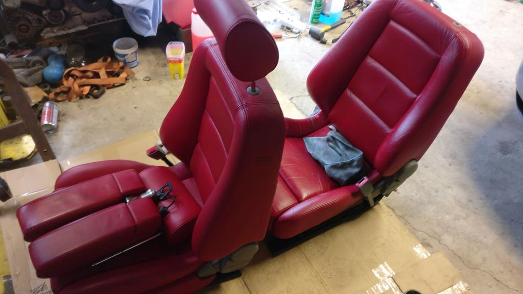

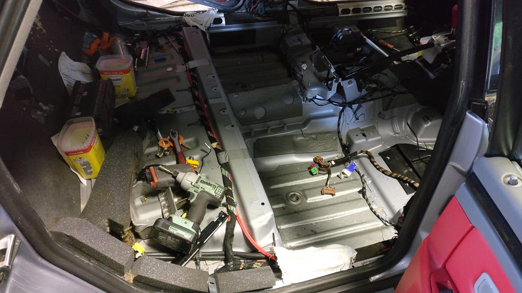

Mike came over today so we stripped the interior out. Quite a lot has to come out in order to get the airbag controller out, and then its fairly trivial to get the centre console out, at which point the carpet can be changed. Its so much easier to clean everything properly when its out of the car anyway.
All the wood trim will get polished while it's out
and all the leather cleaned up
Its been smoked in and smells quite bad so I've left the Aromatek running for a couple of hours to see if it helps. If not, I'll change the headlining.

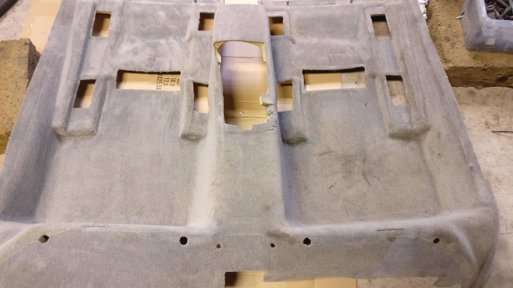

  #68

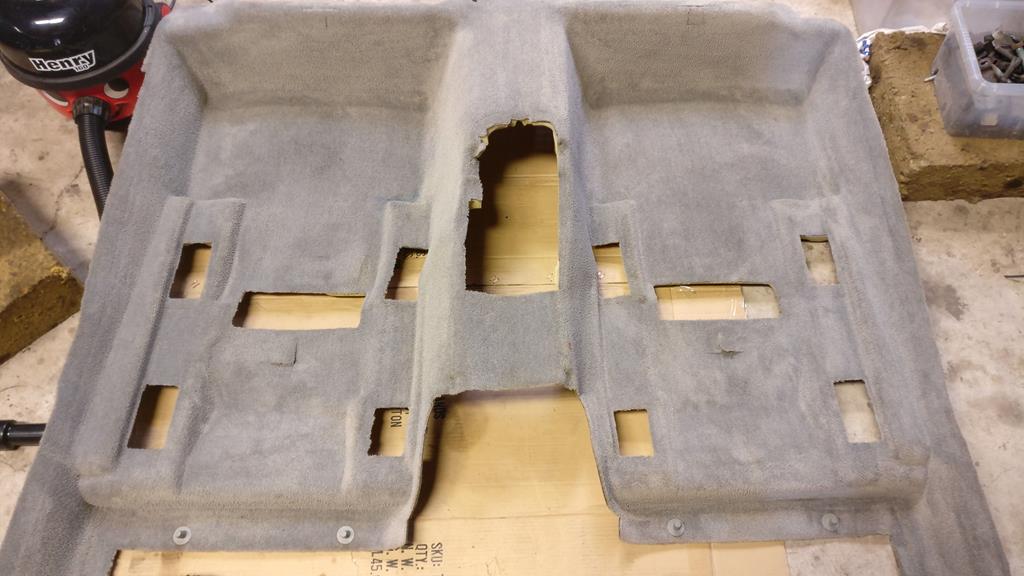

Old 21st June 2021, 08:08 PM
I cleaned up the replacement carpet tonight
Halfway through
All done. This can dry overnight and will go back in tomorrow.
I replaced the driver's seat belt reel with a good one and plugged it back in properly, and then replaced the airbag controller which solved the 'crash signal implausible' stored in the ECU. Implausible - crashed and not crashed at the same time? More likely it just got damp.
The replacement airbag controller is showing almost all the codes it knows about with the interior being missing, but its not showing a code for the driver's seat belt tensioner so thats good.

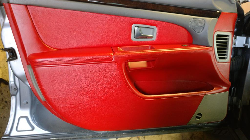

Old 26th June 2021, 08:29 PM

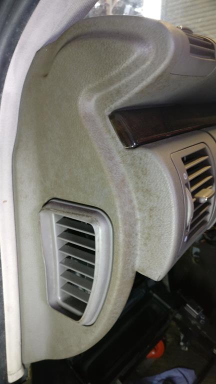

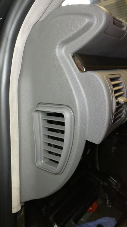

Deep cleaning the interior while the seats and carpets are out.
The ends of the dash are a little grim
Much nicer
The door cards clean up pretty well

Old 27th June 2021, 07:09 AM
Posts: 3,668
Impressive results on the dash end plastics What did you use to clean those with?
