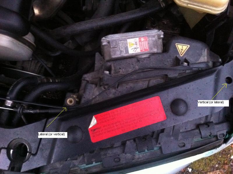

Certainly looks like factory Xenons.. Do you have the adjuster screws on the top?
I'm assuming that's one of the adjusters pictured here?

That's the fella... Just turn that and the light should go up or down (I think it's counter-clockwise to go up), do it with the lights on about 6-10ft from a wall and aim the misaligned one with the other one.

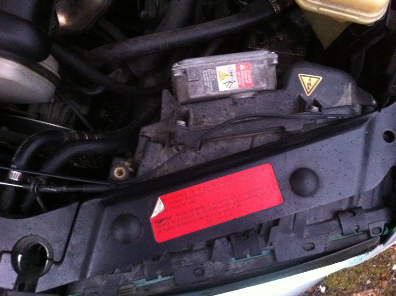

There are 2 adjusters. Just be carful as they are plastic cogs and you will snap something if you come up against the stops.
