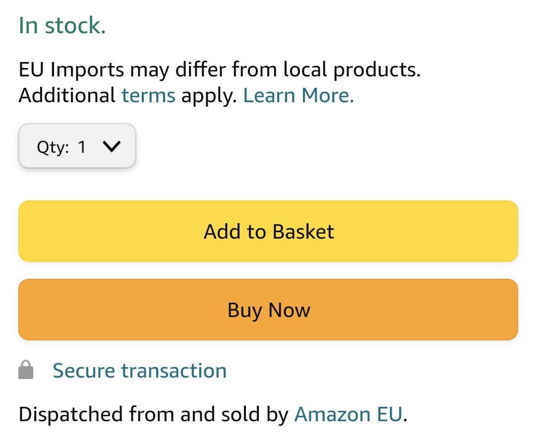

Be slightly wary, the seller isn't in the UK and now we are not in the EU extra charges may apply.....
That said, they might not also

I've not seen that happen with Amazon - I would assume they are registered for UK vat so its all covered, but also its well below the £135 import duty threshold
