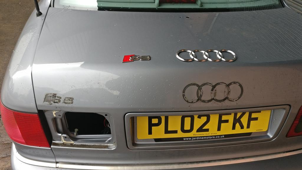

Removed the badges to make polishing the boot lid easier, and the rings were past their best so they needed replacing anyway. The antenna also came off as the grommet was ruined. I also took the left rear light out because it was leaking around the seal. I appear to have successfully solved that as it rained last night and the boot wasn't full of water this morning. More on that later once I'm sure it worked.

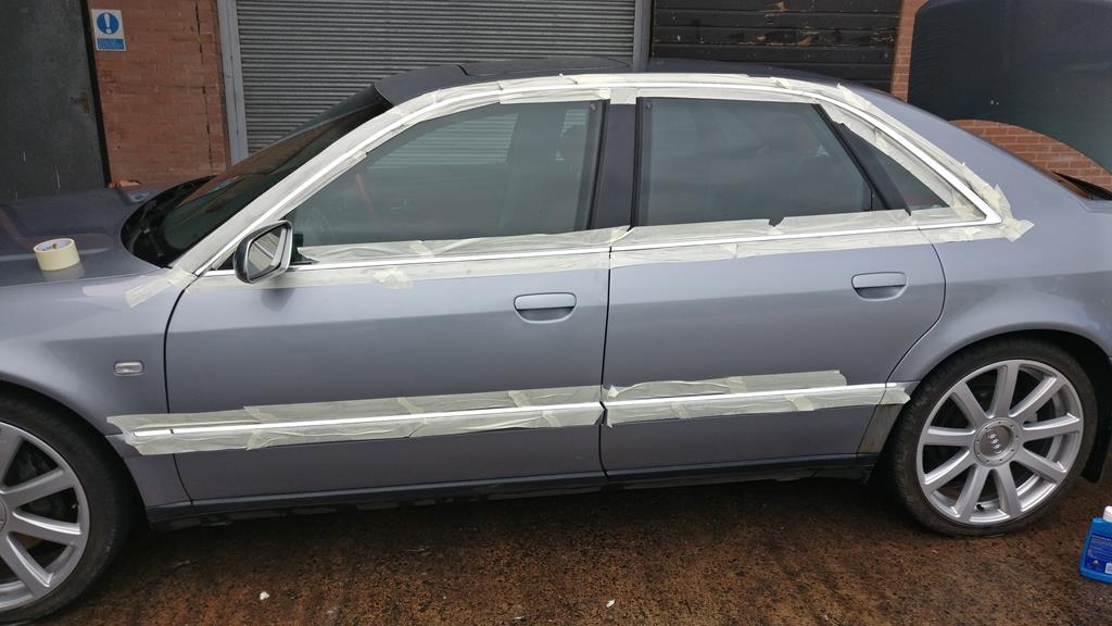

Taped off to do the rest of the brightwork. Some of it came back, some of it didn't, so I'll replace what's needed later on. It looks good enough for before and after pics of the paint restoration though.

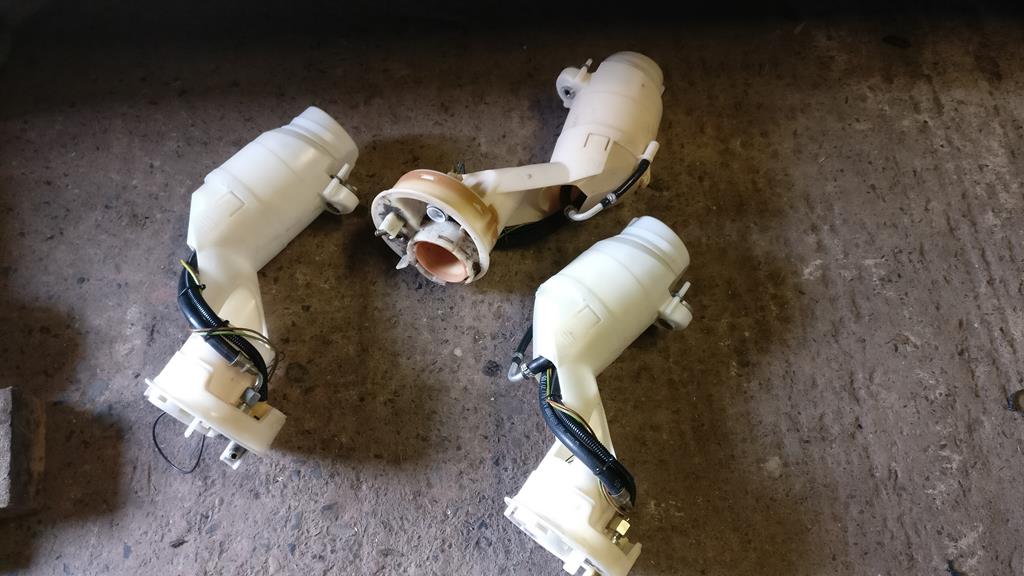

Saturday afternoon did not go well The VDO pump I fitted last week wasn't holding pressure when turned off so it made starting quite difficult. I pulled that out and fitted a Magnetti Marelli unit which Mike bought a while ago to experiment with. That lasted ten minutes until it cavitated itself to death and the engine misfired and stalled. At £25, most definitely too good to be true Finally, I put in a known-good original pump and at last it worked properly. I'll fit another new VDO pump before it goes to its new home so the next owner has peace of mind, making four pump swaps in total

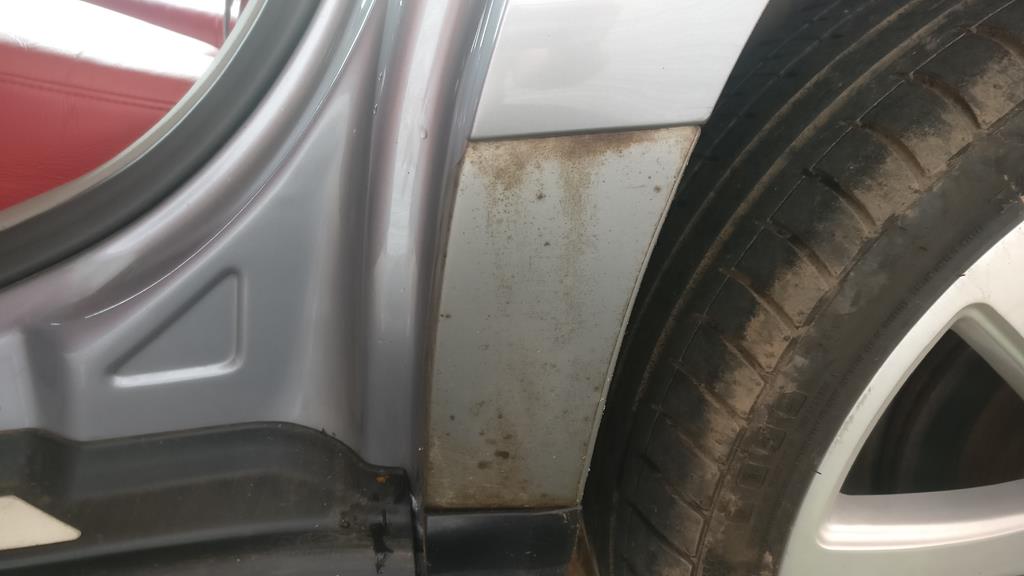

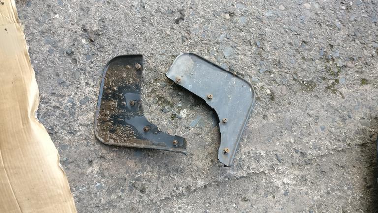

Sunday - pulled the last of the heinous mudflaps off

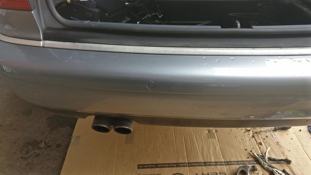

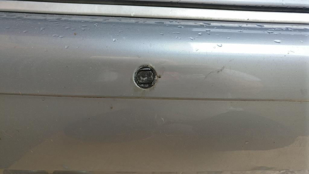

One of the parking sensors is not only unpainted, but superglued in to the bumper What sort of deranged thought process goes through the mind of someone to think this an acceptable repair? Not only did they glue the sensor in, but they dribbled glue all over the bumper so it looks a total mess
I was able to remove the superglue with acetone, since this is original 2k paint which was baked on so its quite resilient. The mid-right sensor was also faulty so two replacement sensors and brackets and it looks a million times better and now works properly again.

Old 23rd August 2021, 09:03 PM
More tape today
